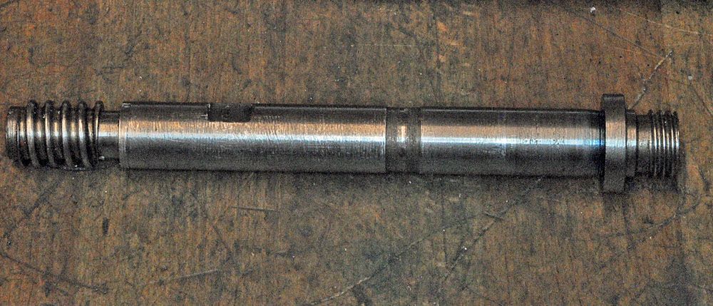

          In all the Flexispeed and Simat lathes I have seen there is no separate bearing. The spindle is un-hardened and bears directly in the cast iron of the head stock. It is usual for the spindle to have much more wear than the headstock.

                  It's a complex problem. Nominally "soft" bearing materials like white metal (Babbitt) work because there are harder crystals in a soft matrix. I imagine that Aluminium ALLOYS can offer a similar microstructure since the more advanced alloys are age hardened which means that by either time and/or heat treatment harder components are allowed to precipitate out into the aluminium matrix.
                  Here's the spindle of a Flexispeed lathe that I refurbished.
                  Galling and wear can be seen at the headstock end. With the aid of some blue and 1/2" silver steel I could not find any indication of wear in the headstock. One of the problems with buying these small lathes second hand is that they have often been used without a countershaft (as mine was). This means that they have spent much of their life running at considerably more than the recommended maximum speed of 1000rpm.
                  Rod

                          As originally built, the Flexispeed spindle runs directly in the cast iron of the headstock. That is unless someone has already done a modification and fitted separate bushes, always a possibility.
                          I don't think that the rate of oil flow through the bearings is a very good indicator of the degree of wear in the bearings. The bearings on the headstock of the Flexispeed are not a complete circle, being split for adjustment at the front. This discontinuity tends to wipe the oil film off and so increase the oil flow.
                          I would be more interested in how much measurable movement I could detect in the spindle. Tightening the adjusting screws can reduce the free movement, but it does alter the shape of the bore a little. Should not be a problem unless it really is badly worn.
                          The maintenance instructions state that given proper lubrication and run below 1000 rpm the bearings should have a long life. Having said that, The speeds on my machine with the pulleys supplied by Flexispeed, North Walsham, are approximately 1420, 815, 460, 355, 203, 115. Not quite in line with their own recommendations.
                          The instructions for adjusting the bearings are to tighten until a resistance is felt, then back off 1/8 of a turn. Then repeat for the other bearing.
                          I'm sorry that this does not really answer your original question, but I have added it just for information.
                          A photo of the headstock bearings might be interesting.
