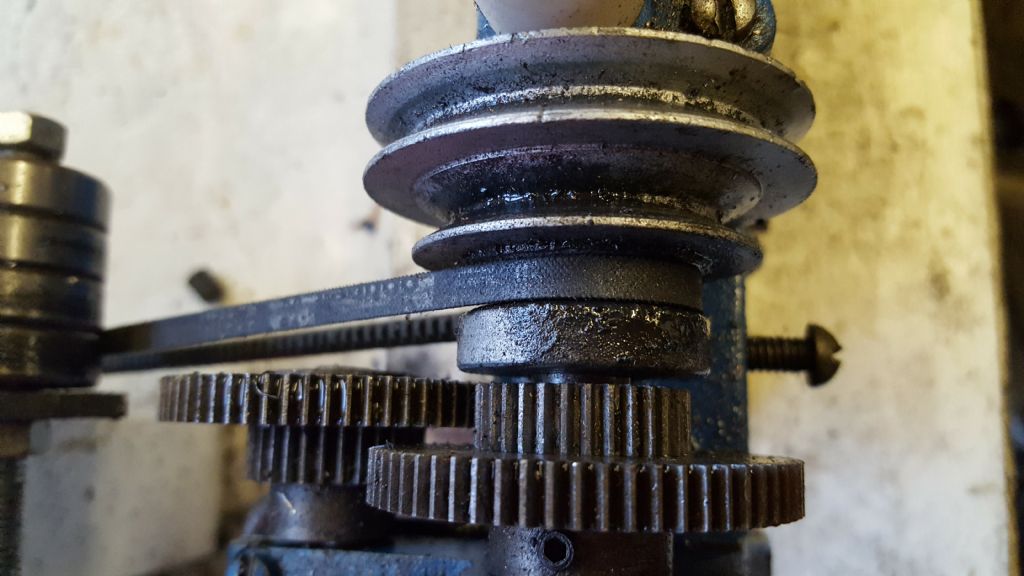

        Good morning.
        The belt on my Flexispeed slips very readily, despite being tensioned, clean and treated with a belt-grip spray. I have tried a 6mm V belt and different sizes of round poly-belt, both the smooth and rough varieties.
        I was wondering what size and type of belt others with a Flexispeed lathe are using and whether theirs slip easily as well.

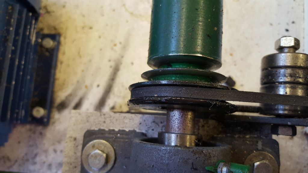

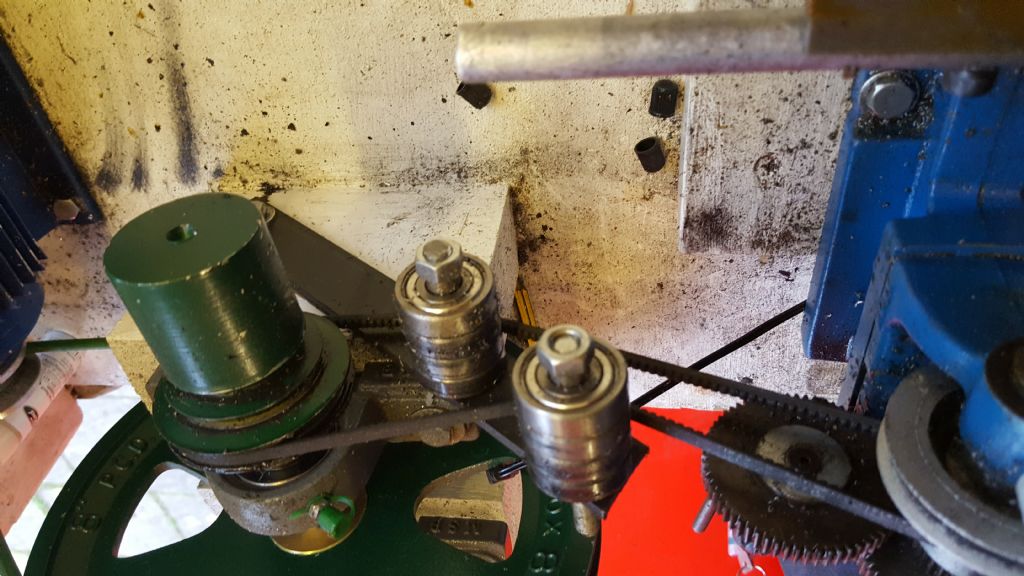

              #289052
              James A
                @jamesalford67616
                Thank you for all of the replies, which will be a great help.
                Rod: that is the type of belt that I am using, but mine is only 6mm. I shall buy a wider one to try.
                You can see my rather convoluted tensioner and belt routing in the attached pictures. I need to move the lathe, so shall re-position the shafts so that the belt has a more natural route. You can also see that the belt sits quite well down in the pulley groove, so there is definitely room for a larger one: 8mm or perhaps even 10mm, nearing the original size that Neil mentioned.
                Ignore the wire running through one of the pulleys: the machine is not in use at the moment as I am working on a different project.
                Regards,
                James.
                #370738
                James A
                  @jamesalford67616
                  I finally got around to fitting the 8mm belt that I bought a while ago and used the lathe for the first time in ages the other evening. The difference was quite remarkable, with not a hint of slipping, even when parting off.
                  It seems to have made the machine much less frustrating to use than before when the belt would slip with the slightest provocation.
                  Regards,
                  James.
