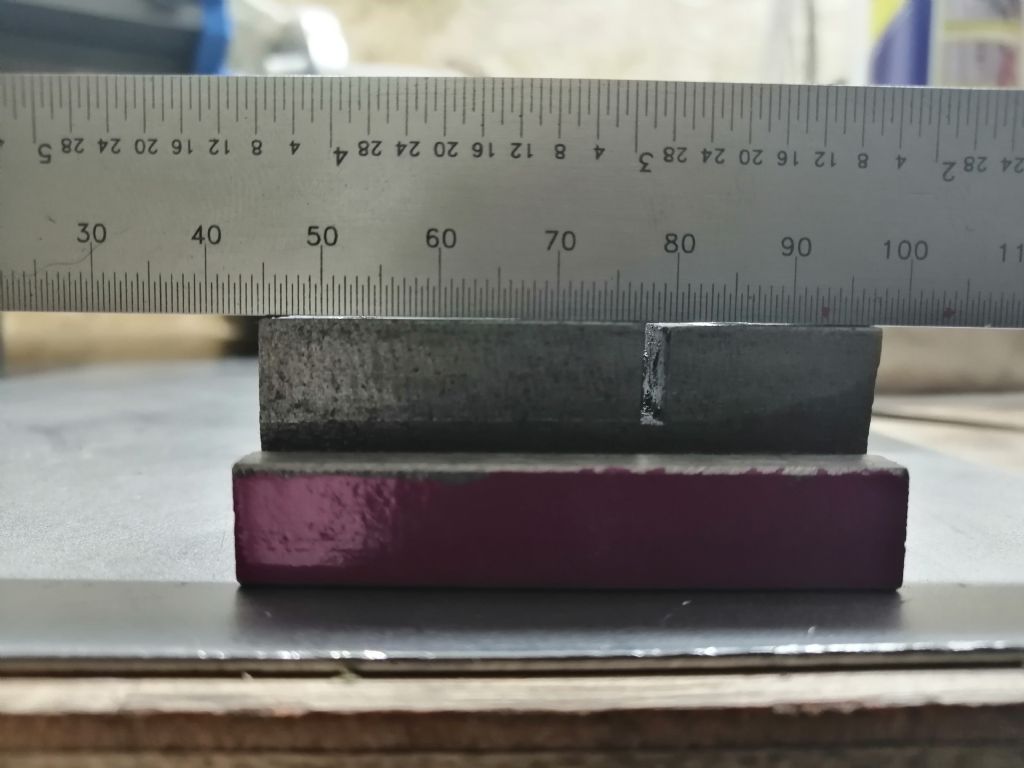

      This lathe is new with very few chip mileage on it.
      I had noticed some play in the saddle, a slight lift, and set to looking for the problem. The gib was set ok so next I checked the fixed clamps. Oh, there's the problem.
      I could slide a .01mm feeler gauge between the way and the clamp. Not sure what its proper name is. A .015mm gauge would not fit.
      So removed the offending part and found this very nicely finished NOT !!
      Tried to get a good picture. As you can see the surface that bolts to the saddle is not exactly flat. Probably not parallel either.
      So my plan is to mill the surface to reduce the gap and hopefully improve the flatness, which should remove the play.
      What do you guys think ?

          Is there a saddle clamp? If so make sure you don't remove too much material. If you remove the wiper, is there still play?

            You cannot remove all clearance, or things will be immovable. There must be some clearance, even if only 0.025 mm to allow movement.
            You are starting to fettle a hobby machine to improve the quality that you have bought.
            Hobby machines are designed and manufactured to a low cost and affordable price..
            They will not produce, certainly long term, to the leval of precision and longevity of an industrial machine. You will not be working the machine for 40 or more hours a week, week in and week out, close to its limits, that an industrial machine is made and expected to withstand.
            Quality takes time to produce and control, which is why industrial quality machines are so much more costly.
            By all means fine tune the machine, Lots of us make / add improvements. (The number of modifications made to machines make this obvious ), but keep a sense of proportion.

                  On a prismatic bed side-play and accuracy depend on the upper rail (or rails). The saddle slides on the rails and is unlikely to lift in normal operation because the cutting forces go down through the saddle and into the bed. Thus the clamps underneath needn't be anything special in terms of fit.
                  There are a few jobs, like parting off with an upside down tool in a rear tool post, and milling in the lathe, that might lift the saddle. What are you doing when the saddle lifts? There might be another way of doing the job.
                  Prismatic beds were controversial when they first appeared. Flat bed owners thought they were inferior. Nonetheless modern lathes seem more likely to be made with prismatic beds than flat ones. Ages ago I think MichaelG linked a document that explained the pros and cons, but I can't remember what it said.

                      That is about the right amount of clearance for there. Much less and it will tend to bind. As SOD pointed out, the block is essentially a lift plate that comes into play only if using an inverted parting tool, or a boring bar sticking way out in front of the saddle, or the top slide extended far foward thus causing the saddle to tilt. If you do machine any off that block, you will have to add shims to get some clearance back again. Journeyman's linked page has some good info and ideas on it re that block.

                            JB’s seems OK with about ten times the clearance you have measured. If that means anything, it means that the clearance is not particularly important.

                                If that's the saddle lock I'd leave it as it is, but I would ask for some new wiper felts as those do not look like they will wipe anything.

                                    Depending on the wear, you might get down to 0.05" at the left end and still not be too tight at the far end. That is nothing to worry too much about. The Smart & Brown model A that I use at the museum has to have at least 0.6mm at the left end to have any chance of reaching the right end without jamming.

                                      I reduced the saddle play by milling the "press boards" on both my lathes. The play left will be about 0.01 mm or less.
                                      On the small lathe, I also added 2 spring loaded ball bearings. They pull the saddle on the bed if the load is not to heavy. If the load is to heavy, the old "press board" takes over.
                                      If the bed is worn, you need more play but the bearings still pulls the saddle on the bed.
                                      These changes improves the repeatability/accuracy, especially when doing shallow cuts.
                                      Also the yearly maintenance takes a few hours less because the play doesn't need to be adjusted any more.

                                              The 0.1 to 0.15 mm gap is not the issue. There will be more problems than that underside block. You will be better off to take it apart and see how the saddle fits to the Vee way. Then correct that if needed. The rear bearing block is the one most likely to be experiencing any lifting, especially of rear tool posts are added. While taking the saddle off the machine, look at and clean out any of the oil lube drillings etc of swarf etc. Check and deburr things that need it. Some edges should be left sharp to act as a scraper , where a chamfer or radius will allow junk to work it's way in between the surfaces. Cleaning out the factory swarf or grindings is the biggest advantage of stripping down the hobby end of machine tools.

                                                  Now my mistake was with that pesky decimal. That should have been 0.1, which to me is certainly not acceptable. The 0.01 I mistakenly posted, however is. The other clamp is about 0.01. Yes I know there must be a gap but only enough for a sliding fit. 0.1 is a sloppy fit.
                                                  I only felt the need to check the gap because there was play between the saddle and the ways.
                                                  Yep it does look Journymans lathe, and I like his idea about separating the lock from the clamp.
