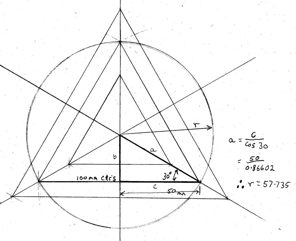

            This is the way I do it. The chuck will be held concentric to the backplate by the register you turn on it so make this as accurate as possible. You will need to measure the diameter of the fixing screws and the diameter of the backplate you have made. This may be exactly the same as the chuck already or you may have made it slightly larger for turning off later when the chuck has been fitted so take this into account. With a caliper measure the distance from the side of the chuck to the outside of a fixing hole and add to it half the diameter of the fixing screw and then double the result. Subtract this result from the diameter of the chuck and you have the PCD of the fixing holes. You can then measure from the edge of the backplate, make a mark and from this mark scribe a circle with a sharp pointed tool the PCD of the fixing holes by pulling the lathe round by hand. You can then scribe a horizontal line through this PCD, index the lathe round one third and again one third if it is convenient on your machine. It is on a Super7 or 7R with the 60t bull wheel, or you will have to remove the backplate to a rotary table or other indexing device for marking. You have a little leeway with the size of the fixing holes when drilling because the backplate register will hold the chuck concentric to the lathe axis.

              I’d stick 2 bolts into the chuck, measure the distance across them and deduct 1 diameter. Put that number into an online PCD calculator and then drill the backplate to the PCD. That can be done in a number of ways depending what you have to hand. Clearance holes are usually quite generous so you could be 0.1mm off and it would still fit OK as the register is doing the accuracy bit.

                  Trig solution0001
                  Than after turning the register, stick a dead centre into your headstock, mark a PCD with a suitable tool in the tool-post, and set it to the radius from the dead centre. Drill the holes with a suitable clearance size.
