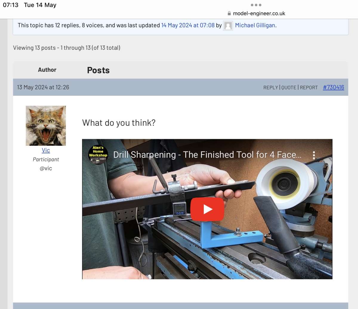

  • #730416
    Vic
      @vic
      What do you think?

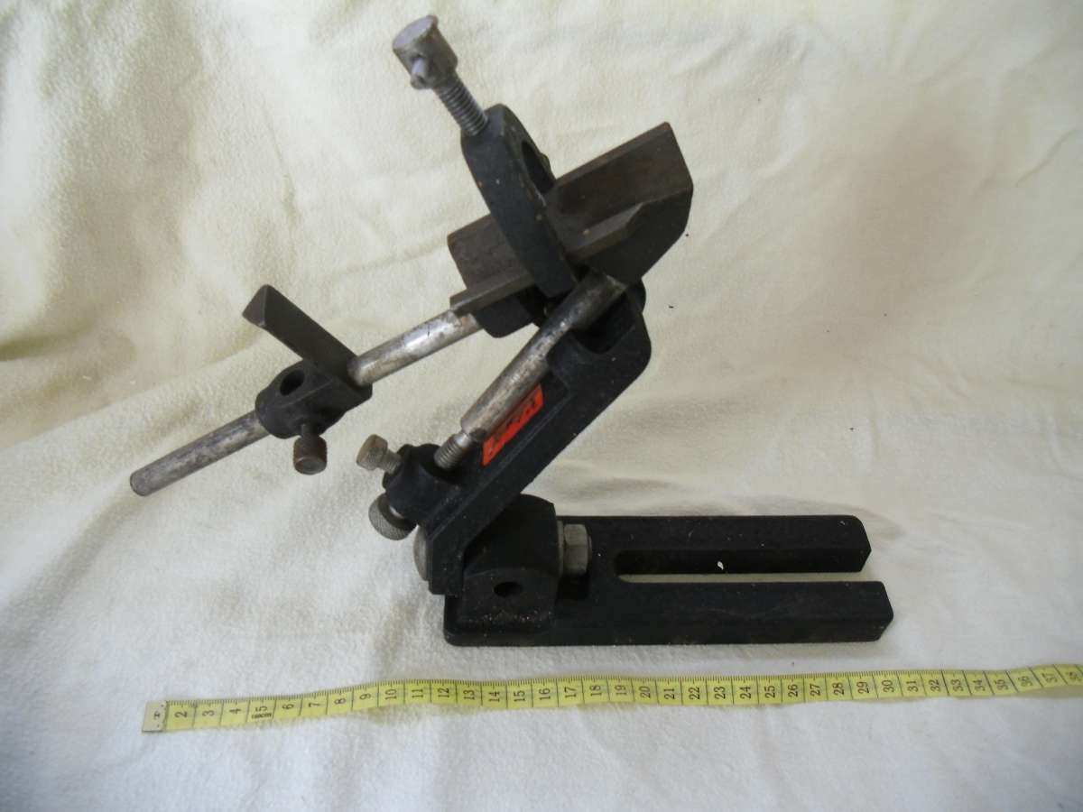

        Chris Crew
          @chriscrew66644
          Give me a Reliant drill grinding jig any day of the week. It’s a pity they are no longer manufactured and that our Asian cousins have not seen fit to reproduce them, although they do make the inferior Picador type.

                    Vic
                      @vic
                      On bernard towers Said:
                      About what Vic?
                      If you reload the page a few times you should see I posted a link to a YouTube Video.
                      It’s some kind of software glitch.

                        Chris Crew
                          @chriscrew66644
                          All I can say from experience is that the Reliance produces drill bits that actually cut and the backing-off of the cutting edge can be automatically increased or decreased simply by varying the amount of overhang from the end of the jig which is set by eye. This is because the drill is held at an angle to the grinding wheel and has imparted to it an eccentric rolling motion as the grinding takes place. This is not the case with the Picador type which simply strokes the cutting edge across the wheel and if the rear thumb-wheel is not rotated to advance the bit during grinding there is no backing-off of the cutting edge and the drill will not cut. You need to mark the thumb-wheel on the Picador so it can be returned to its original position for grinding the other edge. It is possible to sharpen bits with a Picador but its very ‘fiddly’ and it takes a little practice to co-ordinate the stroke with the turning of the thumb-wheel. The Reliance is a crudely made device which probably won’t suit those who work to NPL standards but for normal people it provides a quick and easy way of producing a drill bit that will cut first time, every time.
                          You can see the off-set angle to the axis on this larger No.2 jig and how the bit is rotated on this axis rather than stroked across the wheel, the rolling motion of which automatically generates the backed-off cutting edge.

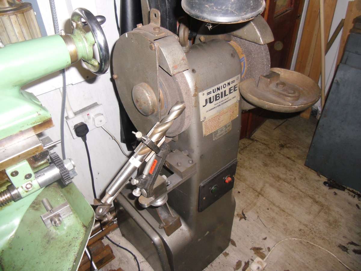

                                        Try a forum search, there’s lots on here about drill sharpening, some of it by me, so a proportion of the info might be dubious. 🙂
                                        Struggling to type at the moment, as I had a cataract done yesterday, so brief comments only.
                                        Reliance works well with practice; I have sizes 1 & 2
                                        Genuine Picador works OK straight from the box, supposed clones mostly use a slightly different geometry and may need modification to get reliable results. Seek out articles by Mr Meek
                                        Hemmingway is a Potts design and should work OK, but personally I struggle to get mine just right. I bought it second hand, and I’m not sure the flute location detent has been made correctly; I’m struggling for a proper diagram for it.
                                        Look up Harold Hall’s website for lots of useful stuff.
                                        Axminster do a useful grinding wheel, which should fit a standard 6″ grinder, wider at the periphery, but with a recess towards the centre, so it fits a normal length spindle; it may not be their recommended use, but the speed rating is OK, it works for me, and is thick enough to allow for dressing.
                                        It should allow access to the side of the wheel for grinding, without worrying about thinning it too much.
                                        References in my previous posts.
                                        Personally I’m set up to use one of those wheels on the Clarkson, with another ready for the Herbert, when I get round to making a wider guard; either of those will allow the feed in, without needing to adjust depth of cut on the jig.
                                        Sealey SMS2008 works OK (ish), but shop around for much cheaper sources.
                                        The original Plasplugs was apparently OK; Not sure about the Lidl/Aldi version.
                                        A few examples here and in the adjacent photos; they used to be in an album on the previous site, with a fuller description.
                                        Assorted Sharpened 1/2" Drills
