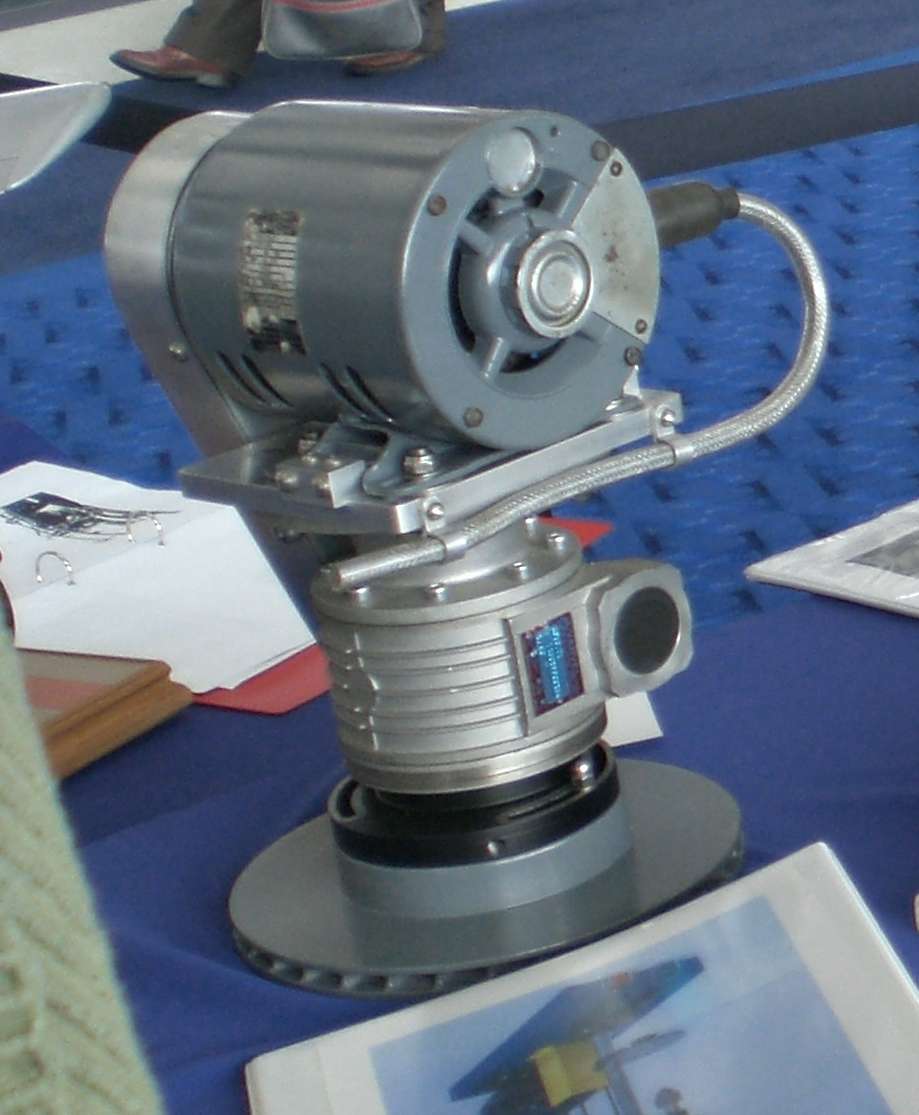

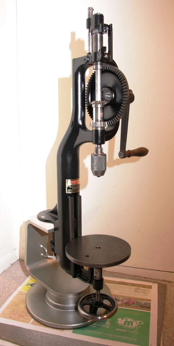

                    Hi, brake discs can make useful display stands.
                    Yankee Drill Display
                    Even ventilated ones can look good.
                    Speed Reducer Display
                    Regards Nick.

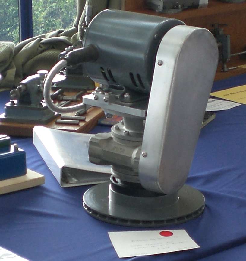

                        Nicholas Farr
                          @nicholasfarr14254
                          Hi, I don’t know why my ventilated disc photo doesn’t show in my post above, but here’s a different view of it.
                          Speed Reducer
                          Regards Nick.

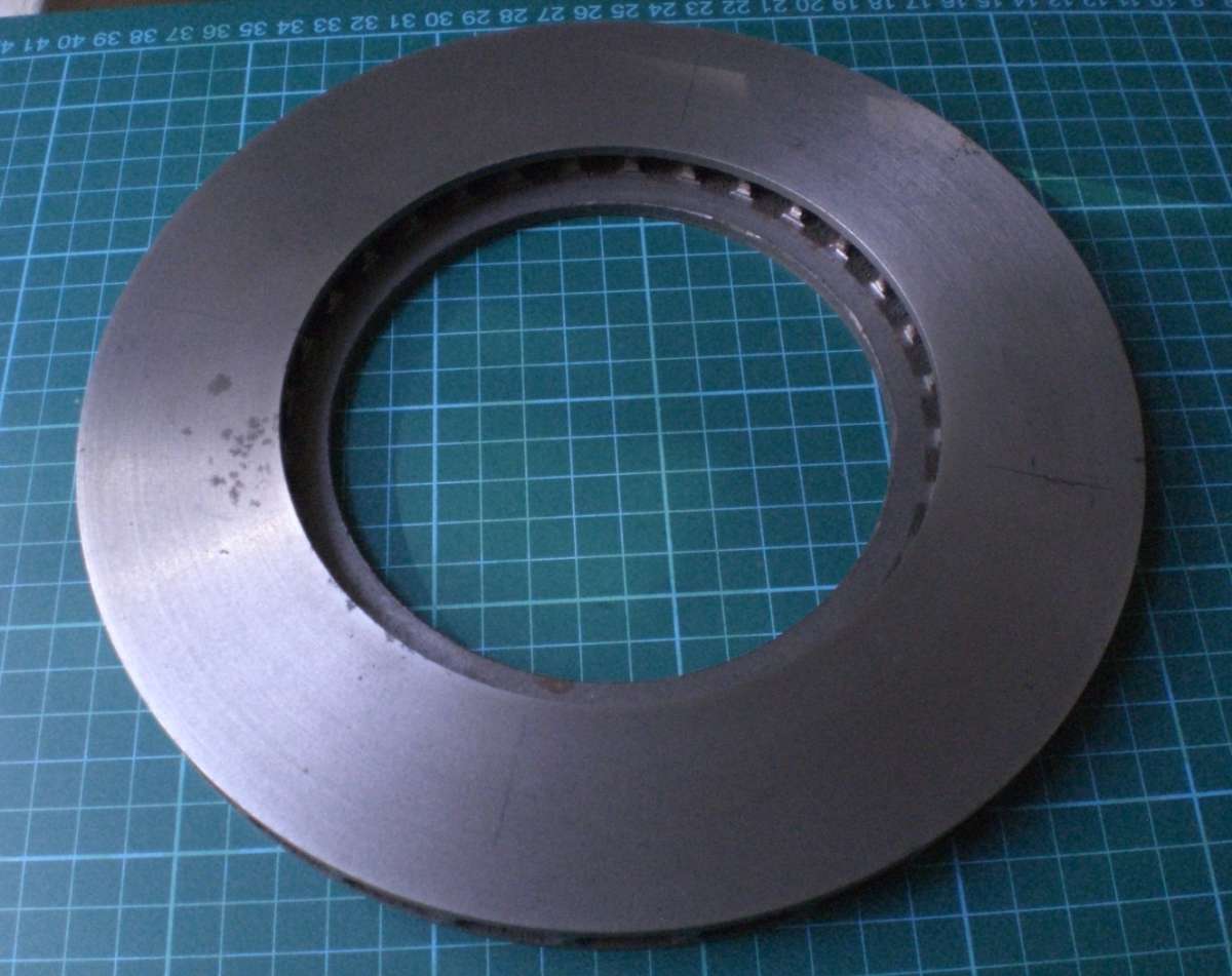

                                  Nicholas Farr
                                    @nicholasfarr14254
                                    Worn brake disc haven’t been any trouble for me to skim and make into a tramming plate, the one below is a nine inch one, I just parted the hub bit off as close as I could get, face off that side, and then the other side, after making sure the first faced side was running true, then just skimmed the outside and inside edges, just to tidy it up a bit, and de-burred all the corners. There wasn’t that much work involved really, and its thickness is close enough overall to be near perfect for my milling machines, this is a ventilated one, and it doesn’t move while tramming, but I’m sure you could clamp one down with a couple of small clamp that you could make, that would fit into the vents, if you find one a problem with movement.
                                    Tramming Disc
                                    Regards Nick.
