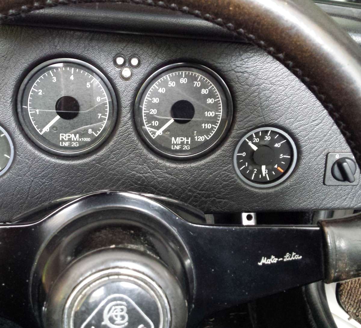

            Picture is of some dials I did in 2007 which I did in Autocad (although I may have exported them to CorelDraw for printing).
            I think I will also investigate using a printshop as they may be able to print white on to some surface which is ‘dead’ black, another thought is a vinyl cut out of black, so a sort of mask, but long term stability in a vehicle interior might be a problem.
            For interest, the small gauge on the right is ex helicopter and has a non reflective glass and the dial face seems to be some ‘light absorbing’ paint.

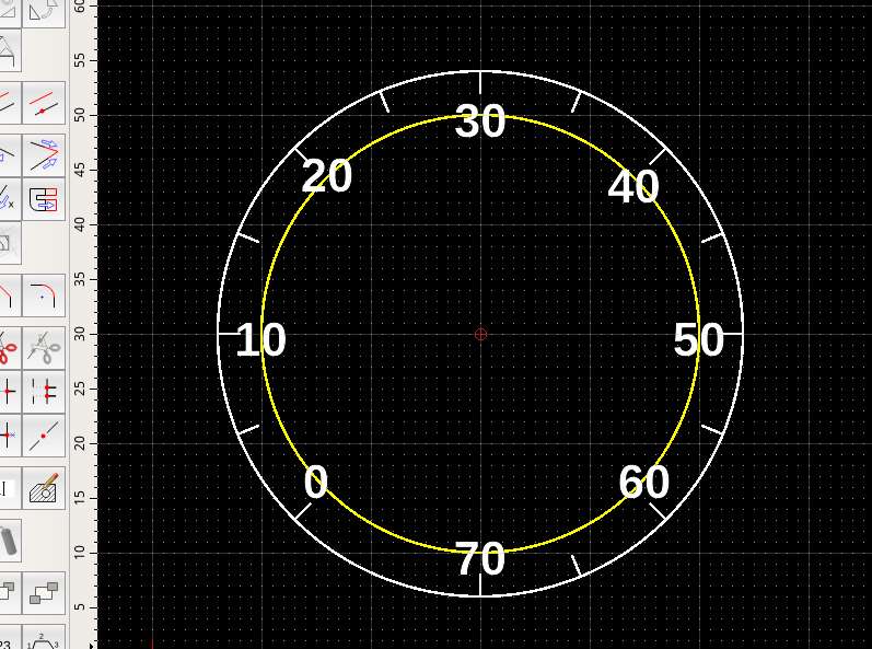

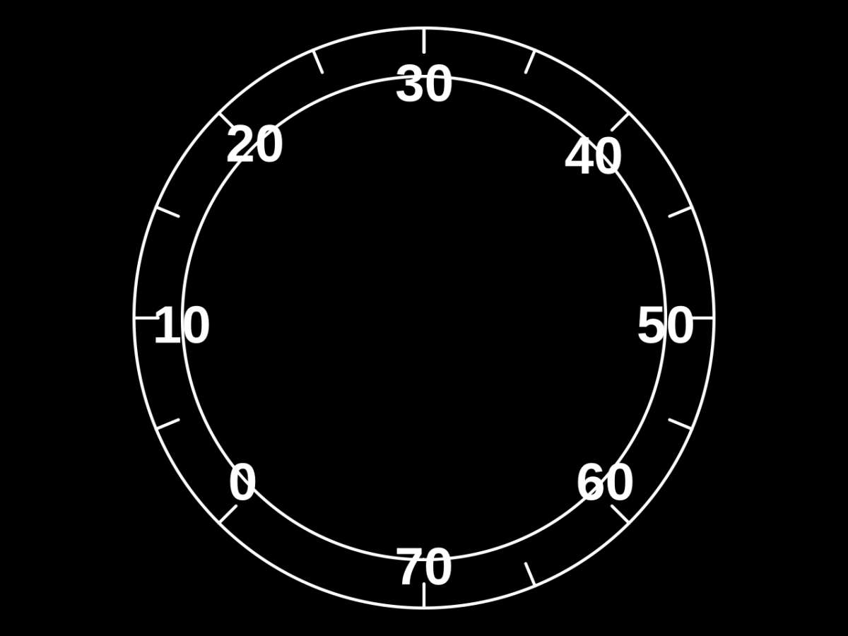

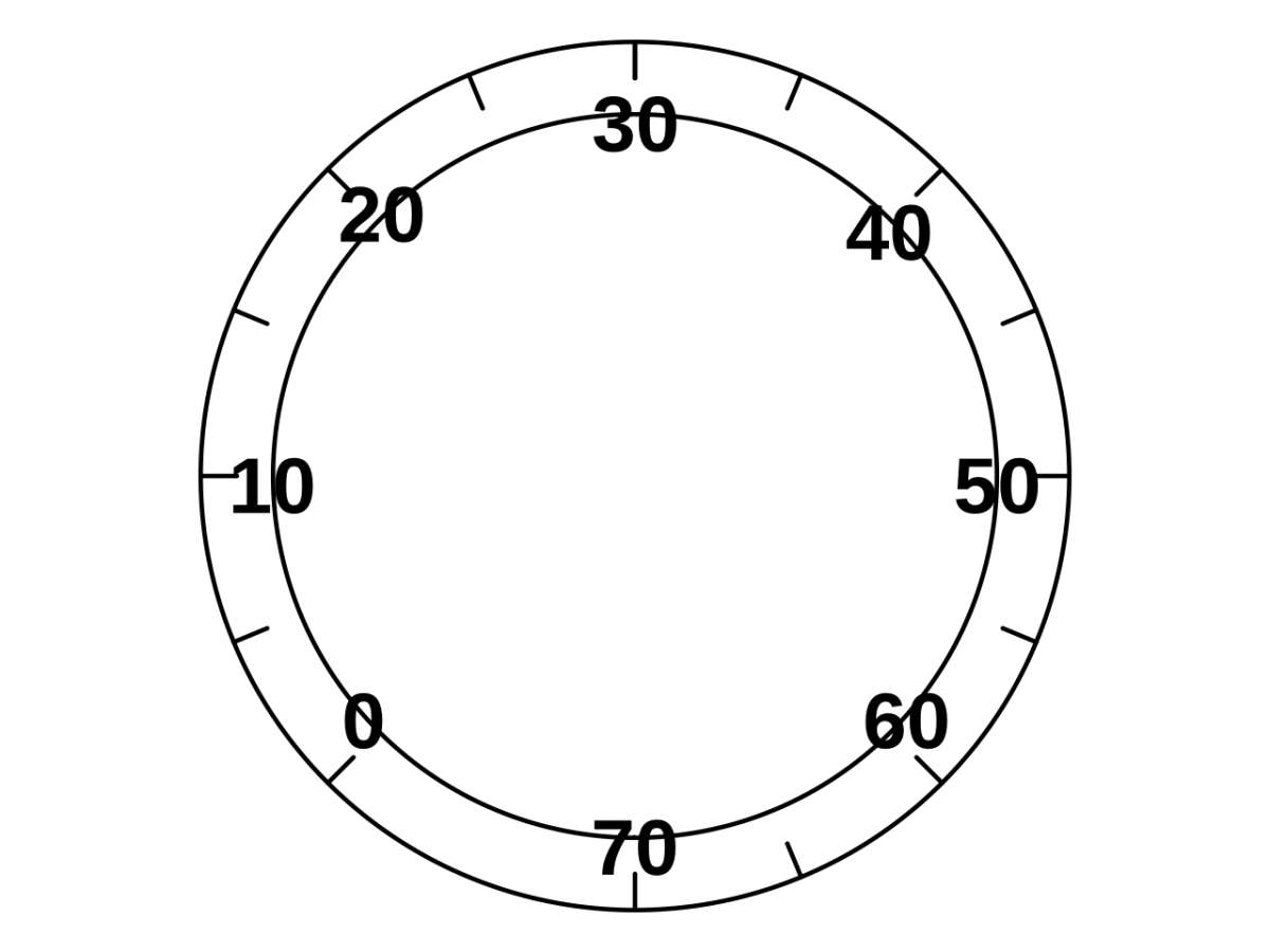

                  Does AutoCAD have an option for exporting the screen as an image (jpg, png or bmp)?   If so ‘export’ may have an invert option along with setting the image dimension etc.
                  If AutoCAD can’t export a bitmap, then use Windows Snip to capture the dial from screen and save it as dial.png.
                  dial.png can be edited by any image manipulating program, such as Paint, and these usually support colour inversion.
                  As an example, I created a dial in QCAD to show the steps.  The original dial in QCAD looks like this, note the yellow construction circle is converted to black:
                  qcaddial
                  I exported the QCAD drawing as a png, which when opened with Explorer on my system appears thus:
                  dial
                  Then I used ImageMagick from the command line to negate the image into a new file, dialinv.png
                  This is the result in dialinv.png:
                  dialinv
                  The advantage of ImageMagick apart from being free and open-source, is that it can operate on lists of files, which is handy when gazillions of images all need the same treatment – mass production.   Such as producing thumbnails of all the pictures in a folder, thousands of them.  Downside is having to learn the commands, rather than just pointing and clicking on a GUI.      But as can be seen from the example, inverting (aka negating) a single file isn’t difficult.
