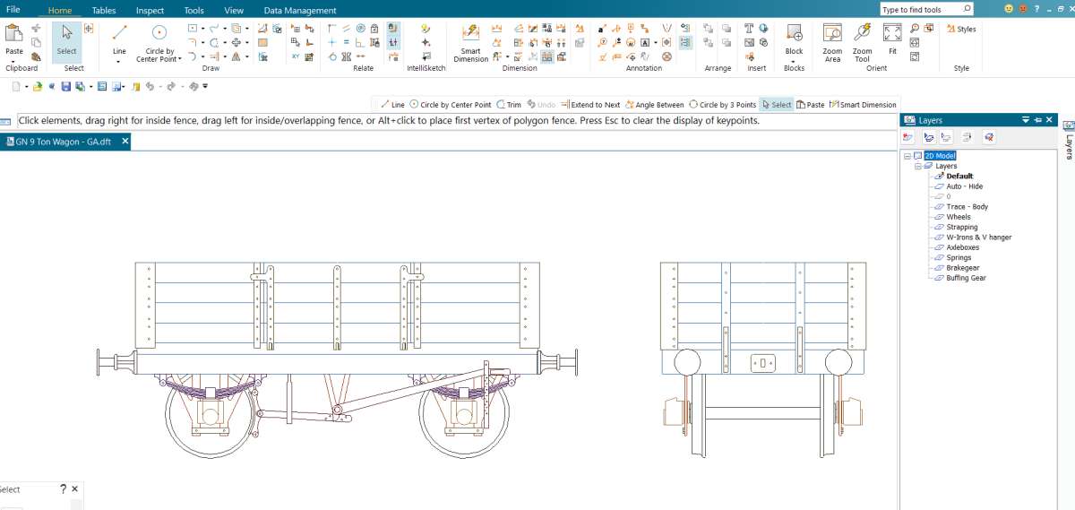

I’ve been successfully moving my TC work over to Solid Edge for a little while now. I do so by simply taking the whole TC (2D) file over using .DXF as the transfer mechanism. I don’t know your TC drawing practices but I used ‘levels’ extensively to draw individual components and also to make life easier when working on parts that overlapped others (by hiding layers to avoid ‘snap’ confusion). I never used ‘blocks’ that I recall but frequently ‘grouped’ things. I was very happy to find all of this information came over to Solid Edge and that everything could be edited, saved and printed as easily from within SE, as they could be from within TC. In fact SE finds errors with drawings that were hard to find in TC. I just save the imported TC DXF as an SE ‘Draft’ document and then (as far as I’m concerned) that’s it. I don’t need to go back to TC for anything – all further work in conducted in Solid Edge.
This wagon drawing was originally drawn in TC 2D and then moved over to SE. I’ve dropped down the ‘layers’ so you can see that everything has moved over and can still be used in the same way. Instead of model & paper space, SE uses ‘sheet views’ – background, working and 2D model – which you can select/deselct as required. I assume Alibre has similar capability.

Again – I just import my TC (2D) files into SE (using DXFs) and then can immediately save that file as a Solid Edge ‘Draft’ file. No messing around, no conversion work or anything else. Now I may then need to ‘improve’ the file because it has some issues but they were already there in the TC original (and I probably put them there too) – it was just harder to see them in TC.
So, assuming Alibre can handle ‘levels’ – just move everything across, save it in an Alibre native file format and do everything you want to do with that file using Alibre. You will of course have to spend time learning how to do this. I didn’t immediately realise how capable Solid Edge CE was in 2D because everything (help, documents, UTubes etc) assumes that you are working in 3D. It may take effort but in my experience, it will save you time in the long run by using just the one CAD.
Just get rid of your Legacy CAD System – you don’t need it if you transfer your data over…

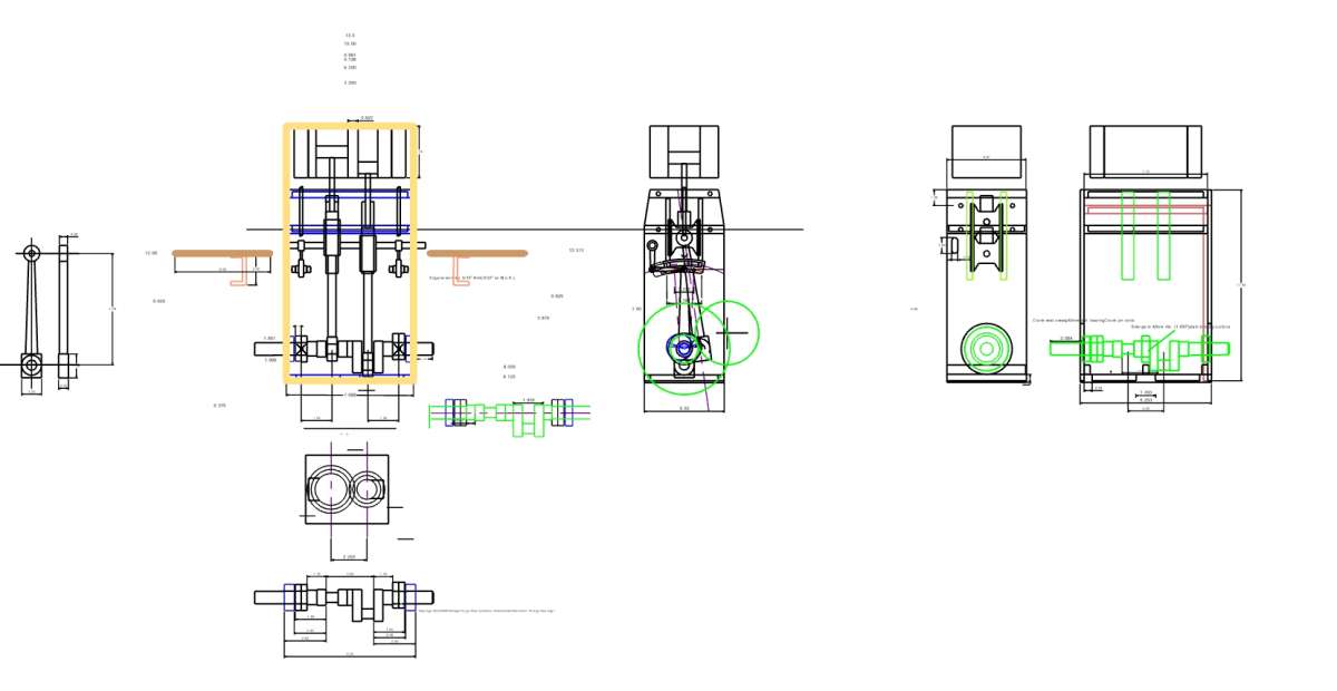

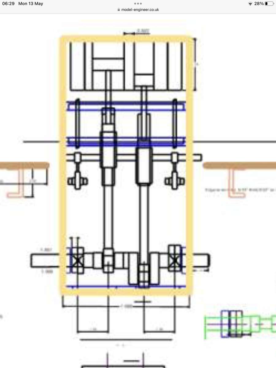

Well Nigel probably does need the old system as he will likely not have all the design in suitable DWG or DXF format to be imported.
As Ian says Alibre will import a drawing of a single item or a drawing of your whole assembled wagon. It does not know what is on the file but it will know that it’s a DWG or DXF file so will open that. You can then do a sI showed and pick the pieces off of that.
It won’t convert that assembly into a 3D assembly as the 2D does not contain the information needed without further input from you.
As I said earlier given your abilities with CAD I would suggest you redraw it in Alibre component by component and then assemble them in Alibre too. It is not as though you have a mass of components drawn up at least from what I have seen.

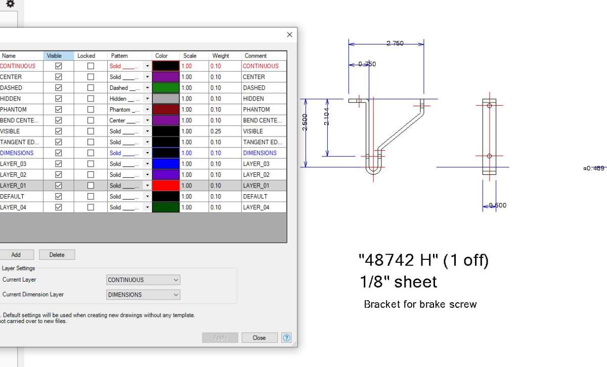

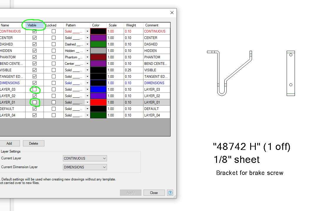

Alibre will handle layers from imported DXF and DWG files.
Using the same example as I did earlier this is as it appears when first opened which includes the part, ctr lines, dimensions, etc. Ticked on the list to the left.
If I then remove the tick from the items I don’t want and click apply I now get a much less cluttered image to select and subsequently paste into my new 2D sketch. If I also unticked layer 04 that would remove the hidden detail as well which is shown in a dark green
What is likely to be a problem in your case is that the levels are all over the place making removing one a problem as you may have a mix of wanted and unwanted items on that same level.

Yes, I did find and experiment with Alibre’s Layers table. It is slightly similar to TurboCAD’s though with several pre-arranged settings.
TC instead has you build your own Layers menu on a blank form, other than its own Layer 0 it dedicates to construction lines, equivalent to those in manual drawing, and nearly so to Alibre’s ‘Reference Lines’.
I didn’t know if the Layers would translate from TC to Alibre, at least not without a lot of editing; but did find it seems easy to create a layer, and to change an element’s layer, in Alibre. That suggested to me a safe way to help ensure the translation would work; moving all the outline elements to a new layer.
You are right though that the Layers in many of my TurboCAD drawings are a mess. I could create the Layers in their menu in TC – that’s the easy bit – but not make them stick consistently. Plus I often forgot to change the layers anyway.

Well, I took another step forwards yesterday.
Re Jason’s explanation of Levels, above.
I have a basic orthographic GA of my steam-wagon, in TurboCAD. I went through it, simplifying its somewhat tangled innards, re-saved in its original .TCW format then exported it in .DWG to my Alibre library. TurboCAD does not have an “export” command as such – simply “Save As” by type and destination in the usual way.
So what will Alibre make of it?
It worked!
I then spent a while tidying that import, saving it as an Alibre drawing file; moving all the outlines into a new level called “Parts”, dimensions into the Alibre default Dimension level, centre-lines ditto but I did set them from continuous to dash-dot pattern. One exception is the boiler’s outline, which I left in its own level and colour.
I’ve not yet found what the line-thickness values mean. Some are negative numbers? I’ll have to search the manual. I could also experiment by setting up a very simple drawing with several elements in basic shapes like cubes, each on its own level.
(Yes I know I have bought Alibre Atom; but I still have many drawings on TurboCAD, and need it for direct orthographic drawings such as complicated assemblies and general-arrangements.)

I use an HP A4 printer for most things; but one of the few drawings now of any value in my TurboCAD library is a rough, incomplete, 2D GA of part of my steam-wagon project (shown below); and too large for A4.
Though I managed to copy it to Alibre thence in jpg for here, Alibre opens it as a “finished” drawing of no practical use. The transfer seems to left some parts of it behind, too. So I have to keep it “alive”, and use it, in its original TurboCAD home.
Drawing a complicated general-arrangement from which to extract individual parts for their own drawings, necessitates either TurboCAD in 2D-only mode or my manual drawing-board – if I can rebuild it.

here’s a screenshot of part of your posted image, on my ageing iPad Pro 9.7”
… the resolution is, of course, currently limited by what you have posted rather than by my screen.
Edit: __ I would be happy to test the concept, if you can send me a file at suitable resolution,
As has been discussed before the imported file is not “useless” in Alibre. It can be used as a basis for a 3D model. See the earlier part of this thread.
