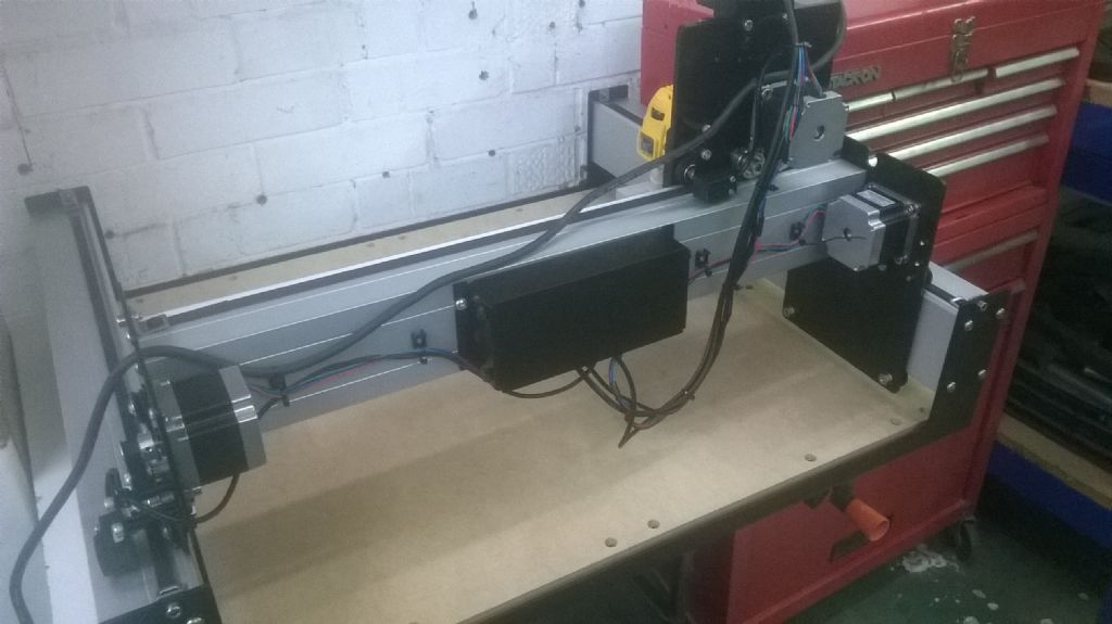

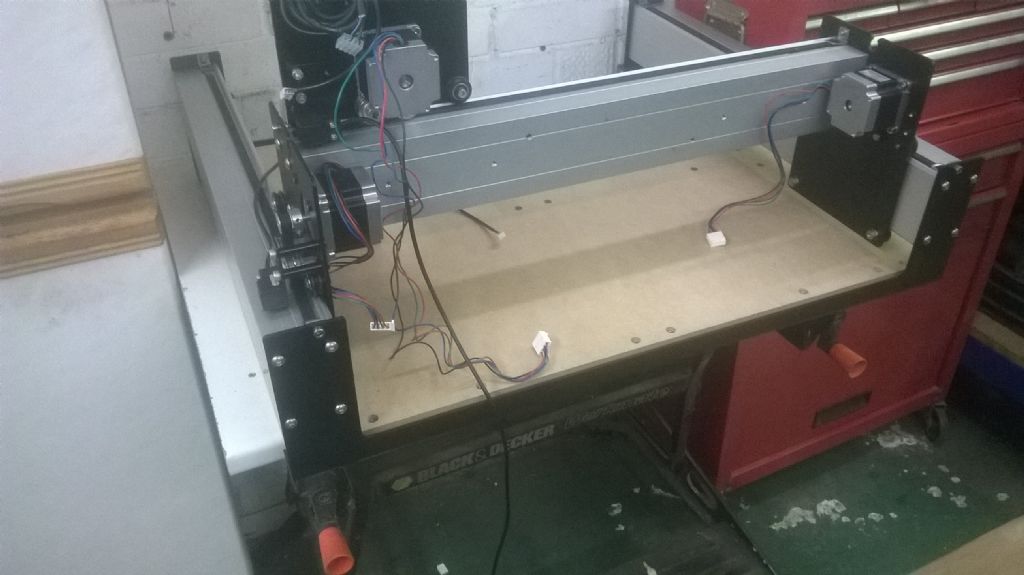

A little more progress today. Taking it slowly so as not to make (m)any mistakes!
Finished off the wiring and after the shot below was taken, found a cable-tidy lying in a drawer, so used that to smarten things up a bit – though it won't show, but I know it's there.
This is from the rear. I assure you it looks neater now.

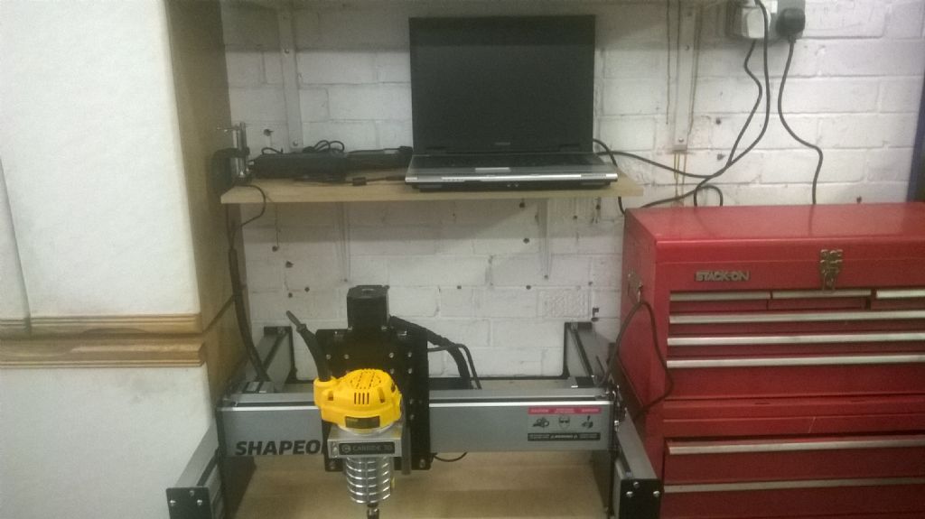

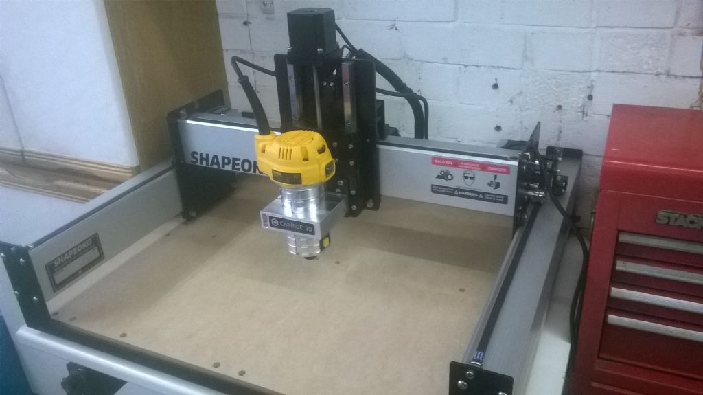

Everything squared up and tightened, rotated 180° ready to test and the DeWalt router mounted ……..
Then I realised that the power supply had a U.S.A. plug on it and no spare ones in the house. Never mind, I'll pick one up at Tesco's tomorrow. In the meantime the laptop is getting a charge, so with a bit of luck, a short video might be on the cards tomorrow – with or without smoke, you'll just have to wait and see.
I think that I'm going to get some MDF to make a new waste board to protect the base board. I'll use the router to drill a grid pattern of holes to accept some 6mm threaded inserts to aid workholding.

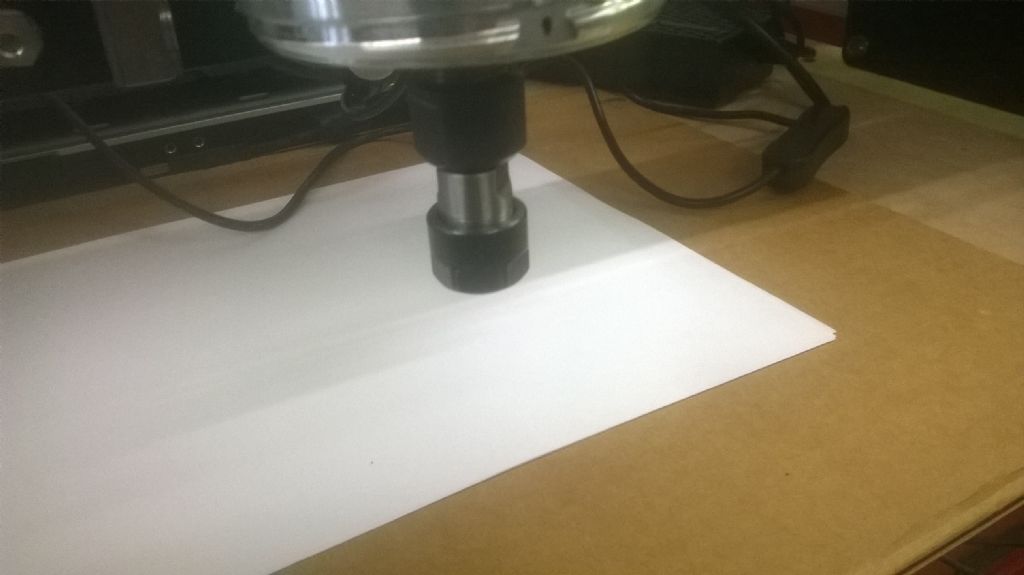

I have been fiddling about with a double-tapered sleeve and ER11 nut re-threading arrangement in order to utilise a selection of metric end mills, but I've abandoned that idea through lack of accuracy and a better idea:
I have purchased a genuine DeWalt 8mm collet and nut to replace the standard ¼" one that rather restricts the end mills one can use. Instead, I have an ER11 collet chuck with an 8mm straight shank which I'm going to shorten and that will fit in the 8mm collet and allow the use of cutters in the ER11 range of sizes – up to 7mmØ – 8mm collet for the next one up. I just hope that there won't be too much "stick-out". The machine is supplied with a ¼" end mill, so I can start on some wood for the first exercise. Next episode will not be for a couple of days, I guess, by which time I would hope to have sourced some MDF sheet.
