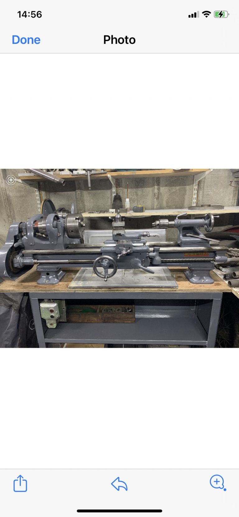

      Just bought and refurbished my first lathe. I decided to get my own after years of getting a mate to make motorcycle and car parts for me. After owning American cars for over 45 years it was fortuitous that I have aquired an 81 year old American South Bend 9C. In the 4 weeks I have owned it I have stripped it down to the last screw and fully painted and refurbished it. My bench is now full of practice pieces and I am just mastering the dark arts of tool grinding and external and internal threading. I'm just waiting for a 32T gear to be delivered so I can make an Acme threaded operating screw for a 4 jaw chuck.

                  Does yours have a thread dial fitted?
                  #585207
                  chris cunliffe
                    @chriscunliffe29054
                    Yes Vic it does have the thread dial19203b24-95eb-4d20-8ef7-7c48f1d8f50d.jpeg
                    #585211
                    Thor 🇳🇴
                      @thor
                      Hi Chris,
                      Your 81 year old South Bend looks very nice, you have done a good job.
                      Thor

                      vic newey
                        @vicnewey60017
                        Looks nice, Mine came without a thread dial but now fitted with a Boxford one
