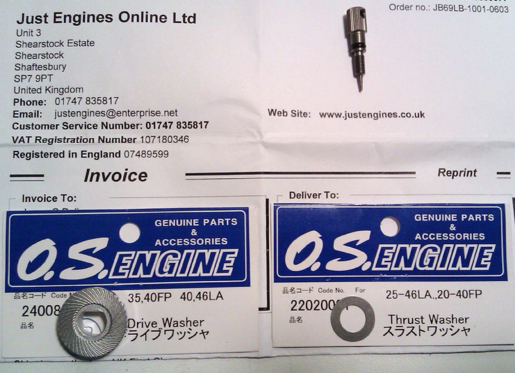

        Having just ordered the various OS engine spares it struck me that possible builders may want to order a glow plug at the same time to save another postage bill. I've got a couple that have been sitting for 20odd years so will dust them off and see how it runs.
        BTW here is what the various OS parts are like for anyone interested, I also got some blue tinted fuel line so it matches the 3D renderingsface 9
