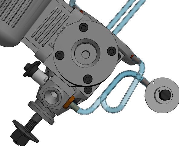

        The series kicks off in 4432 with a description of machining the crankcase, the text states several times that the large hole in the rear of the block is 30mm dia.
        The rear view of the crancase on drawing WF46-0003 clearly shows this hole as 28.2mm dia. The plan view shows the cylinder mounting bolt holes spaced wider than this bore and dimensioned at 30mm cts which seems to tie up with the hole being 28.2mm
        Can someone confirm if the text is wrong or the drawing, not a good start.

          Having now looked at a drawing of the backplate that fits into this hole, the text is obviously wrong.
          Can David, Diane, Alex or Frank comment on this, was Frank building to an earlier revision of the drawings or did he mistake the 30mm bolt cts as the bore?

                              Well spotted Jason. This also affects the wall thickness dimension given in the text as 3.75mm. Should be 4.65mm. Drawings seem ok though. Will give this engine a try.
                              #92443
                                Yes the wall thickness in teh text suits the larger size hole so there is a risk of someone machining the bore to drawing and then the wall thickness to the text and ending up with a small block.
                                And while I'm on there are not enough dimensions for the two side chamfers, we only have the 6.75mm short side, the drawing either needs the angle as per the other chamfers or the long dimension as they stop just short of the chamfer on the top carb face. I know the chamfers are not critical but the info is not there and I'm surprized that of the six or so builders none noticed this?
                                I quite fancy giving it a go myself but would like to know why the author says 30mm before cutting metal and I'll likely wait for a few more installments to be published.
                                David in his intro Alex says that that the proving group builders will "make their expertise available via e-mail" now I can understand them not wanting all and sundry bombarding them with e-mails but I assume you have Frank's e-mail would it be possible to ask him to explain where the 30mm comes from ?
                                Edited By JasonB on 12/06/2012 13:17:26

                                  I haven't had my copy yet (via WHS) but you are quite right about the 28.2mm rear hole. I have just grabbed a moment to look at the full set of drawings on Alex' site and they all show it as that dimension (Rev C). As to email, I suspect that Alex wouldn't like his address being published but you can access him via an email link from his site (link above). It would probably be a good idea to publish that information in the articles.
                                  The only reason that I can think of for such an error is that the hole centres for the cylinder mounting holes are given as 30mm on the plan view and the article is being written well after the original build leading to confusion? As for the angles of the nose, the top and bottom are given as angles while the sides are shown as beong derived from the dimensions (23.5 x 6.75mm)
                                  I have some offcuts of suitable alloy so may have a go at this engine if these niggles can be sorted.

                                              I see your point on the 23.45mm (sorry about the typo) dimension on the drawing on Alex' site but the 3d pdf you linked to appears to show the side and top slopes to end at the same dimension if you view it from above.
                                              Firefly 3d
                                              I have little experience of building i.c. engines and am not sure of the significance or importance of such a discrepancy,unlike that of the conflicting dimensions of the rear hole. I would be grateful for any light you can throw on this. I have a lot of respect for your experience and have been grateful for your observations on the portable engine.

                                                Terry that crankcase in the 3D pdf has had the whole front end machined differently to the drawings, if you look it seems after the top was chamfered the nose was turned as all the corners are rounded and there are notches where the curve meets the flat top chamfer this is what you are seeing in teh picture you have posted so you can't really compare the two.
                                                As I said when I first raised the point about the side chamfers they are not critical but as this is being toted as a beginners set of drawings they may not be able to assess what is critical and whats not so a dimension would have helped.
                                                Again with the 28.2 vs 30mm bore provided the back plate is made to fit and the overall 37.5 retained it won't make that much difference, Although I have done several IC none have been glow so don't know if there are issues with the air/fuel circulation with the bigger hole as the crankcase acts as the inlet manifold in a way. We are told Frank's engien worked so it can't be too critical if he did make it 30mm but could affect overall efficiency. But lets face it how many who build this engine will actually fly it? I think most will just bench run it so as long as it goes we will be happy.
                                                J

                                                  Just use the alternative crankcase design without the chamfers.
                                                  Problem solved.
