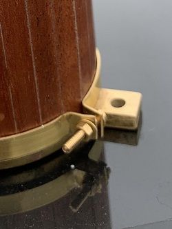

      Dear all
      Below is 'the usual way' of securing thin brass straps around a boiler (or condenser in this case). It's pretty ugly and I usually try to hide them out of sight.
      Is there a better way of doing this? I was thinking along the lines of a very small jubilee clip arrangement soldered to the ends of the straps.
      Regards all, Kevin

        Clive Brown 1
          @clivebrown1
          I silver solder small squares of brass, say 3/32" thick, each end of the strap instead of the bends shown above. One is drilled and tapped a small BA size, the other a close clearance hole. This dispenses with the separate nut and the squares stay fairly well parallel.
          The screw should be as short as practicable.

            The approach Clive refers to is described in the ME Vertical Boiler series in ME issue 4601….
            #506727
              I have done the same as Clive describes. On your photo simply rounding the ends of the straps would make things more presentable.
