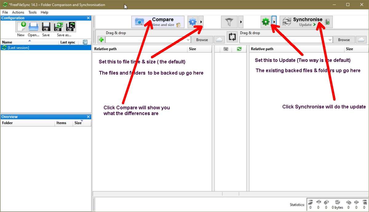

      I back my files up on a regular basis to an external hard drive by copying but it takes ages as I copy everything!
      Searching around mention is made of Incremental and Differential techniques to only update files which have changed but is seems a minefield to me.
      Can anyone recommend a simple reliable method or program to use?
      Thanks   Peter

        FreeFileSync is neat, works well and is free.

                      Don’t worry – try it.
                      Opens a screen with two panes. Drag & Drop the folders you want to back up into the left hand pane. Assuming the external drive is connected, drag and drop the folders on the external drive to the right hand pane. Set the Compare Settings to Time & Size – the default. Set the Synchronise setting to Update ( Two-way is the default). If you then click the Compare button the programme will show you what it is going to do by comparing the two sets of files & folders.
                      Clicking Synchronise will do the update.
                      FreeFile
                      Hope this helps.
