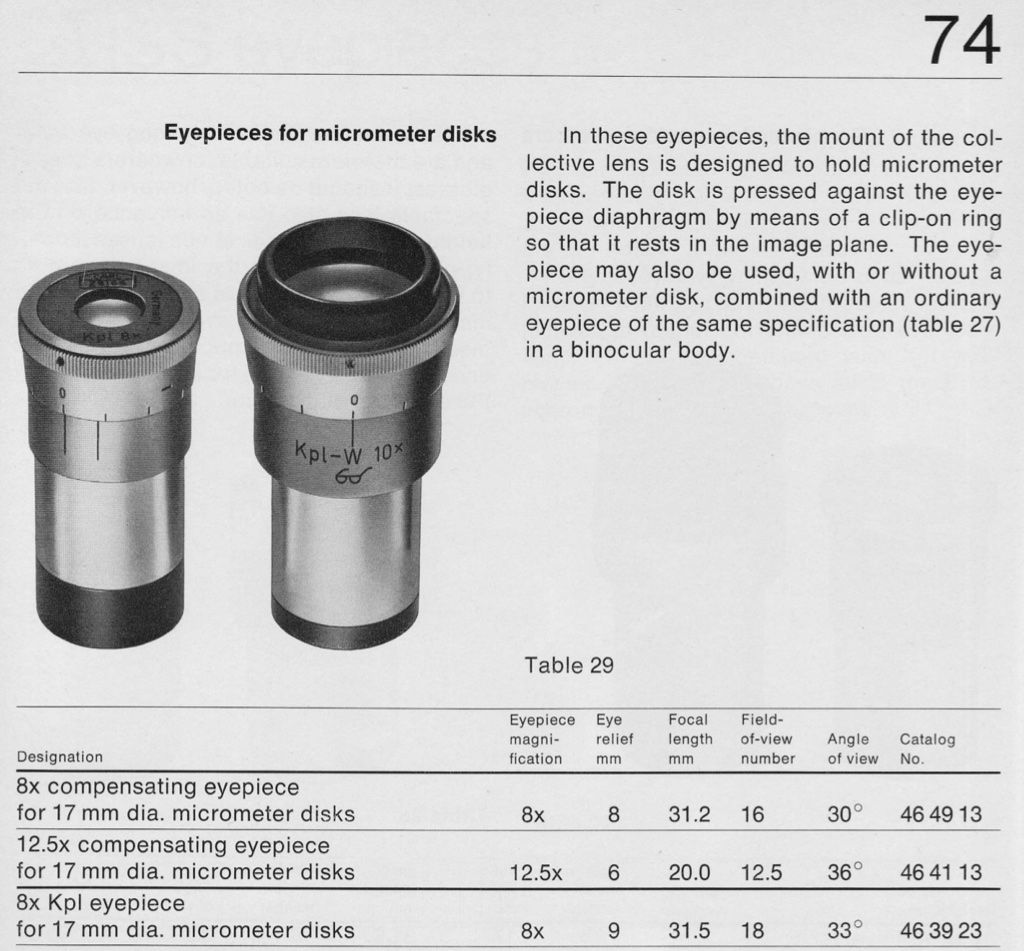

      Here is a 'crop' from p74 of a Zeiss booklet:
      For anyone interested; the whole document is at: **LINK**
      http://www.science-info.net/docs/zeiss/ZeissOpticalSystems.pdf
      ____

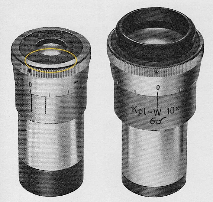

      I have a couple of the 8x Kpl eyepieces, as illustrated on the left, and described on the third line of Table 29
      The scale is obviously for dioptric adjustment, but why are there two fiducial lines, and how would one use them ?
      Zeiss appears to be totally silent on the matter … so can any 'Reverse Engineers' devise the instructions for use [please] ?

        Question: Why are there two ? …

          If I recall correctly we had some optical equipment in the lab with similarly marked eyepieces arranged so that optical components could be inserted beneath the eyepiece mount. Presumably graticules or similar. I'd always understood that the two lines were provided to correct the calibration when the extra component was fitted. Presumably makes some sort of sense with binocular system with a graticule on one side.
          Never used the kit they originally came off, not sure we still had it, as the tubes and eyepieces had been robbed for other purposes. Probably some sort of bespoke, lab built, test gear. Not something I'd built.

            Thanks, Clive … That was actually the hypothesis that my microscopical friend offered: Unfortunately we cannot reconcile it with the fact that the W version [illustrated to the right] only has one line.

              Full inscription on the one on the right is Kpl-W.
              First two lines of the data table says the plain 8x and 12.5x eyepieces are compensating ones. Presumably the left hand one in the picture.
              Third entry is separated by a heavy line and simply says 8x Kpl eyepiece with no mention of being compensating. Also focal length, eye relief and field of view is slightly different to the compensating 8x.
              Suggests they are different designs. First two are compensating where one line is used when a graticule or whatever is fitted and the other when used as an ordinary eyepiece. The Kpl-W version being an ordinary style where you either need to adjust the position in the tube if a graticule is fitted or have a plain glass in the clear view tube to compensate.
              But microscopes have never been my thing except for casual use and as sources of optics for other duties.

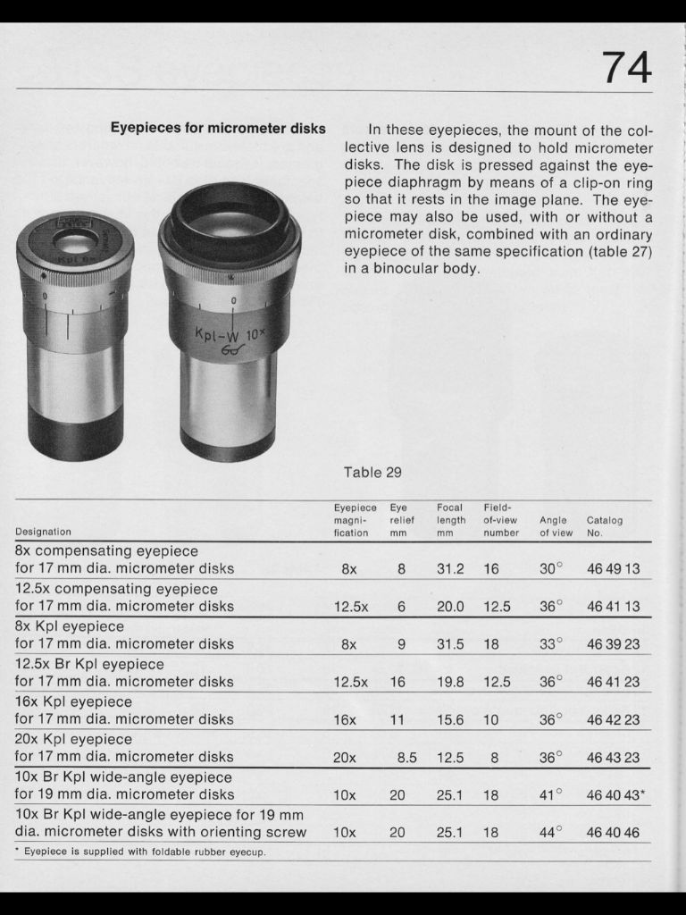

                It's a bit more complicated than that, I'm afraid, Clive
                You may find it interesting to look at the full document; but the gist of it is on p40
                "As is the general practice today, the magnification of the eyepieces is indicated by a figure followed by " x ". Letters before the magnification mark the type of eyepiece. Since we manufacture only compensating eyepieces, such an identification would normally be superfluous. However, our eyepieces of higher power are so designed that they produce a flat field, which is not necessary for the low-power systems. The latter are therefore marked C (compensating eyepieces) to distinguish them from the former marked Kpl (compensating flat-field eyepieces)."
                The two eyepieces illustrated are both marked Kpl and are therefore compensating and planar … The one to the right has the suffix W for wide-field.
                The table has several more lines, but Kpl 8x is the one in question, and is the one illustrated to the left.
                Apologies if I caused confusion by cropping the table short … I was trying to maximise resolution of the relevant parts.
                Edit: Here's the full page:

                          Sorry, Clive … another ambiguity rears its ugly head.
                          I'm referring to the two 'setting lines' on the barrel of the Kpl 8x

                                          No problem, Bill … I'm grateful for all comments on this one; it's driving me nuts !
                                          Incidentally: Whilst I doubt if the colour is significant; the right hand fiducial mark [as we view the picture] is Red.

                                            Here's my guess. The eye-piece is designed to be used with a micrometer disc inserted or not – the disc isn't a fixture, and I see Zeiss offer a few different graticules.
                                            The usual purpose of the focusing eye-piece is to adjust for right/left eye differences when using a stereo microscope. (One eye-piece is fixed and focussed with the ordinary rack, then the other eye-piece is adjusted independently to suit the other eye.) I suggest the first fiducial mark is for operator convenience – it allows the eye-piece to be quickly set to suit each individual who might be sharing the microscope or eye-piece.
                                            Normally the focus is adjusted for best image. But when a micrometer disc is inserted the eye-piece should be adjusted to sharpen the graticule. I think one fiducial mark is for the plain eye-piece, the other represents the offset necessary to accommodate the micrometer disc. The advice on micrometer discs starting end of page 40 may support the idea: These figures are engraved on glass plates (micrometer disks) which are inserted in the diaphragm plane of the eyepieces. However, since they will not necessarily be seen sharply with normal eye-pieces, above all if the eye of the observer is not free from visual defects, eyepieces with a focusing eye lens are used for this purpose.
                                            The eye-piece is provided with two fiducial marks so users can quickly set the eye-piece for either disc in or disc out viewing.
                                            If anyone has a spare Zeiss microscope and accessories I'd be delighted to test the hypothesis. Distinct chance I'd fall in love and refuse to return it though!

                                              I think the mystery is solved … and the answer is what was first suggested.
                                              The current version of Zeiss document 'Microscopy from the very beginning' describes the modern 'infinity' microscopes [which have superseded the 'finite tube length' models] … but it includes the following brief statement:
                                              [quote] The eyepieces are labelled with a diopter scale (  + 0 – ) and “foc”. If an integrated reticle is used, the red dot represents the zero mark because of the image shift which then occurs. [/quote]
                                              One can only assume that the red line on the old eyepieces corresponds to the red dot on the new ones.
                                              Thanks to everyone for their thoughts.
                                              Ref. http://www.its.caltech.edu/~bi177/private/Microscopy%20from%20the%20very%20beginning.pdf
