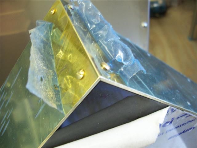

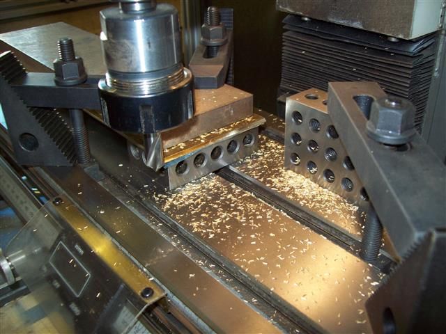

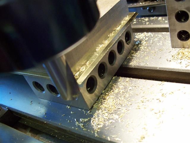

          magpie
            @magpie
            One of the finished jointsMitre JointQuite chuffed about a bit i got done today. The clock face will be black perspex on an ally frame which will have brass sides. The brass is 16 gauge and i wanted to mitre the corners (83mm wide), so this is how i did it. 10mm cobalt spot drill 90 degree point used as a milling cutter. The pic of a finished corner is not too good but the joint is spot on, on all four corners no less. WOOHOO !
            Cheers Derek.
            Mitre Joint P.S. Two months late, but Thanks Dennis
            Edited By magpie on 09/05/2013 20:14:23

                #119228
                Sub Mandrel
                  @submandrel
                  Very neat!
                  Handy tip! Thanks for that1

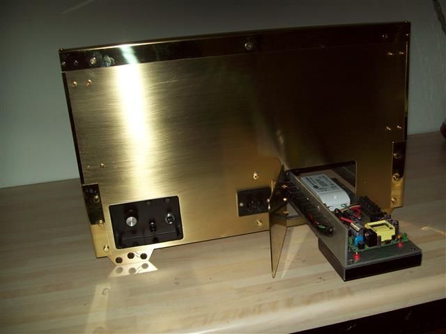

                      #144238
                      magpie
                        @magpie

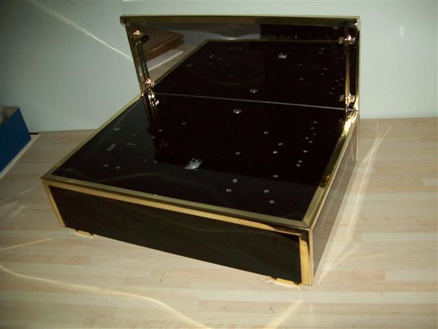

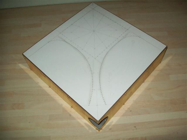

                        Here we go again ! This is the new base for the clock, drilled and ready for all the bits to be fitted (after they have all been polished that is). The next pic shows the rear of the base with the LED power units on a slide for easy access. The last pic is of the clock face marked out ready for drilling. It is also black Perspex but it has a protective film on at the moment to aid marking out. With a bit of luck I may even finish the whole thing this year.
                        Cheers Derek.Finished clock base.Rear of clock base.Clock face.

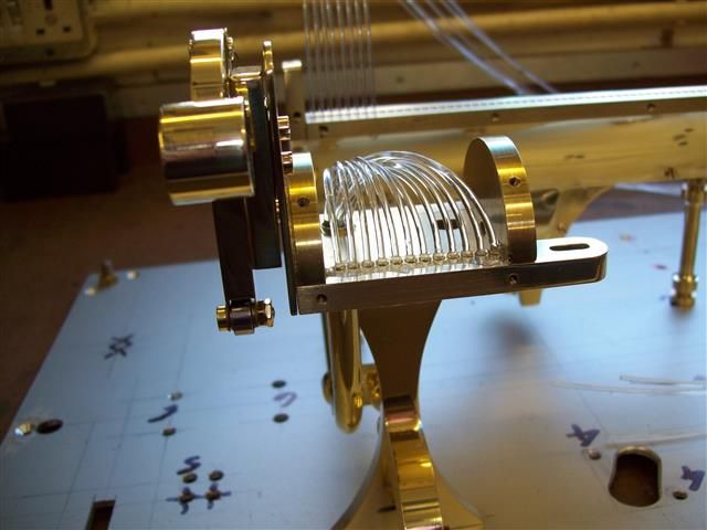

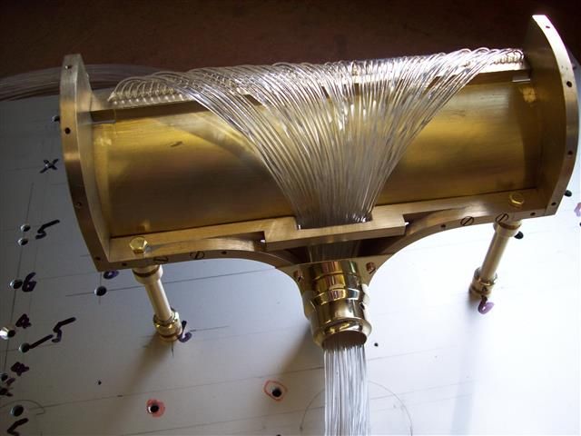

                        #147717
                        magpie
                          @magpie

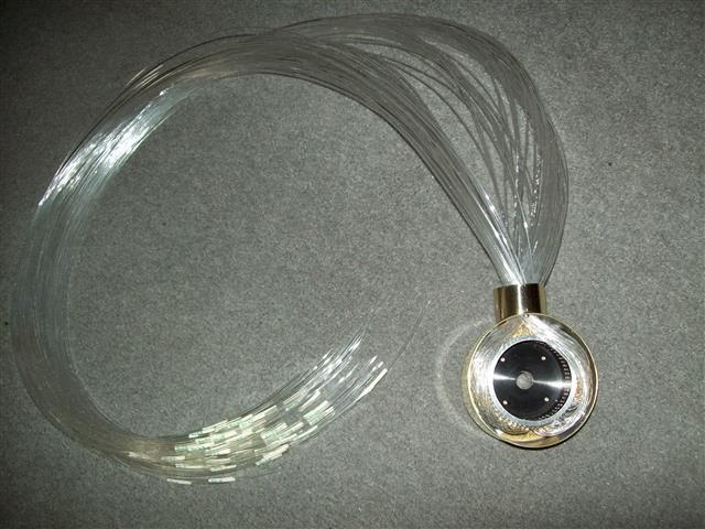

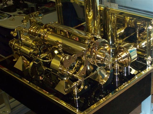

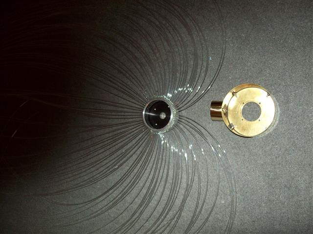

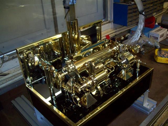

                          It's that man again. Here are a few more photos of work to date. The first four show the fibres being attached to the "sending" ends of the mechanism, and the last two show progress at putting the thing back together. The base is,at present mounted on a jig to enable me to work underneath. When the clock is finished, I hope to get a mate to make a vid, as my little camera does not take the best of photos.
                          Cheers Derek.Inner and outer cylinders.Both together.Hours assy.Minutes assy.Coming together.Coming together 2.

                                #147937
                                magpie
                                  @magpie
                                  Jason, thanks for the compliment and yes it will look even more like an "interrositer" when the face is fitted. Stew, it took best part of a week to polish all the bits, and looking for the ones that the mop threw up the workshop. Not "brasso" but some stuff called "clockshine" which was recommended by some of the other clock makers on this forum. Seems like good stuff, but time will tell !!!
