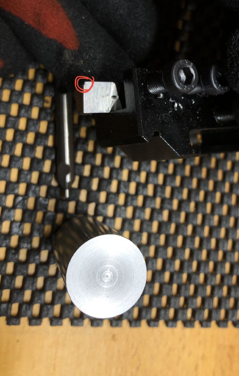

                                                  So I knocked up a LH knife tool to use parallel to lathe axis as was advised. Pleasingly it produced a smooth/free cutting finish.
                                                  BUT…I noticed after a second pass (silver steel round) the tool developed a little knick at cutting edge. Thta would explain why, despite being bang on centre height, the final few mm of inward travle has a much rougher surface finish. Please look at the photo; I've circled the defect. Sorry but it's hard to expose correctly given the shiny steel (told you surface finish was otherwise good!)
                                                  All of this, is to ask: is the generic HSS to blame (cheap bundle from RDG) ie should I upgrade to a better quality HSS blank? Admittedly I'd assumed that on hobby machines at least, HSS was much of a muchness.
                                                  Has anyone bought Rennie HSS blanks (pleasingly they're made in England). I think I'll try some of these.

                                                    Choo – I've been searching for this image for you – it shows a toolholder for the lathe tool bits made from discarded Fc3 cutter shanks. dscn4034.jpg
                                                    If these are held in a holder made from round bar for grinding then it makes grinding the shape (by eye) very easy.
                                                    The quality of the HSS is as good as the cutter was. You don't need to grind away sizeable chunks of HSS to form a tool just enough to be efficient and of course 'cheap' enough to 'get it wrong' and try again.
                                                    Though I have quite a few pieces of HSS with various shapes ground on the end these two tools are the ones that get used the most
                                                    You may have been turning your silver steel a bit too fast to affect the edge of a freshly ground tool in one pass but, as you assume, the quality of HSS may be to blame too. At least re-sharpen and reduce the rpm to see if it improves. In my time I've always found Sil Steel one of those 'difficult' materials. A sharp edge, higher approach angles than normal with a small radius stoned on the end and slow speed and feed produces a reasonable result I find.
                                                    Hope that helps some
