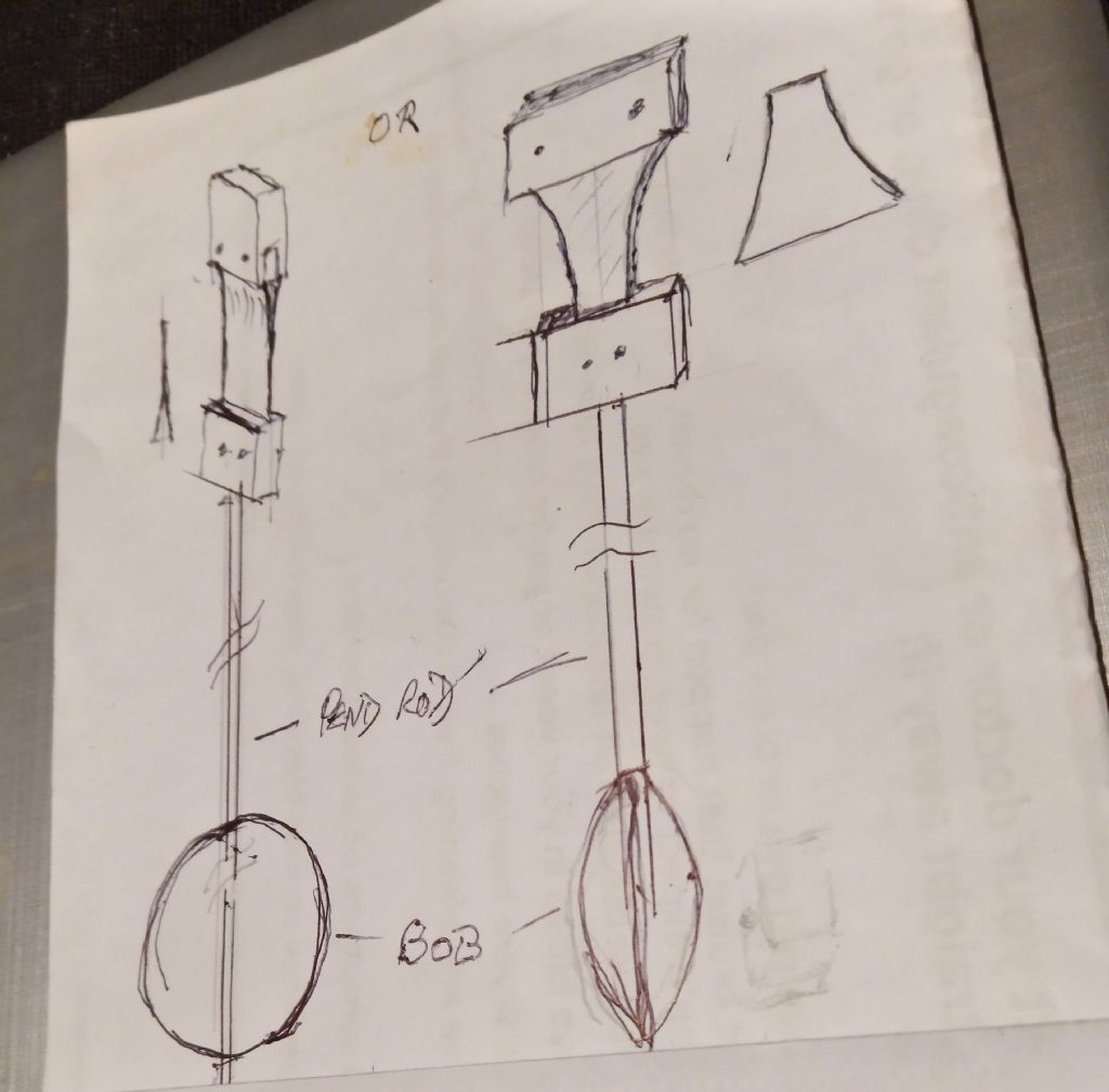

                              I was looking at Fedchenko's suspension springs, unusual in that they make two outward curves at each end to meet the thicker sections. I wonered if they made a difference to the circular error, as the top of the spring would flex more than the bottom. This led me to wonder if a spring made to some specific curve to the thickness of the spring (difficult ) or the width (easy ) could be isochronous. As I have no timing equipment nor do I understand it, I was hoping someone cold do a quick and dirty comparison between a piece of raw suspension spring and then roughly shaped to an involute (?) curve. Or am I just being img_20230220_182243_3.jpgnaive over the whole subject?
                              dave8
                              Edited By david bennett 8 on 20/02/2023 21:01:14

                                Various people have analysed suspension springs to see if a single spring can counteract circular deviation – names to look for are Kenneth James and Philip Woodward. But the answer is no, except for Fedchenko which is a compound spring.

                                  Slightly confused here, Dave [please forgive me if I have missed the point]
                                  … You do not appear to be considering what is described around Fig.4 in Fedchenko’s paper that I linked.

                                    Michael, yes he says "misunderstanding", but I still don't know what it is. So "naive" it is. Thanks all for saving me some time over this.

                                      This will probably sound glib, Dave … but that’s because I don’t understand sufficiently well to give a complicated answer !!
                                      I think what he’s really saying is that problem is too complex to be solved by cleverly shaping a spring … it demands the dynamic interaction of three springs to achieve the necessary motion.

                                        Michael, thanks for trying to clarify! While I have the greatest respect for any expert in their field, I have to retain my right to be a "doubting Thomas" until I prove it for myself (though not in this case) I have known too many cases where conventional wisdom has proved wrong.

                                          The reason they curve from the thinner to the thicker sections is because they are machined out of the thicker base material. If the transition was square it would probably quickly fracture. Matthys describes making springs from phosphor bronze strip by milling both sides of the spring section away with the side of an end mill, the material being clamped flat on a vertical face. Having machined one side it was turned over and re-clamped with the space filled with plaster of Paris for support. Tricky! But that obviously leaves the curved transition.
