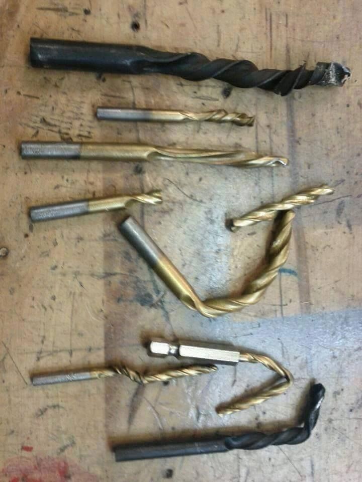

      A friend called me to ask for help ! New to engineering, and had bought a lathe. He had invested in a GOOD set of drill bits – over £100, and found first he could not drill a 8mm hole in steel, then tried to drill 13mm in alli – NO GO ! I offered some suggestions but had not thought of this one !
      Mentioned this to a local tool stockist today and he said look at the bits, and handed me an 10mm, I COULD NOT BELIEVE MY EYES ! It had been sharpened to a chisel edge, like a rotary percussion drill bit – then coated ! This was not a cheap bit, of 4 facet or split point design !!!!
      Has anybody else had this problem ? It's a new one on me ! Noel.

                      Strange – a £100 set of 'good' drills are all faulty? Might be counterfeit. But then a tool-seller independently produces another example, which implies it's a common problem. A 'good' maker is producing lots of dud drills? Have they gone south, or could the drills be a specialist type?
                      A picture would be good – the angle, grind-type, flute arrangement etc might reveal all. The good, the bad and the ugly!

                          hi guys it was me who rang Noel to tell him i was having a lot of bother using the drill set i bought … so i done a bit of homework and i don't know what if anything is wrong so help me understand i have the correct drill set … here is the set i ordered …… https://www.rdgtools.co.uk/acatalog/Presto-09501M25—M25-COBALT-DRILL-SET-1MM—13MM-IN-0.5MM-28299.html#SID=207
                          i bought them from RDG but the set that came are these .. i found them on Ebay, are they the same and if so look at the price difference ….
                          https://www.ebay.co.uk/itm/122349977083?mkevt=1&mkcid=1&mkrid=710-53481-19255-0&campid=5338353466&toolid=20006%26customid%3Ds%253AGS%253Bgc%253ACj0KCQjwz7uRBhDRARIsAFqjullw5kxgS_gS6EFsXnhtvUntlt9ic7SvOVFEmFkIAGxeVeih1HQNdw8aAlJ5EALw_wcB%253Bpt%253A1%253Bchoc%253A2&customid=s%3AGS%3Bgc%3ACj0KCQjwz7uRBhDRARIsAFqjullw5kxgS_gS6EFsXnhtvUntlt9ic7SvOVFEmFkIAGxeVeih1HQNdw8aAlJ5EALw_wcB%3Bpt%3A1%3Bchoc%3A1&gclid=Cj0KCQjwz7uRBhDRARIsAFqjullw5kxgS_gS6EFsXnhtvUntlt9ic7SvOVFEmFkIAGxeVeih1HQNdw8aAlJ5EALw_wcB
                          why the big price difference and why the different case they are in ? are they the same bits ? thanks guys …

                            Ah ha! The RDG set are 'Heavy Duty' drills, which are for punching through hard materials. The cutting edge is like a masonry drill, with a shallow angle to reduce wear, and the flutes are extra thick which increases friction as holes deepen. Good for difficult materials like Stainless and hardened steel. They don't cut as well on Mild Steel, Aluminium and Brass as ordinary drills, like the Presto jobber set on ebay.
                            You'd think buying an expensive heavy duty drill from a reputable maker would guarantee wonderful drilling, but the drills aren't ideal for the alloys we normally machine. Not really a waste of money though because sooner or later it will be necessary to drill an awkward material – then they'll do the job.
                            I buy mid-price HSS drills from ArcEuro, Tracy Tools and others and they generally work well on usual metals. I avoid cheap DIY store and internet drills because quite often they're for woodwork or just too cheap. I rarely buy 'good' brand-name drills because although they stay sharp longer, I don't do enough drilling to justify the cash. Owning tools that will last longer than I do doesn't seem sensible when the money can be better spent on other tools. For example, I bought two sets of mid-range drills, and keep one specially for Brass which likes sharp. Once a drill has been used on steel, it's spoiled for Brass, but drills eventually too blunt for Brass still cut steel OK.

                              That picture is a cracker…
                              I got a cheap cobalt set and they were very variable, a few bits were great and a lot were bad, a couple were actually wobbly and one was like glass it was so hard
                              I think what I got was a set from the rejects bin in China
                              The good cobalt ones really are good, better than hss for tough jobs

                                      The OP's (and his friend's) original query was "why do my (expensive) (Presto cobalt) drills not cut at all?"
                                      Notwithstanding the niceties of whether these sets of drills are overpriced, on the face of it they ought to at least cut holes when offered up to a bit of steel or aluminium. But they don't, or so is reported.
                                      So can we see a picture of the actual drills that don't cut please. In focus and showing the shape of the tip side on please. 'Cos they're either being run backwards or they're ground wrongly. The steel could have work hardened, but the aluminium isn't.
                                      The drill with a carbide tip ground in a wedge is a perfectly usable thing, I've got a set of them and they are for drilling hard steels. You essentially melt your way through, so you need a fair amount of power to drive them. They're not for the faint hearted! This doesn't, however, inform the OP as to what is the problem in his particular instance.
                                      I'm looking forward to a picture.
