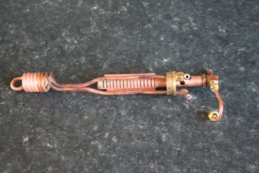

                            Ive asked Jason to tell me how to attach a picture – Ive made super heater but have not tried it yet

                                        HI PETE … just a thought about your transmitter … if it does not work very well with the Roundhouse valve, then are there any "rate switches" on the transmitter to adjust ? … it might be called something else on your transmitter … moving one of the 4 main sticks from one end to the other of its travel will move a servo by a certain amount … instead of the old method of adjusting linkages, the amount of servo travel can be set electronically on various transmitters … is there a switch, a potentiometer or a bit of electronic button pushing to set up, to match the required servo travel for each channel ? For the same amount of stick movement the servo will move less or more.
                                        Looking at the superheater … wow, that is a lot of surface area in the coil … that will certainly warm up the steam flowing through it … maybe more than you need ? Have you tried the assembly by using a spare piece of copper tube away from the boiler ? ( do not burn your fingers ) It may be worth double-checking that there is no tendency for the flame to head out backwards into the cab instead of up the smokebox and chimney … the coil could be causing quit a lot of obstruction to the gas flow … I would consider experimenting with smaller amounts of 1/8 tube inside the fire tube before I built everything into the cab … however, if it does work it would certainly be more economical than my loco.
