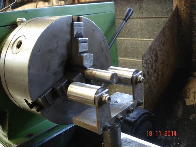

                                                #356925
                                                  Ah, missed that
                                                  M-Machine do some square bronze sections by the inch, Assuming you have a lathe then they can be machined down to the required overall size in your 4-jaw. But you could also do that from larger dia round stock in the 4-jaw if you don't have milling facilities
                                                  #356934
                                                  Ian S C
                                                    @iansc
                                                    Do you have a file? It's worth making a filing rest for mounting on the lathe, if you only have a small number of items to file square or hex, it's often quicker to file them up than to set up the milling machine if you had one.
                                                    Ian S C
                                                    #356956
                                                      Posted by Peter Russell 4 on 08/06/2018 10:28:15:
                                                      I don't have the facilities to machine square bar from round or hex
                                                      Put a section of bar crosswise in the 3-jaw chuck so its held by two jaws on one side and two on the other.
                                                      Use a spacer to make use it is parallel to the front of the chuck body, but slide the spacer out before machining.
                                                      Face the front of the bar flat.
                                                      Rotate the bar 90 degrees so the flat face is against the pair of jaws, set parallel and turn another flat.
                                                      Repeat twice more and you have a square bar.
                                                      Not the most accurate method, but works when you want some 'cosmetically' square bar in an emergency.
