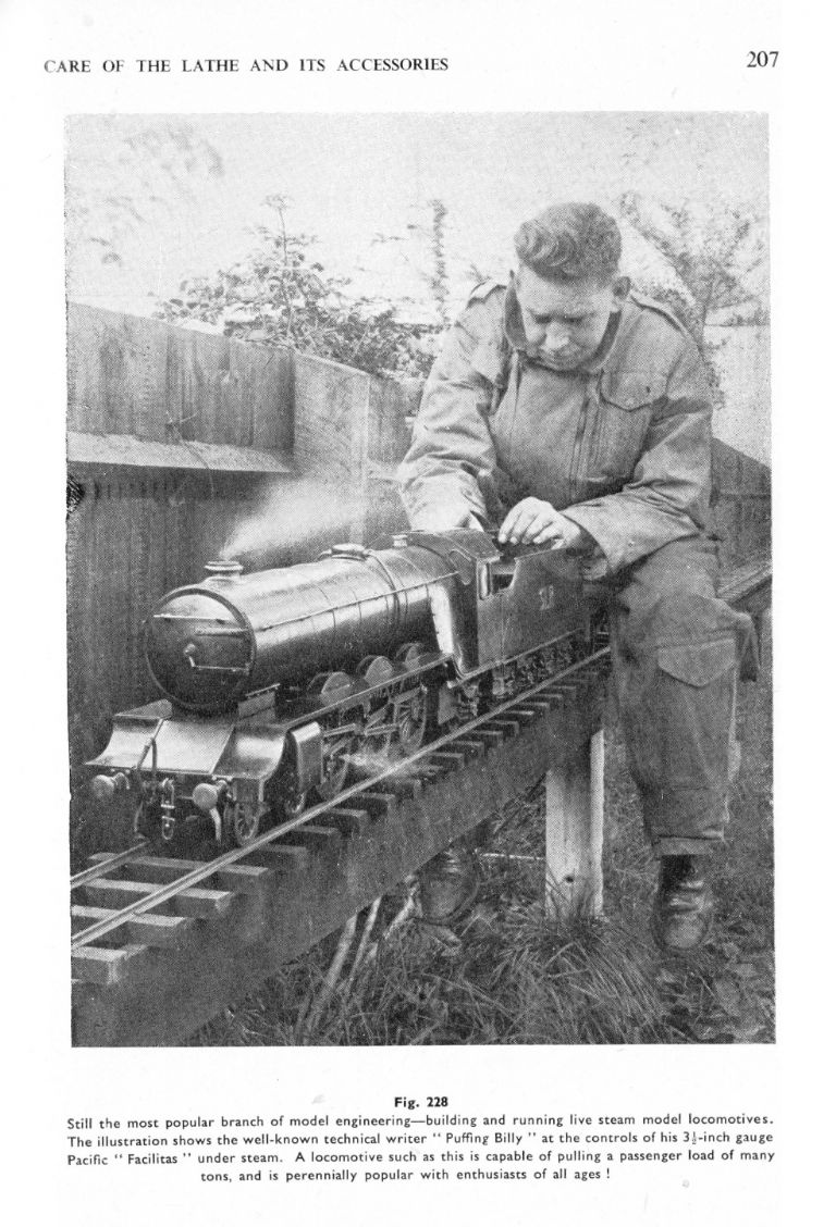

      hi was at my club this morning and have identified the engine i am building as a facilitas in 3.5 inch gauge would like to know if anyone has built this loco and what problems they have encounterd and any info would be appreciated thanks

        #545411
        Phil H1
          @philh196021
          Peter,
          I am quite familiar with many of the 3.5" gauge designs but I have never heard of Facilitas. Any photos?
          Phil H

              Simplex perhaps – translated into ??

                The only Facilitas I know of is a freelance 3.5" gauge Pacific built by H.E White in the 1950s. It was exhibited at the Midlands show maybe 5 years ago. I think it was a one-off, and no design was ever published.  There may though have been some descriptive articles in the M.E.

                  Keith Long
                    @keithlong89920
                    Hi All, if you go to the following website – https://modelengineeringwebsite.com/Midlands_2015_2.html – and have a look at the thumbnails of the photos that come up. The 4th down on the right hand side should show you what Facilitas looks like.

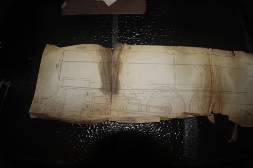

                        Peter Townsend 2
                          @petertownsend2
                          hi have taken pictures off the drawings i have they are at least 60 years sorry can some one tell me how to upload the photos

                            Luker
                              @luker
                              Hi Bill,
                              I had a look at this loco today, its a 3.5g 4-6-2 with Facilitas on the side of the engine on the GA. As Peter said the drawings are old with no sheet descriptions etc. It looks very similar to the picture you posted.
                              The frame, motion work, wheels and cylinders etc. have been completed for the most part and the boiler looks like it’s complete but not fitted. A couple of interesting points that had me stumped…
                              1. There is no wetheader in the smokebox(according to the boiler drawing), it looks like the steam line to the cylinders is from the steam dome?
                              2. There are 4 flues for superheaters, the boiler is rather large with a long barrel and wide firebox. Seems a little excessive.
                              3. Both the petycoat and chimney are internally parallel.
                              4. For a typical loco like this, are all the steam lines from a turret or should they be on the backhead?
                              I’m curious to know if anyone has seen this loco in steam. Looking very quickly at the proportions and drawings it looks like it will be one hell of a steamer…

                                Luker
                                  @luker
                                  Posted by br on 16/05/2021 18:50:51:
                                  Hi Luker
                                  Credit for the picture goes to Keith Long who provided the link. I just lifted it and posted.
                                  Fine looking engine
                                  As an aside, I do find mystery threads like this that get you digging, most interesting,
                                  bill
                                  thumbs up Thanks Keith.
                                  Yep I agree, and it should be a decent hauler. Its going to be an interesting build, I'm looking forward to see the loco take form.
                                  #545533
                                  Peter Townsend 2
                                    @petertownsend2
                                    hi have put the drawings up thanks to everyone

                                      If the picture of the completed one seems to match the drawings and parts you have the obvious step is to contact the Rugeley Power Station MES to get in touch with that owner.
                                      Come on, is there no member of that society who reads this forum?

                                        #545597

                                          #545599
                                          Ady1
                                            @ady1
                                            You should stick the drawings through a decent scanner to preserve them

                                            Phil H1
                                              @philh196021
                                              Peter,
                                              That looks like a really nice engine. There must be common parts available from other engine designs for wheels etc or do you already have castings?
                                              Are you trying to get a fresher set of drawings or can you work with those that you have. If the details are visible perhaps a print of a print might be worth considering?
                                              Phil H

                                                #545604
                                                Peter Townsend 2
                                                  @petertownsend2
                                                  Thanks I have the boiler and the tender 70 percent complete I have the wheels running on air my dad started building it in about the 1958
