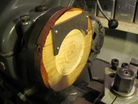

                                    I agree that the 4-jaw is more used Colin but there are certainly sometimes when a faceplate is very useful too.
                                    Like this bit for instance. With a faceplate, it was just.a simple turning (boring?) job – no milling required.
                                    Once I had the curve cut to the correct radius/size – I then cut the plate to final outside size, trimming off the screw holes in the process – with no tricky positioning of the material on the face-plate required. It was easier to do it in this order than the other way around. The wooden back plate protects the actual faceplate and just gets faced back as required and lasts a few go's before a new one is required… old fashioned technology but it's simple and works..
                                    There are also a few useful bits you can add to a faceplate very cheaply that make it a useful & convenient accessory…

                                    PS There are two parts being machined – so they both came out the same…
