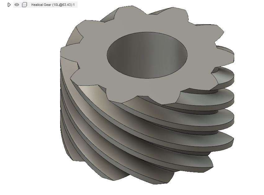

          As David says draw one tooth and use a helical cut. Depending on how accurate you want to draw it the sketch should be on a plane that is angled 90deg to the Helix angle otherwise you won’t get a true shape.
          The script in Alibre only does spur gears, F360 has “FM Gear” which will do helical. From the one below you can see that the profile along the edge of the gear is very different to the involute and that is why the sketch should be at an angle. This one was to be 3D printed as a pattern so needed to be accurate.800 gear pic

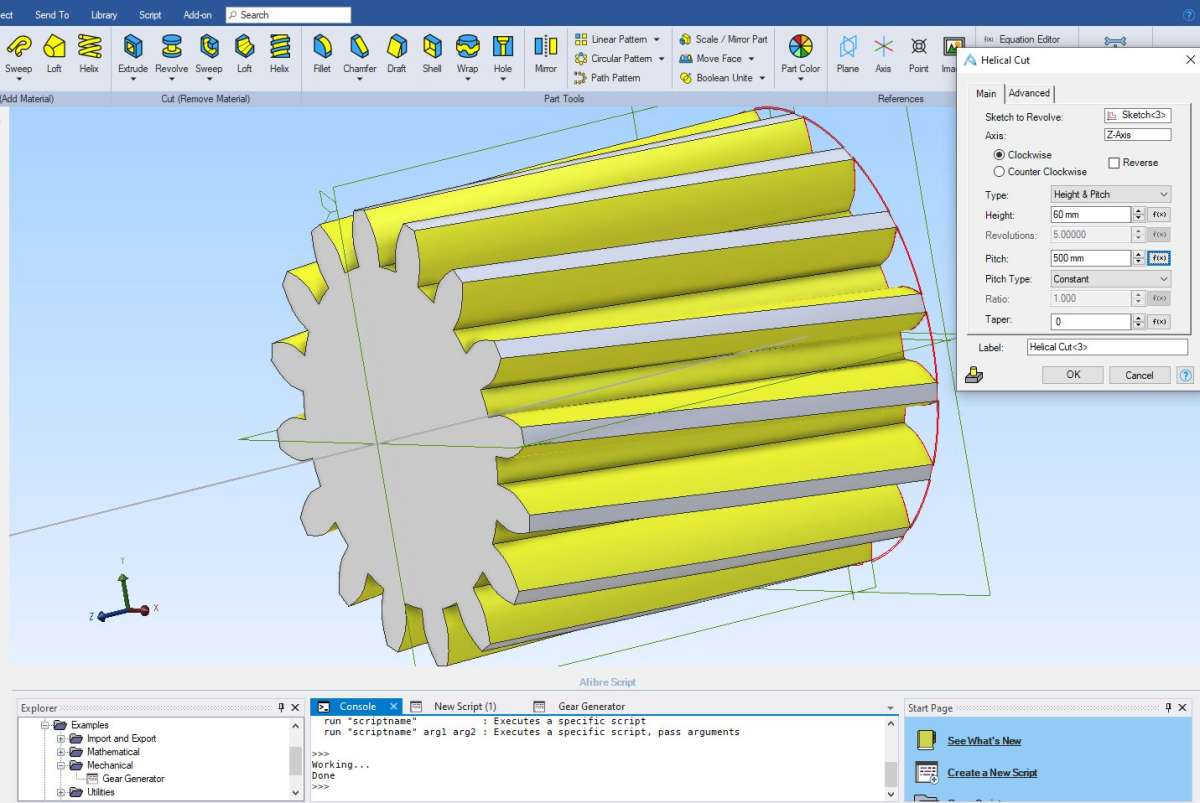

          #720087
            One half way option is to use Alibre’s gear script to get the profile, modify it slightly and then use as the sketch to apply the helical cut to, comes out like this, as 4deg there won’t be much change in the profile so it may do if it is just a gear for a thread indicator. ( not the exact pitch on my example you will need to work that out.)

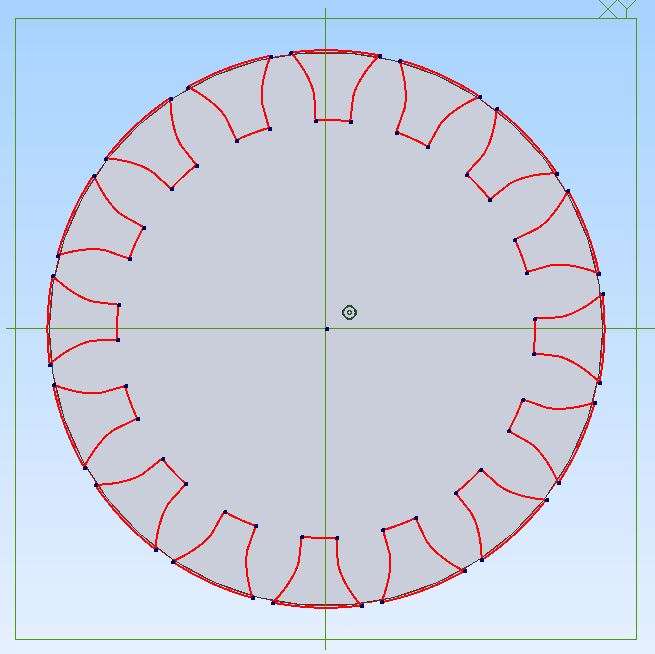

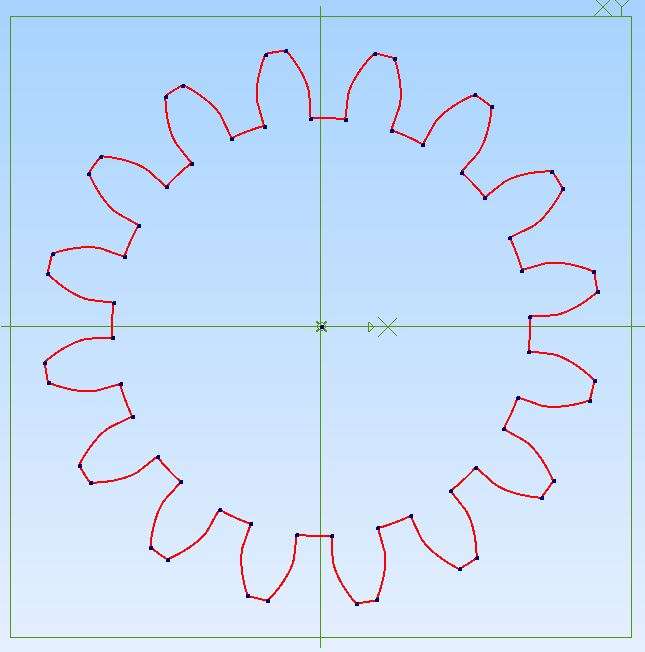

                    This is how I did that example in my earlier post.
                    Used teh gear Script in Alibre Pro to generate the gear which is does by extruding this profile.
                    profile 1
                    I then copied and modified that by trimming off the crests and joining the valleys. I tried it with just one tooth but it did not like that so did the lot.
                    profile 2
                    Finally did the helical cut with that profile. Ideally the profile should be pasted onto an angled plane and then you will get the true shape, more important if you have say a 90deg pair with both PCDs the same.
