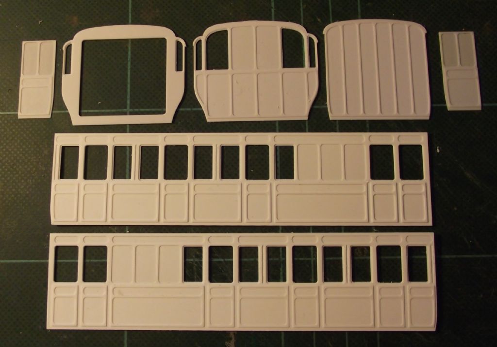

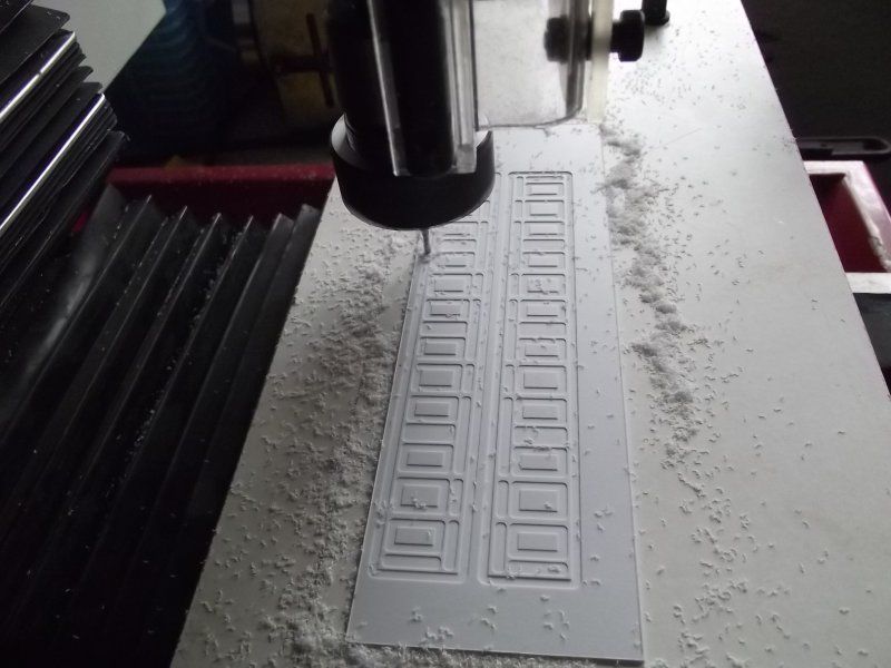

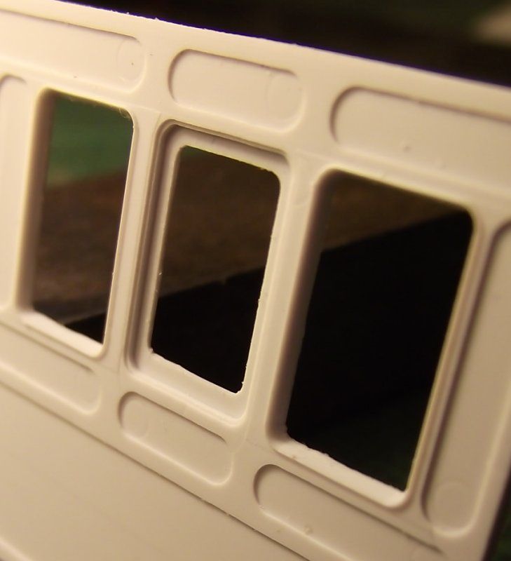

The results have been excellent.
I am looking for a desktop solution.

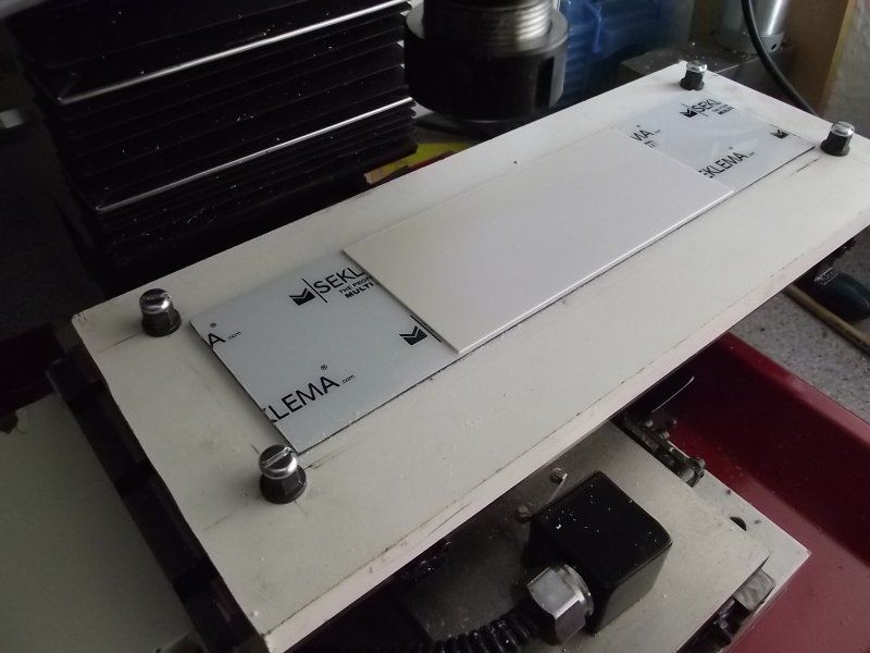

Hi Jim
The material you’re cutting is light and the forces you’re exerting on it are very low – so you don’t need a heavy table or support plate, just a rigid one. Why not try a piece of mdf with (if necessary) some bracing underneath or on the top around the edges to male the support plate. You should be able to put a decent straight edge along it with woodworking techniques or use a length of ali extrusion from on of the diy sheds and run that against a fence of sorts on your mill table. Cheap and pretty quick to do and you’ll see it the idea flies or whether it gives you other problems.
Keith

Edited By Jim Guthrie on 12/07/2011 23:11:44
I’ll do a bit more thinking about doing a peg setup using this material.
Edited By Jim Guthrie on 12/07/2011 23:41:48
It is my last 1mm cutter so I’ll order up another couple to try some alternates.
I’ve got a fourth axis rotary table here which was bought for my original intentions which hasn’t been used in anger as yet, and I would like to start work with it.
It won’t make any difference in plastic, but in metal it is a good idea to avoid step overs around 50%, as it hammers the cutter teeth and shortens tool life. Either less or more than 50% is fine.
