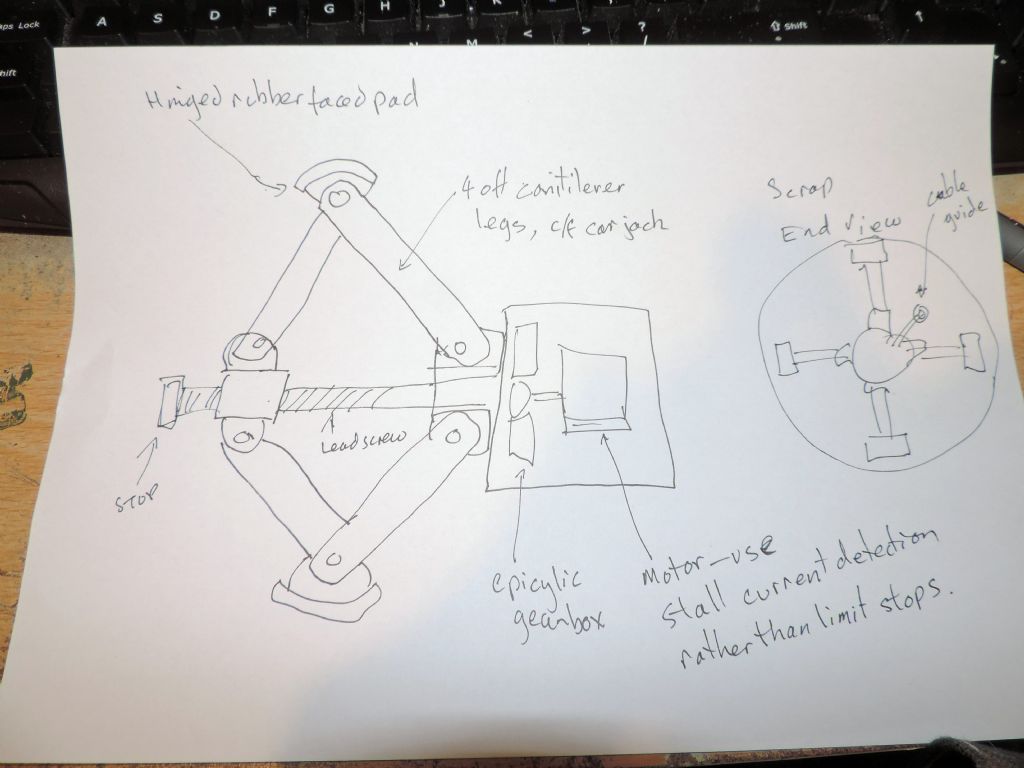

      Currently working on a expansion plate mechanism to secure the inside of a pipe. Decided on an a general design similar to this pulley expansion plate but instead driven by a motor however I've hit a wall with determining a secure enough means to halt the pistons movement once its adjusted to the pipe's walls.
      Any thoughts and suggestions would be very much appreciated.

          Drive the pink wheel with a worm gear which will not drive backwards? Just like Fordson Standard tractors.
          Or fit a brake unit on the drive shaft?  Like an overhead crane, for instance?

                A slipping clutch might meet your needs and prevent it locking up. I believe these are available and can be set to a given torque at which it slips; I suggest some research on those lines.
                A neat design by the way but I think the wear element in the slots and/or the pins might become a problem if it is used frequently.

                              The rotation angle appears to be about 15-20 degrees, so not much mechanical advantage to push the segments out and the pins in the slots are small so will not be able to withstand much of a load. The small contact area is small and wear will be a problem.
                              An alternative solution is to use a taperred pin to push the segments apart. This would also be self locking and could be pushed/pulled by a screw or air (or hydraulic) cylinder.
                              The outer segments will need a guide of some sorts to keep them aligned and not twist.

                                  Really appreciate the feedback from you all. Sorry for the late response to the thread. I’ve been caught up with assignments.
                                  Good guess Andrew, this is for an undergraduate design task for my final year group project. Couldn’t imagine anyone building this let alone in their home workshop.
                                  We’ve been tasked with creating a pipe inspection & repair robot. My task is to develop a stabiliser at the repair end of the robot. It’s main job is to secure the robot within the pipe during repair from vibration/shock/slip, hope that clears up what I said about securing the inside of the pipe. (can't seem to attach the image so here's a link https://i.imgur.com/Mvzr69f.png )
                                  Ideally the pipe should operate in dry and wet conditions (in case some water remains when it’s emptied). It’s arms should also expand to 690mm from 350mm.
                                  I initially thought to use a self locking (worm gear) motor with an encoder and it’s directional axis & plane corrected with a bevel gear. However, “not done it yet quite rightly pointed out that each piston won’t move independently, inhibiting the overall function entirely.
                                  Another thing I failed to give much consideration, is allowing enough room in the centre for cables and such to pass through.
                                  So basically I’m pretty screwed. With a hydraulic design however, how would that fit these requirements and overall design.

                                    Bit of lateral thinking.. how about an inflatable rubber bladder?

                                      A cone with 3 equally spaced half round grooves which legs sit, threaded up the centre, motor driven screw to pull cone towards motor thus expanding the legs to contact pipe walls giving 3 solid points of contact with spaces between legs for cables, hydraulic/ pneumatic services.
                                      Obviously needs more thought put in before put into practice i.e. insertion and retreival etc.

                                          … My task is to develop a stabiliser at the repair end of the robot. It’s main job is to secure the robot within the pipe during repair from vibration/shock/slip, hope that clears up what I said about securing the inside of the pipe.
                                          Would three radial struts suffice, I wonder question
                                          I see that George beat me to it.

                                            Make it like a pair of car jacks at 90 degrees to each other – or use 3 cantilevers perhaps instead of 4?

                                                I take it back,. Use a decent sized stepper and the gearbox is an unnecessary complication.

                                                  Why reinvent the wheel? Pipe bevelling machines have been doing this for years. They use three blocks with a tapered side pushed out by a tapered mandrel. This gives high mechanical advantage, self centring and simplicity. See the link below for examples of these machines.
