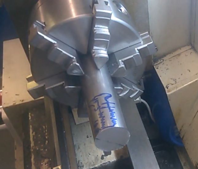

            John Hinkley
              @johnhinkley26699
              I bought a six-jaw Sanou chuck last year. It was probably from the same UK seller as yours Chris, by the sound of it. I was originally attracted by the price, too – £99 inclusive of VAT and delivery. Its only downside is that it will not grip very small or very large diameter workpieces, for which I swap it out for either a 3- or 4-jaw, but nevertheless spends 99% of the time mounted on my lathe. Can't fault the finish or accuracy within the limits of my measuring equipment.
              Sanou six-jaw chuck

                                  I've just nipped out to the workshop and tried a file on my six-jaw chuck. Result: the file skids off without leaving a mark, I'm relieved to say. So, my assumption is that, yes, they are hardened, or at least, mine are.
                                  You can come out from beneath the parapet now.

                                        My understanding is that six-jaw chucks are more suitable for holding thin-walled tube, having less crushing force applied per jaw for a given grip. That's not what I got it for, though. I just thought it looked pretty cool, to use the modern idiom, and it holds the size of material that I generally use and hopefully more accurately. But then I didn't know any better. Like I've said before in many posts, I'm not a trained engineer, just a bloke who potters about in a "shed". "Playing" my wife says.
