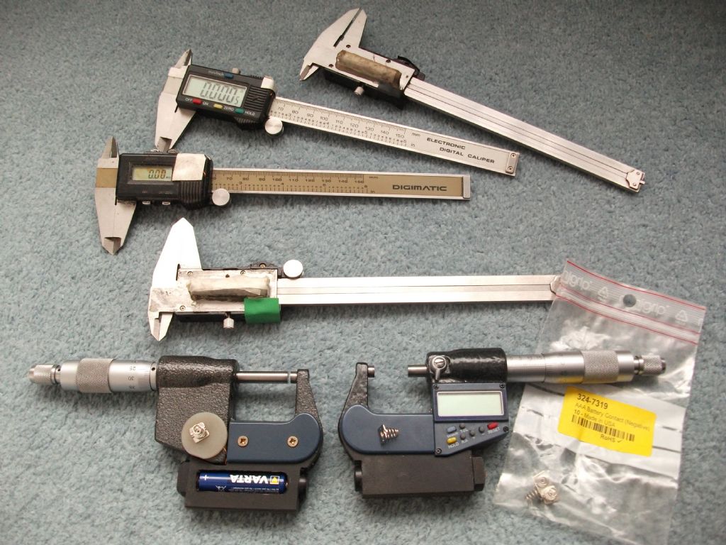

                                                John P
                                                  @johnp77052
                                                  I gave up using these caliper batteries some while ago they all suffer the same
                                                  fate ,flashing display dim readings battery low warning and it seems much
                                                  the same if you use cheap or dear batteries.
                                                  They all use AAA batteries now , a dummy battery , 2 bits of brass and a fibre
                                                  washer some enamelled copper wire soldered to an AAA battery
                                                  wrapped in masking tape and stuck on the back with a hot glue gun.
                                                  The micrometers use these contacts from RS components.
                                                  I leave them turned on all of the time ,most likely will last until the
                                                  sun goes dim.
                                                  #467927
                                                    Posted by John Pace on 29/04/2020 17:52:02:
                                                    That’s surprising, John
                                                    I mentioned earlier, that the battery in my Mitutoyo lasted about three years
                                                    … looking back at purchase dates, it’s probably longer than that.
