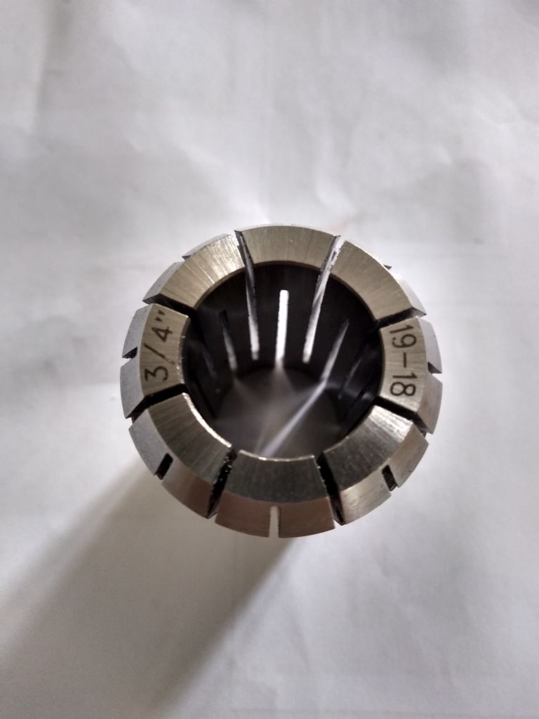

                  I have a Vertex set of metric ER32 collets. They are more expensive than the run of the mill Chinese collets and are supposed to be of better quality. The 19-18 collet is also marked 3/4" so they are not worried about the extra 0.05mm. Opening it up that extra small amount will stress the collet less than closing down a 20mm collet almost a full millimetre but in theory that should be okay too.

                        Tried Gloster Tooling as suggested, but nothing in their Ebay store. Thought I'd ask them anyway, and I'm awaiting an e-mail reply. As it's for an End Mill, I'm tempted to try a 19mm collet.
                        As Andrew say's, opening up 0.05mm will probably put less strain on the collet than closing it down 1.0mm.

                              Here is the evidence. It's a nice sliding fit on 3/4" stock.

                                  Thank you Andrew, where did you get it from?
                                  #543258
                                  Andrew Moyes 1
                                    @andrewmoyes1
                                    Bo'sun – Rotagrip in Birmingham sell the Vertex collets.
