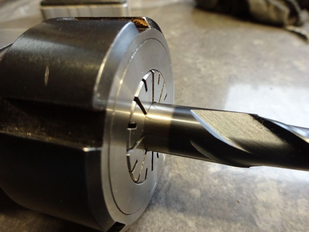

        Been a while since I've had time for my wee workshop ,so today I decided I would make the er32 chuck I've wanted for a while now ,so I used a chunk of stainless I had ,probably not ideal but it's what I had . It's not perfect but it's accurate where it matters . I put a tenths indicator on the inside of the collet taper and it barely moved which kinda surprised me a bit 😁 but I'll take it . The only negative is the cheapo collet set I bought have 0.002 run out ,I tested using three different sized carbide End mills in the collects. .

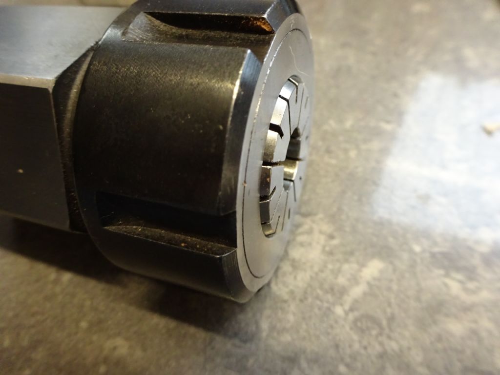

              Hi Sean
              Have you modified the collet closing nut in some way as all of my ER collet nuts wrap around the front face of the collet which hinders working close to the collet face.
              Does the nut still engage the slot in the collet to assist removal ?

                  Or more likely the nut has just been tightened down a bit on the empty collet which makes it stick out.
                  Same 12mm collet one with a cutter the other tightened down a bit by hand with nothing in it
                  Edited By JasonB on 11/11/2018 11:04:59

                      Emgee I’ve not made any alterations to the nut ,the release of the collet works the same as the original. It pops out like it should 😉 . The collet is a beautiful fit .

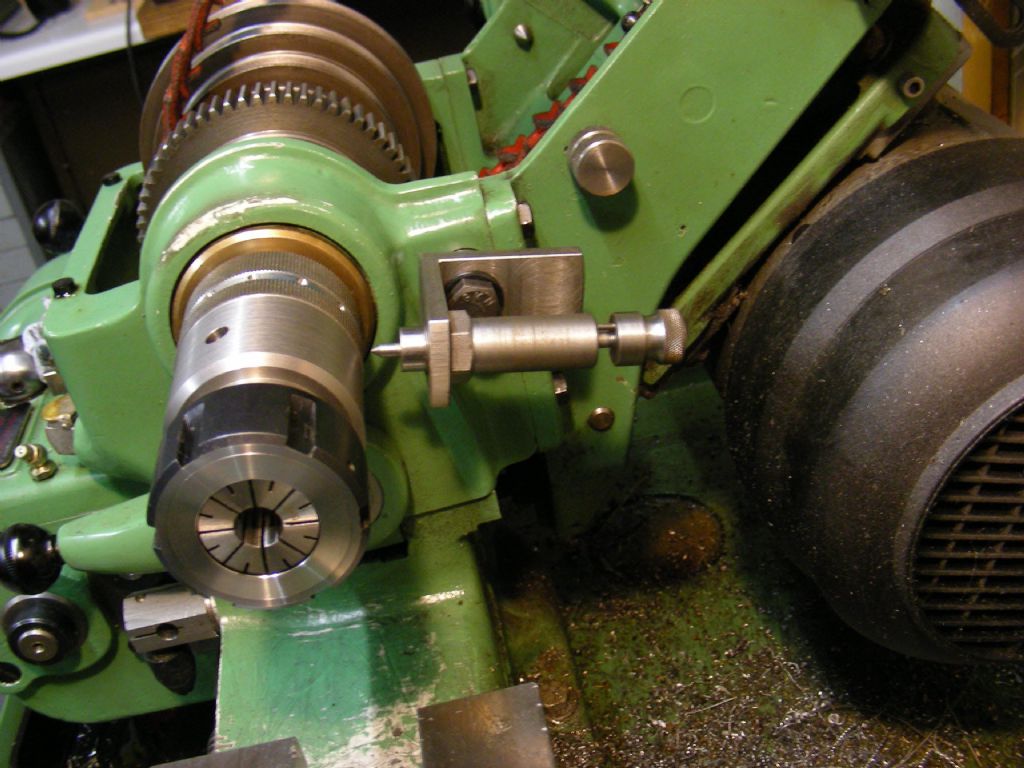

                        sean logie:
                        For 'tis a jolly good lathe!
                        Here is my shop-made version showing also a GHT-inspired dividing attachment for use with milling and drilling spindle:
                        Not obvious in the photo but I have made the chuck body long enough to be able to work up close despite the gap.

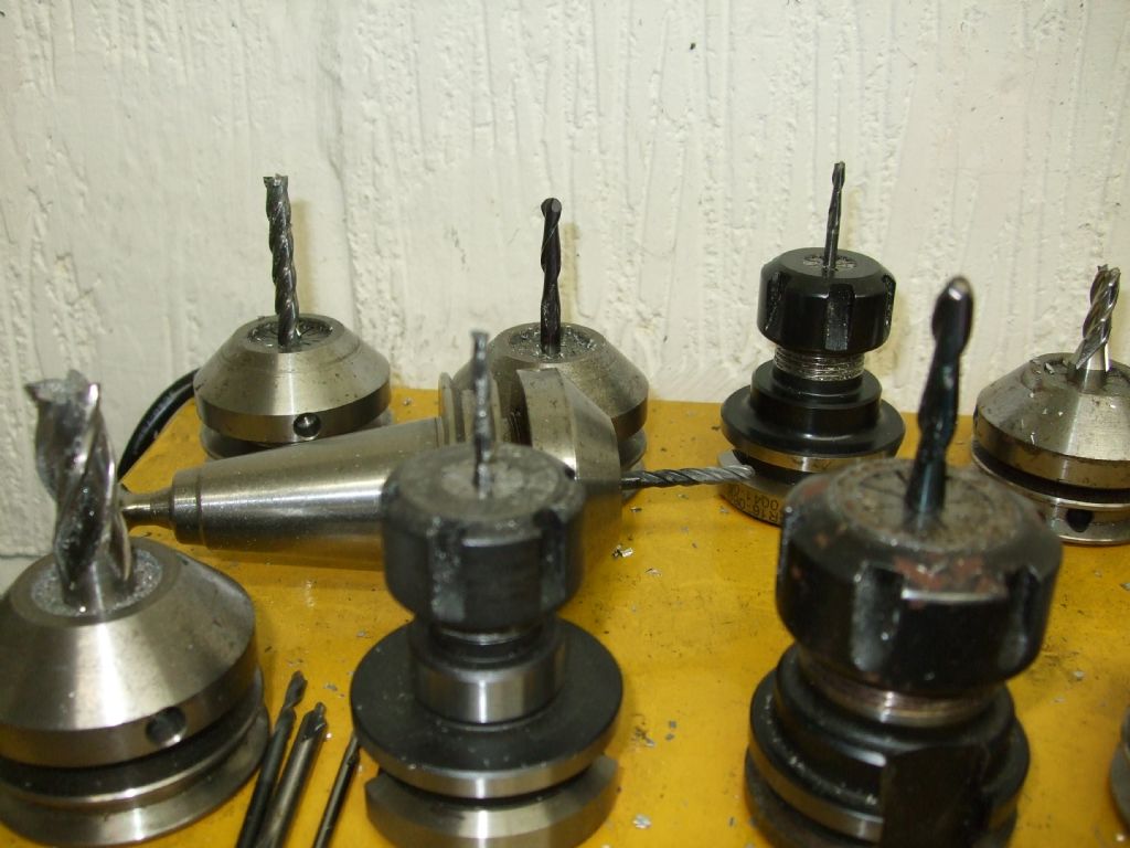

                                      After checking further all Emco made ER25 collet chucks I use have the front of the nut extended to always be about 2mm in front of the collet face .
                                      The other makes including Schaublin (RH front in pic) do allow almost flush facing if in the lathe.
