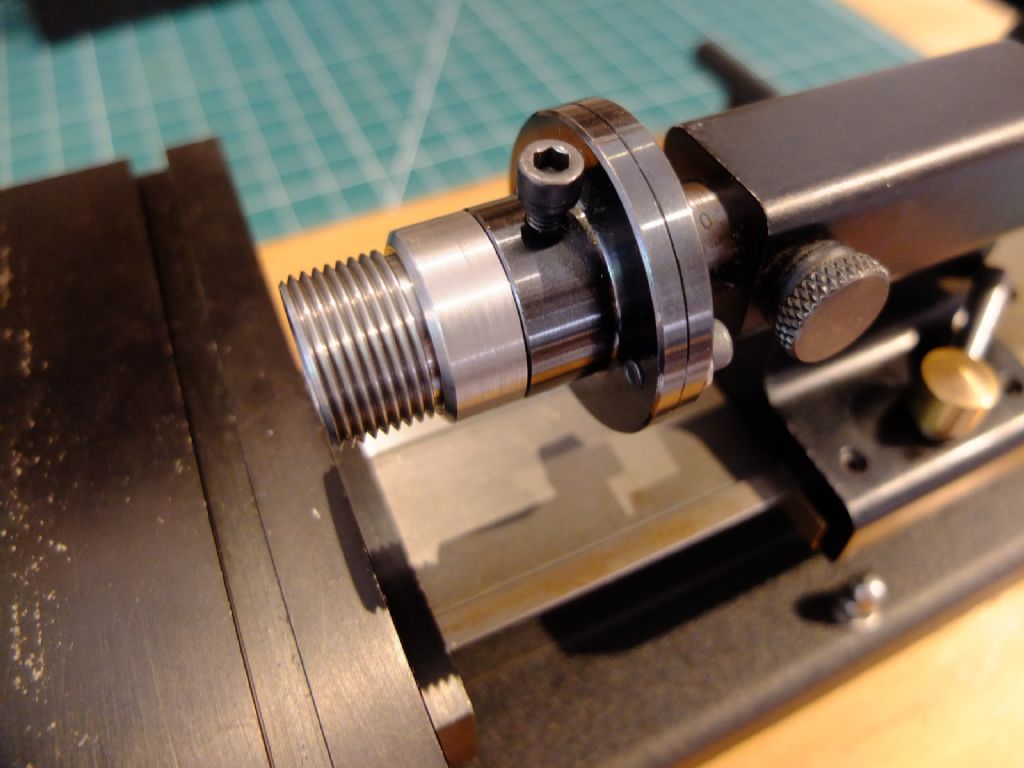

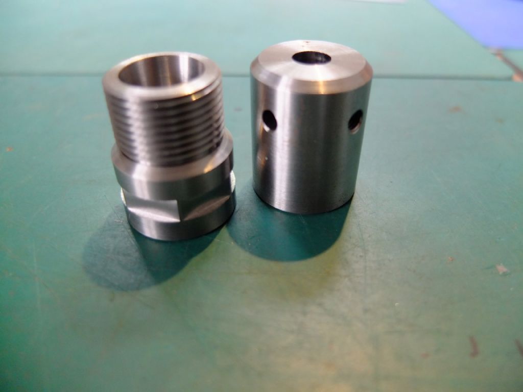

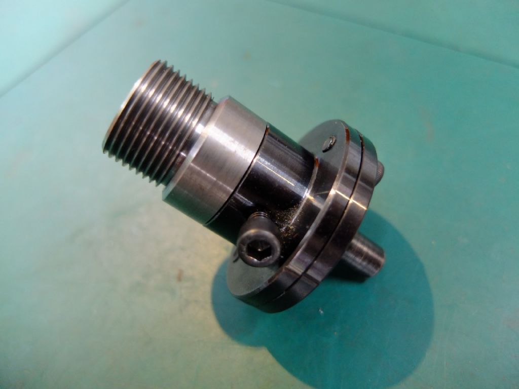

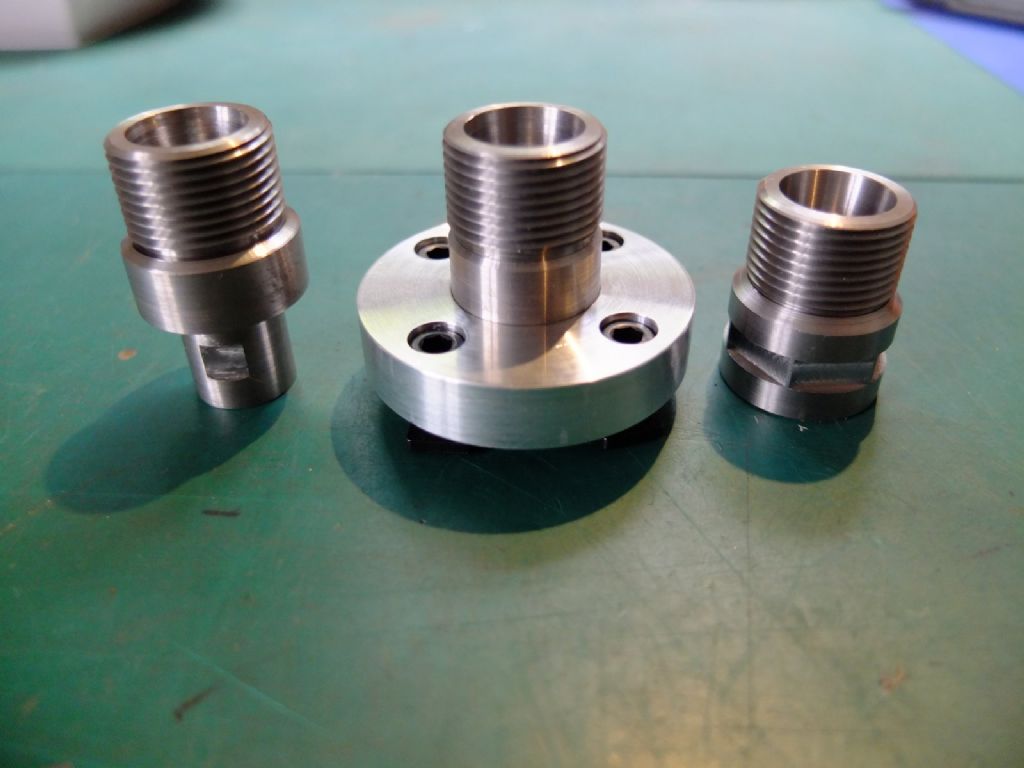

      From left to right, tailstock toolholder, rotary table workholder and lathe/mill headstock work/toolholder.

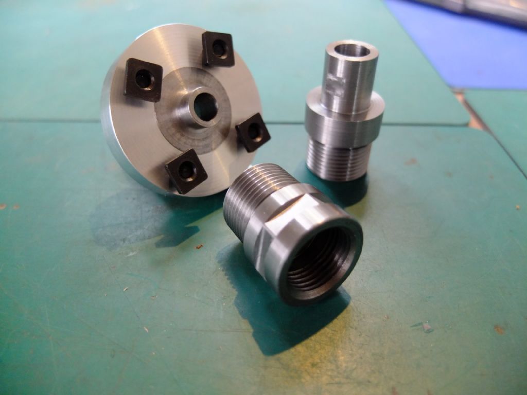

      The underside.
      Making these was about the limit my Sherline lathe could manage.
      There is no back gear on a Sherline and you have to wind the spindle by hand when single pointing. The M22 x 1.5 thread took around 80 passes for each one. After around 60% in, DoC is 0.01 mm per pass plus a spring cut in every 4 passes. Lovely clean snug thread though.
      Also drilling the 8mm x 40mm deep thru holes prior to boring put a real strain on the motor.
      Steve
      Edited By Steve Crow on 30/06/2023 18:55:44

            For the headstock adaptor I didn't have a tool to single point the internal 3/4" x 16 tpi thread so I modified a Sherline 10mm end mill holder similar to the 8mm next to it below.
            First I had to plug the holes. I made mild steel plugs for the tommy bar holes, hammer tight fit plus loctite.
            I single pointed a very snug grub screw for the threaded hole (1/4" UNF), screwed in with loctite and then filed off the slotted end. After turning and boring to final diameters, they were barely visible.

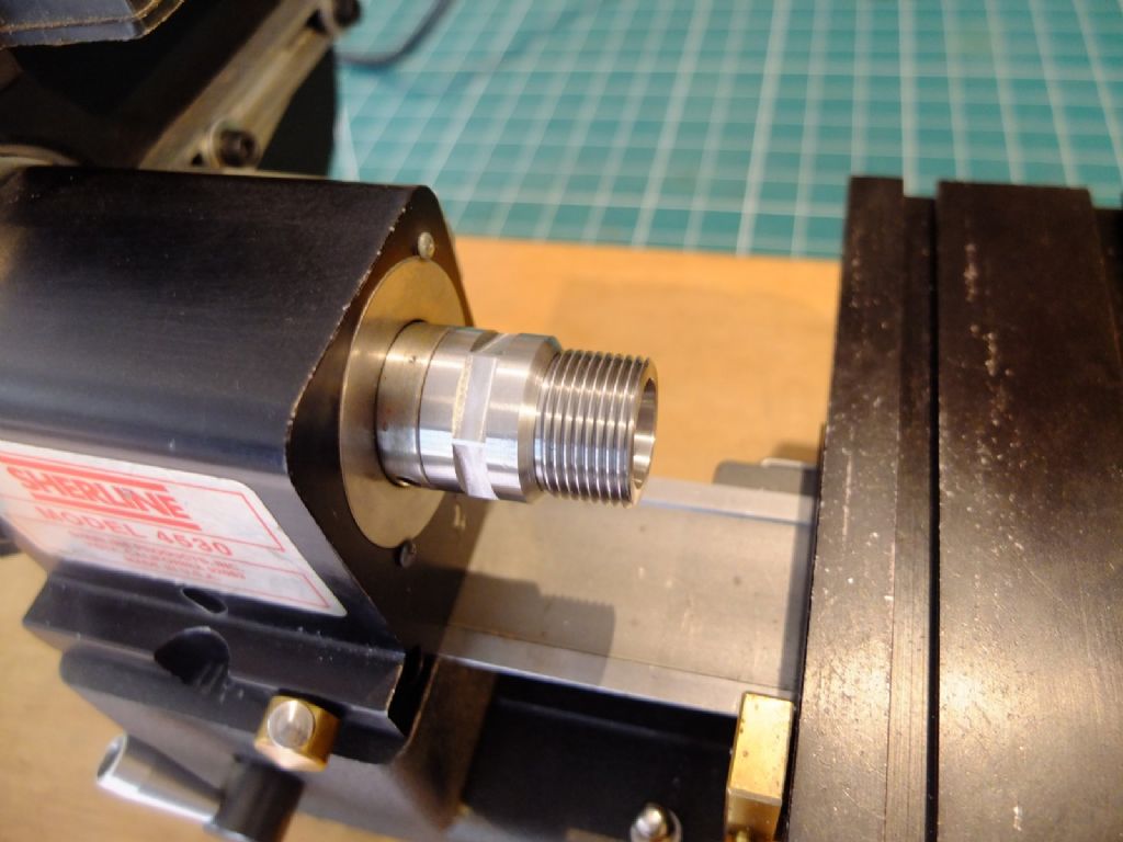

            Here it is on the headstock. It's milled for 22m a/f spanner.
            I bored the taper in situ so there is now just a twitch of runout.
            I can also fit it to the rotary table using a chuck adaptor. Not sure about the runout yet though.
            I've tried to make the most compact and simple adaptor possible and also retain the full thru spindle diameter (10mm). This is about as short as you can make it (30mm) before the collet fouls the spindle. I've already used it for drilling on the mill. Gives me much more headroom than a Jacob's chuck.

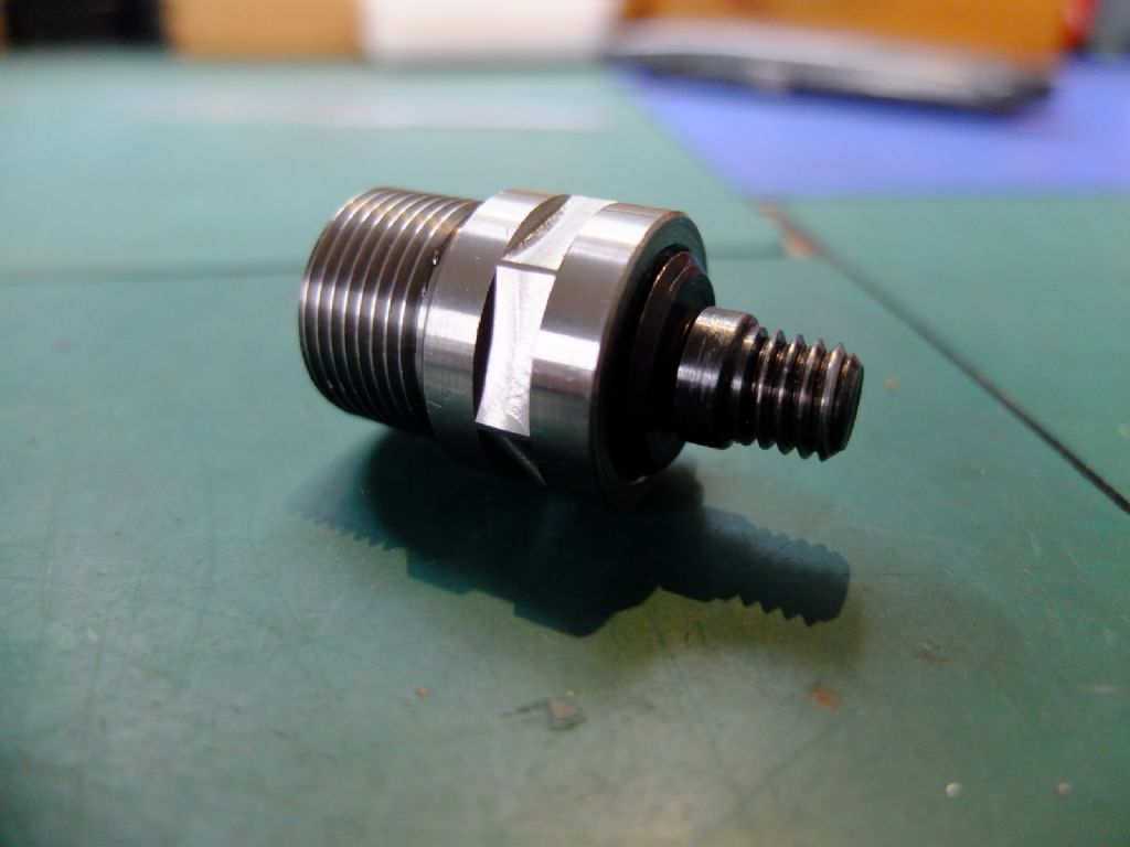

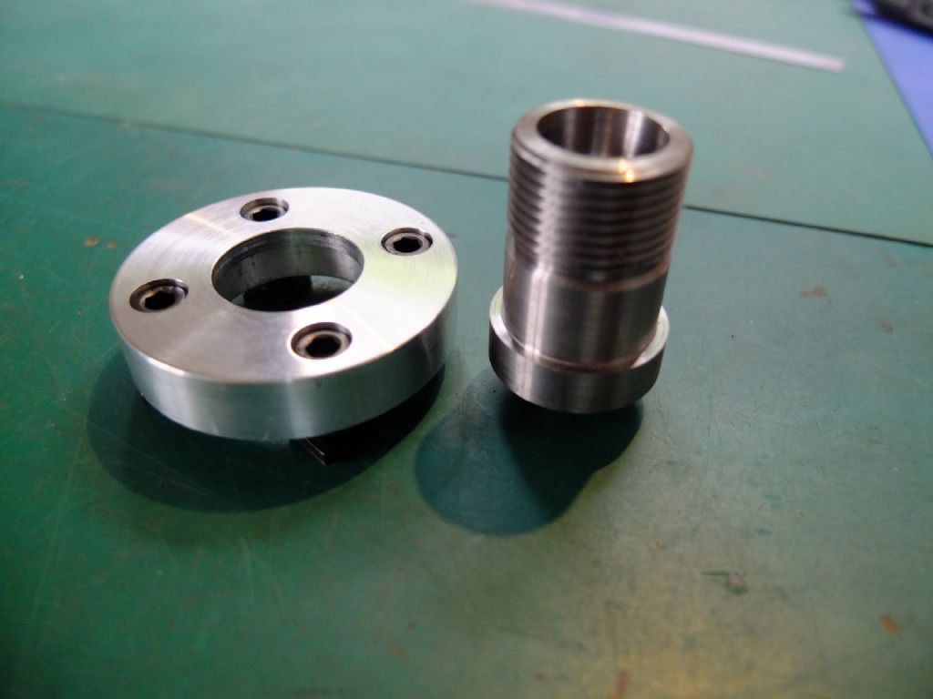

                    The tailstock chuck was the most straight forward to make. It started as a 40mm length of 1" EN1A.
                    Concentricity wasn't critical on this one as it fits in an adjustable tool holder. I did my best though.
                    Steve
                    Edited By Steve Crow on 01/07/2023 10:18:27

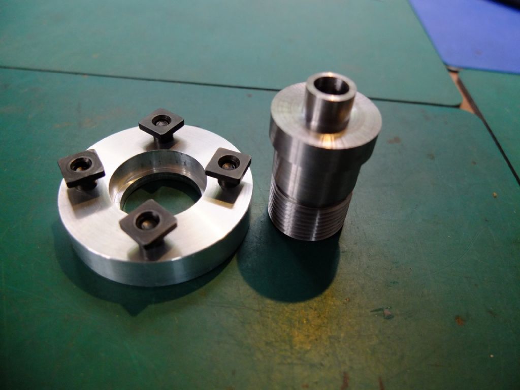

                      I had to make the rotary table adaptor in two parts. The flange was made from a 50mm x 10mm aluminium disc. It's been drilled and counterbored to accept 4 x Sherline T-nuts.
                      The spigot on the bottom is a few hundredths smaller than the table centre bore with a thru hole of 8mm.
                      When mounted, a couple of minutes with a clock and a small nylon hammer and you can just about eliminate any runout.
                      By the way, I'm using ball bearing collet nuts for all the adaptors.
                      Steve

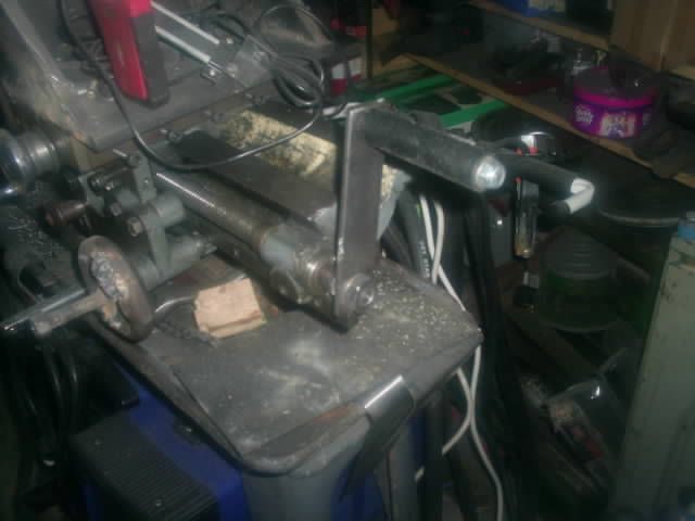

                          I sometimes use those battery drills for "turning things" jobs to save my dodgy hands and wrists
                          18v 20v drills, brushless are best with loadsa torque
                          Used them mainly as power feeds on my milling setup, good slow speed torque control
                          Put an adapter on the back of the headstock spindle… and plug a drill on
                          You're quite a capable guy, just a thought to try and make life easier
                          The best thing of all is a hand crank setup
