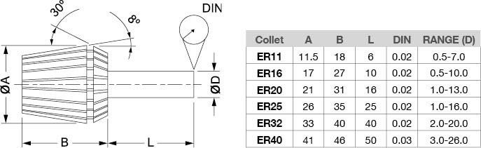

              Have you measured the angles? 30 degree front and 8 degree back. If not the same why not make your own holder to suit? Sounds as if an ER25 nut could be used as a closure if the front angle is 30 degree. Seems a pity to waste such a gift horse and if they are SKF manufactured they would/should be pretty good.

                    If you have some er32 collets, you could compare them against the mystery ones, all er collets look similar and their angles match.

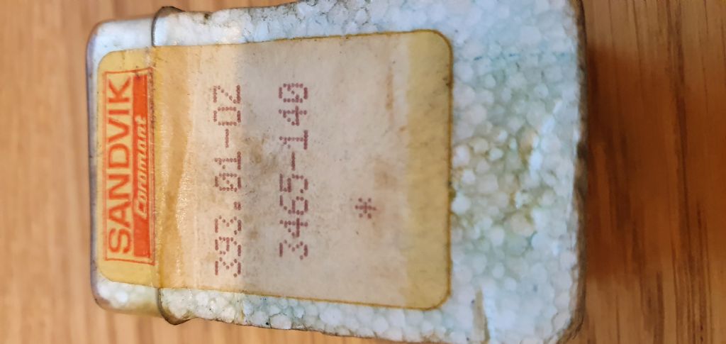

                        Could you have a look inside the collet, specifically at the back.
                        These ones:
                        https://www.sandvik.coromant.com/en-gb/products/pages/productdetails.aspx?c=393.14-20%20d060x049
                        are for tapping and the extra length may possibly be for the square at the end.

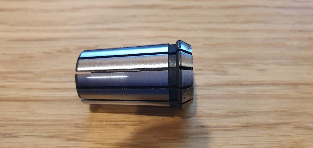

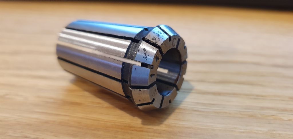

                          The bore through the collet is round. Here are some photos,
                          20201211_164926.jpg20201211_164916.jpg20201211_165027.jpg the part number yields v little info

                              They are definitely not er collets.

                                  The characters after the dash on the first line of the part number are the LETTERS 'O' (for orange) and 'Z' (for zebra).
                                  If you put that part of the part number into Google, you get to:
                                  https://www.sandvik.coromant.com/en-gb/products/pages/productdetails.aspx?c=393.01-oz%201825
                                  which gives a reference of DIN6388.
                                  They are likely OZ collets.

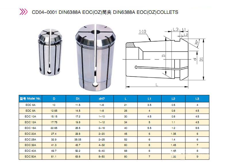

                                      I think they could be EOC16 collets, the size looks right. **LINK**
                                      Din 6388 is the classification, as DC31k says.

                                        Big difference in the back taper angle for the EOC collet – 2.52 degree versus 8 degree for an ER – they must be high precision collets and are worthy of being used – even if you have to make a collet holder. As I said in my earlier post if the front angle is 30 degree then an ER25 nut may be a nailed on bet for a closure nut.

                                            I think we have a winner!
                                            The Spec says its a EOC16A collet, and the front angle is 30° laugh
