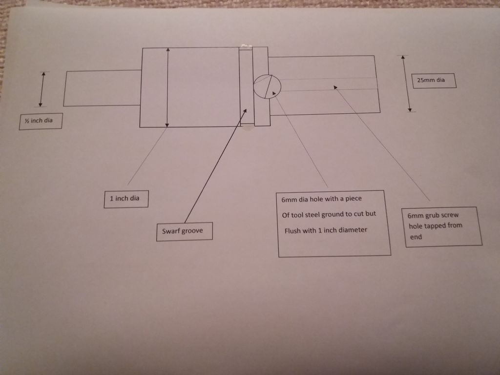

            The clamp fit to the 1 inch bar has to be good as I will be adjusting and moving it a lot. I’ve tried files, abrasives and flap wheels on previous clamps and it seems impossible achieve a good parallel hole that grips on its entire surface. It’s slow tedious work as well.
            My Lathe is an 8mm with no cross slide and my drill has a capacity of 1/4 inch so machining is out of the question.
            I hope this clarifies what I actually need and the limits of my workshop.

                  #333808
                    Posted by Steve Crow on 24/12/2017 15:20:35:
                    Thank you Michael but I'm finding it hard to visualize the set up you described. Perhaps you could clarify a little or post a sketch?
                    Steve,
                    Your junk box may differ from mine, but; what I would do is take a long 5/16" caphead screw and cut off the threaded portion leaving the plain shank and the head.
                    Cross-drill the head 1/8" diameter, and insert the shank of a broken HSS drill or milling cutter … fix this by silver soldering, or with Loctite 638.
                    Grind the inserted bit to make a single point cutter which sweeps a 1/2" radius at the tip
                    … remember to check the actual diameter of the screw shank and measure accordingly.
                    This is your boring bar.
                    Centre the 25mm hole on the drill axis and clamp it in place [with suitable packing/spacers]
                    Then just operate the drilling machine normally.
                    I hope that makes sense … Domestic duties are calling
                    #333813
                      This is the sort of thing Michael is describing. As you only have 1/4" drill capacity you may need to come down to an M6 or 1/4" cap head bolt or could reduce part of an 8mm or 10mm bar down to 6mm in your lathe. If you make from bar then set the cross hole up from the end a bit more and drill and tap for a grub screw to hold the cutter then it is more easily adjusted.

                          Les Jones 1
                            @lesjones1
                            I don't think the bearing on a normal drilling machine wil be good enough for that method to work.

                            #333829
                            David George 1
                              @davidgeorge1
                              I have used a similar boring bar with no problem just needs a guide nose to locate bar.
                              Use plenty of lubrication and run slowly with job clamped well.
                              David

                                    #334244
                                    Steve Crow
                                      @stevecrow46066
                                      Thanks again for all the help. I like the boring bar / fly cutter idea but I'm dubious about being able to centre the piece – I'm only taking 0.2mm from each side. The bar with the guide nose and the reamer are all too big for me to make with my limited workshop. All my stock metal and stuff in the scrap box is all smaller than 1/4".
