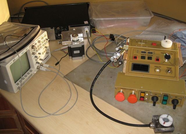

      The intent is to create a microprocessor controlled box that can process electronics threading on any metric or imperial pitch, in an automated way, and provide simple, quiet Feed control for normal auto feed machining operations.
      Basically there is a control panel that allows selection of a thread pitch/type, a way of defining the start and end points of the thread ( right or left hand thread as well) , left to right or right to left cuts, and then running the cut process automatically from start the end of thread, stopping the carriage feed and the spindle ( on a ticky, aided by the VFD on the spindle motor) , retract tool, press rewind and the tool goes to the start, put on cut, press start and the process repeats…
      A largish stepper is fitted to the main leadscrew, which is disconnected from the Norton screwcutting box by removing the shearpin.
      I have tried to keep it simple – it is too easy to add 'features' which in my opinion are a waste of time. Adding another stepper to the cross feed will allow machining of balls ( handles), tapers, etc, but for me the complexity is appalling, One does such work very rarely, and this gets in the way of the machine operation – with so many feature, buttons, operational methods, etc, it takes a half hour or more just to remember how to do something basic, and that defeats the whole purpose. If it takes longer to re-discover the operational process than it would take to cut a thread on a basic mechanical norton box lathe, then your have lost the plot… I would venture to say that ALL the ELS systems out there today are in that place – FAR to complex, trying to be a CNC substitute, but not really, so cannot do real CNC, and too painful to use for basic jobs.
      Some PICS of the start of the project follow…

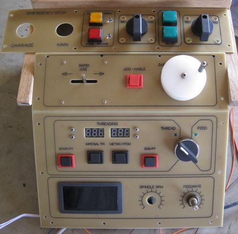

      There is a Main and a Sub control panel – the Main is above the Headstock, with the Sub below the Swarf tray, left of the operator, at left pelvis height – main start stop buttons, etc…
      Upper image is Sub panel, lower is Main, on the Bench in the Lab for SW testing.
      CLoser view of Main Panel ( forgive the flash-back..) Managing setup selections.
      And the Sub Control panel, managing actual Machining.

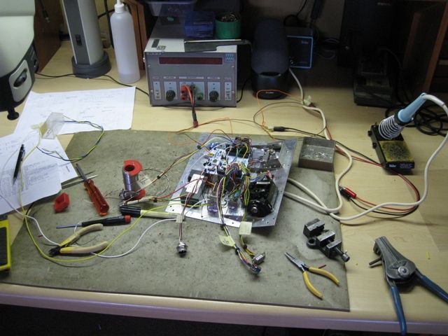

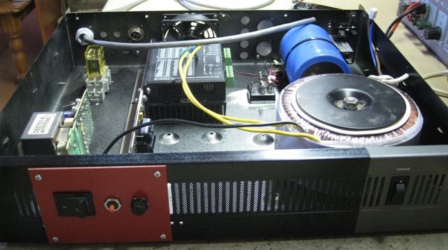

          The system Power supply and Stepper Motor Driver module.
          Housed in a re-purposed housing taken from a Phonic 100watt stereo Audio amplifier that had let the smoke out…The Toroidal mains transformer was ok, and suited this job just fine!
          Testing the SW on the bench…

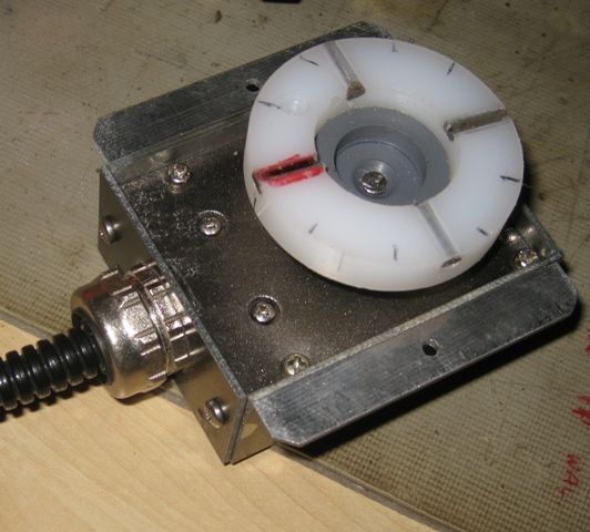

          The main spindle magnetically coupled Rotary encoder – DIY from a 1024 ppr encoder wheel from an old Calcomp plotter…Provides 1024 ppr Quadrature output with a 1PPR reference pulse – essential for the start of thread point – acts in the same way as the single tooth dog-clutch in a mechanical threading clutch ( Meek, et-al..)
          The encoder unit fits with two M3 screws on the rear cover of the lathe, lined up with the spindle , and the 4 rare earth magnets in the polyprop disc line up with mating magnets in a disc fitted to the main spindle – there is not enough space to fit the unit inside the cover with belts or gear drive, etc. This has a limitation – I cannot thread a rod that has to protrude past the rear of the spindle…But I could fit the shear pin back and do it manually! 99% of my playtime has not involved threading work that long…
