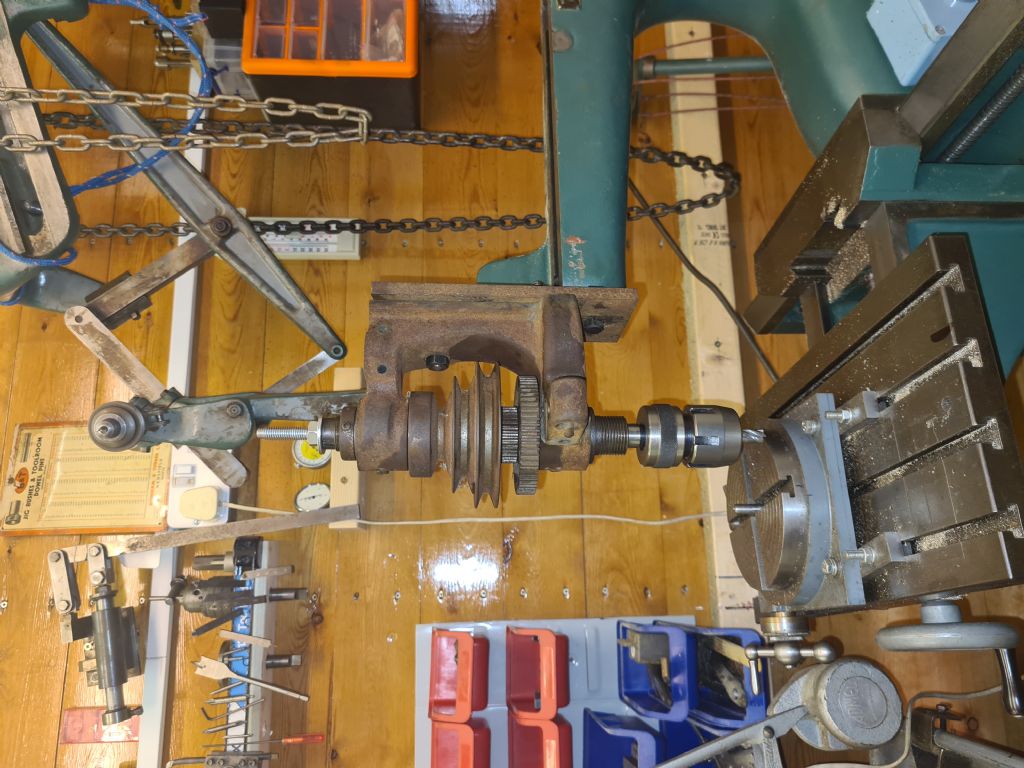

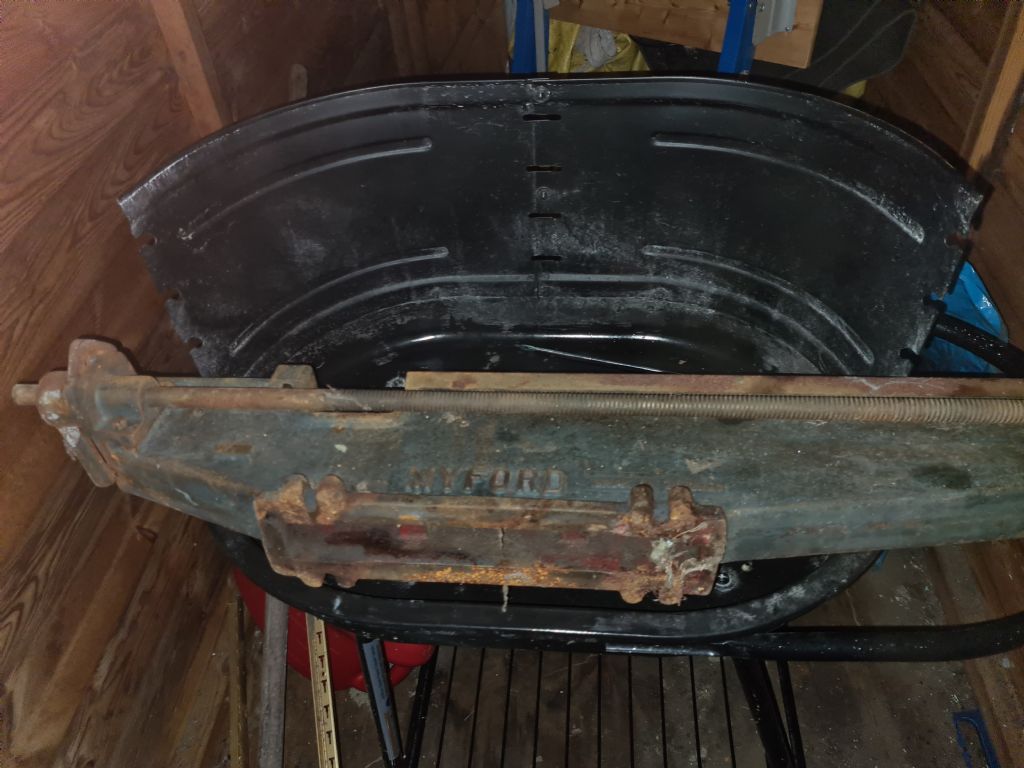

            For some time I've been thinking of adding a full size milling spindle to my Taylor Hobson CX engraving machine.
            I was going to make my own spindle but yesterday I rediscovered a rusty Myford Lathe bed with headstock in the deep dark recesses of my garden shed.
            A few hours work & the headstock appears viable – bearingd & tapet socket protectef by old oil – 😁result 😁
            Another few hours & a simple bracket show that it will fit & in the lashed up shown gives a useable surface area of 6" x 18" ish with up to 6" depth.
            Does the panel think that it's a viable project?

              I agree that rigidity will be a problem, but cutters up to 6mm would probably be usable. A bracket across the gooseneck would help.

                Hi Clive,
                See post above – just a lash up to prove the concept.
                I'm a clockmaker so intended for light duties but yes….. I'd look at fitting it to an angle plate on top of the machine. 😊

                            Robert Atkinson 2
                              @robertatkinson2
                              Hi Adrian,
                              If you want to help another Forum member, John is looking for a bullwheel and you won't need that one See:
                              https://www.model-engineer.co.uk/forums/postings.asp?th=170138
                              Robert G8RPI.
                              #517508
                              old mart
                                @oldmart
                                I wondered about that bullwheel, but it may be from a newer lathe than an ML4.

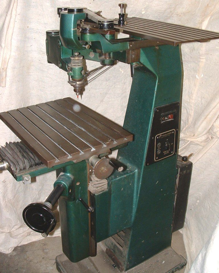

                                Nigel Graham 2
                                  @nigelgraham2
                                  The blurb Taylor-Hobson supplied with their larger machines (such as one I used at work years ago) suggested using them as copy-millers and even lightweight vertical mills for fine work. The latter entailed mounting a steady-bar between cutter-head and machine frame. Indeed we did use ours for engraving out the D-connector holes as well as labelling the aluminium panels for the electronic equipment the company made.
                                  Nevertheless converting one to a vertical mill seems a bit chancy, but it should be OK used within its structural limits and without the pantograph, such as for clock-making.
                                  I have what I think is the same model, awaiting a bit of work, principally finding / making a cutter collet and obtaining suitable belt; but I bought it purely for engraving. A proper set of copy would be handy but I do have a rotary copy-wheel so all is not lost – just one character at a time and due care for proportional spacing..
                                    I'm pretty sure it is from a mid to late ML1/2/3/4. It's not a a ML7 or 10 for certain.

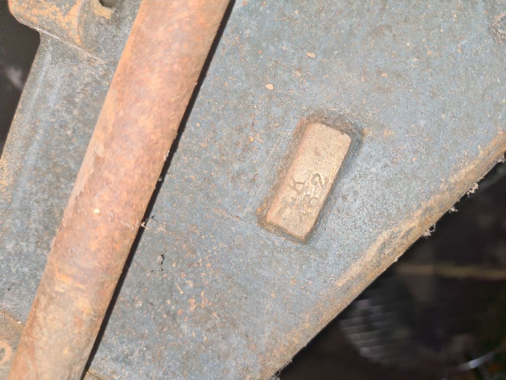

                                      Adrian Downes
                                        @adriandownes83818
                                        Hi Robert,
                                        Would the serial number help identifying it?
                                        I'm pretty sure it's on the bed somewhere.

                                          Adrian Downes
                                            @adriandownes83818
                                            Robert,
                                            Serial number is LK 462

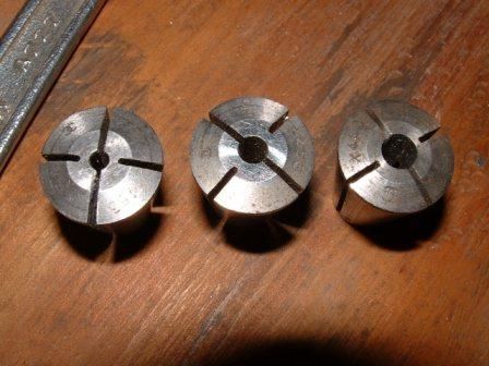

                                              Emgee
                                                @emgee
                                                I had a Taylor Hobson Model K engraver and light milling machine, it had a Tru-taper chuck for the special engraving cutters, this was held in the spindle with a 3/8" collet. I used it for engraving control panel labels and other notices in 2 and 3 ply engraving materials.
                                                To use as a light milling machine the Tru-taper was removed so the collets could be used, they were fixed size 1/8, 1/4 and 3/8", there was as Nigel says a bar fitted to the spindle in place of the depth stop and secured to the column by a 3/8" bolt. Height adjustment was with the knee handle.
                                                A good size working envelope and with small cutters running at high speeds milling of brass, aluminium and with less rpm soft plastics was possible.
                                                Emgee
