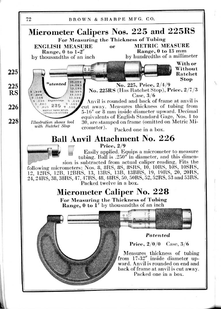

      I am hoping someone on the other side of the pond could help me. I purchased a vintage Brown and Sharpe micrometer #225 with the words "English Gage" and some numbers on the frame. They start with 1.300, 2.284, 3.259, and go up to 30.012. The fixed anvil is slightly curved. What's it for, sheet metal, tubing?? Can't find anything useful on the net. Thanks, Ed

          Extract from B&S catalogue:
          #376628
          Clive Foster
            @clivefoster55965
            Curved fixed anvil suggest this is for measuring sheet metal thickness.
            English gauge numbers on the frame format is (gauge number) . (thickness in thousandths of an inch)
            Need to do some research as to which gauge tho'. There are several possible candidates with small variations. My guess would be Birmingham gauge.

              The Gauge to Decimal numbers correspond to "Birmingham Gauge" which was also called "Stub's Iron Wire Gauge". The US reference to 'English Gage' is nothing to do with our 'English Music Gauge'.
              These were originally used to designate soft wire sizes and are not the same as "Stub's Steel Wire Gauge" or "Birmingham Wire Gauge". Later the same gauge sizes were also used for sheet metal.

                I agree with SOD about the muddle. A random quote from the same B&S catalogue:
                "The difference between the Stubs' Iron Wire Gage and the Stubs' Steel Wire Gage should be constantly borne in mind, the first being commonly known as the English Standard Wire, or Birmingham Gage, and which designates the Stubs' soft wire sizes, and the second being used in measuring drawn steel wire or drill rod of Stubs' make."
                A makeshift tube-measuring mic can readily be contrived by furnishing the standard item with a precision ball and short length of tube to retain it to the anvil.

                  Well, thanks for the help, especially the B&S catalog, although I'm not sure I understand it all! I do clock repair and this is just the tool for measuring spring thickness with that curved anvil. Ed
