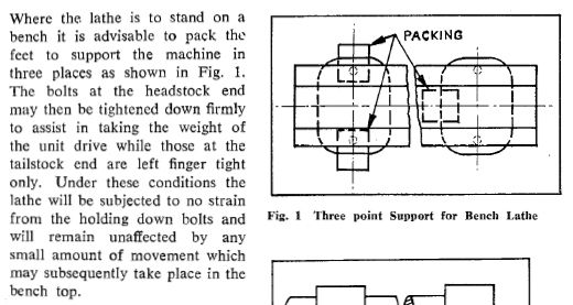

                                        I have an early model Southbend lathe and this is the original instruction for mounting it on a bench.
                                        A 3-point mounting system seems like a good idea, unless you can guarantee the accuracy of the lathe set-up. Bolting it down at 4 points will twist the lathe if it not completely level.
