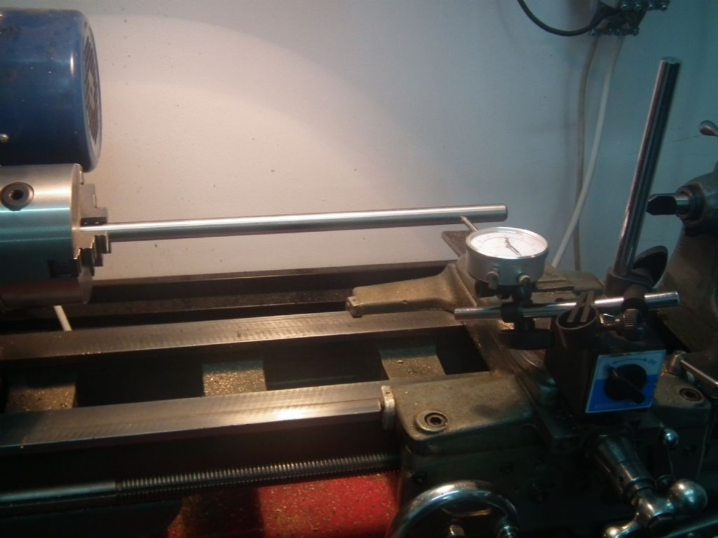

          After reading this I thought it is about time I checked my 60 year old Atlas clone for level (twist) having set it up in its present position about five years ago.
          I put a length of 9/16 silver steel in the three jaw and a dial gauge set to centre height on the cross slide to measure in the horizontal direction. Next to the chuck there was 1 thou variation as I turned the chuck and I set the zero in the middle of that range. I then moved the saddle to bring the dial gauge to ten inches from the chuck and again rotated. This time there was 2.5 thou variation and the middle reading was only 1/2 thou off zero! I was expecting at least a couple of thou to need adjusting out.
          The above method of checking for twist has, for some reason, become known as Rollie's Dad's method but I have used it for years – it just seems to be an obvious method. Using a level with 10" sensitivity would give about the same sensitivity but as most people have a dial gauge why bother?
          Agreed, the Atlas won't take heavy cuts like a Colchester but it can certainly give accurate results.
