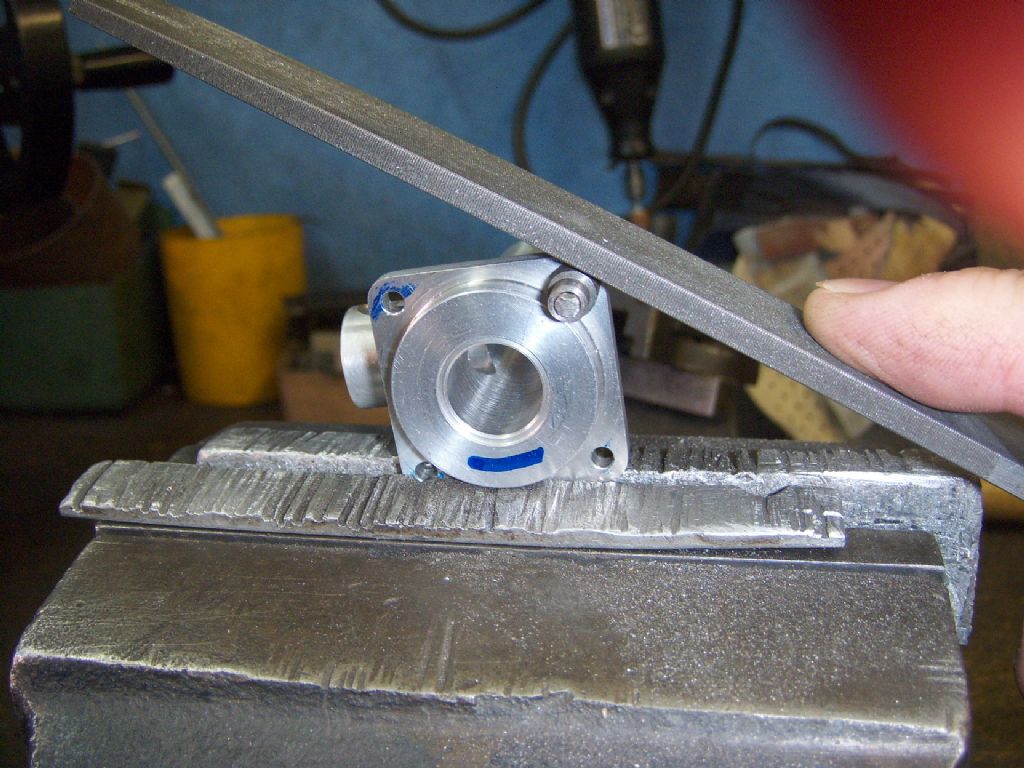

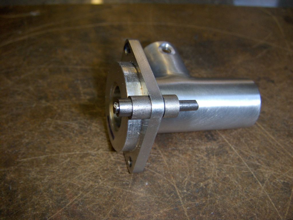

                #187149
                  Filing buttons are just a couple of slices parted off a rod of teh same dia as the outside of your rod end and drilled to the same size as the hole, some people harden them I just use mild steel as it is.
                  You then slip a pin through your rod hole, a disc either side and file away, when teh file hit sthe discs they act as rollers and stop the file cutting any deeper.

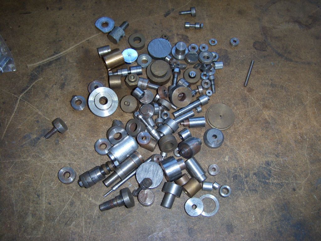

                  It may seem a pain making them but keep them and you will save having to make them the next time, you will soon get a good collection

                      I have used some old bearings from HDD recently as filing buttons. These worked great as there are hardened and they roll.
