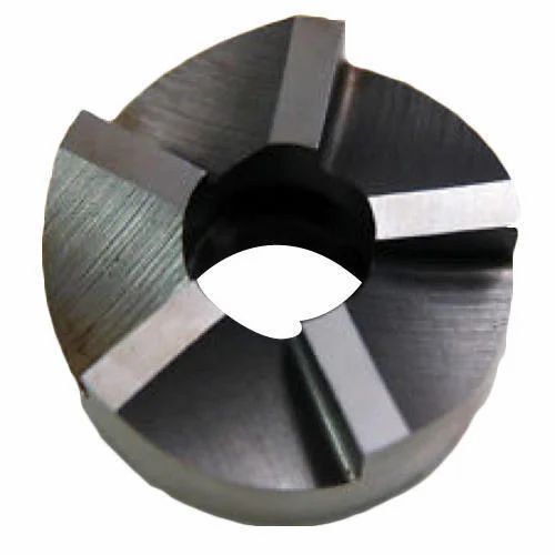

                                              blowlamp
                                                @blowlamp
                                                Ok, if it's brass then forget the aluminium washers.
                                                Maybe a Spotface cutter would do the job.
