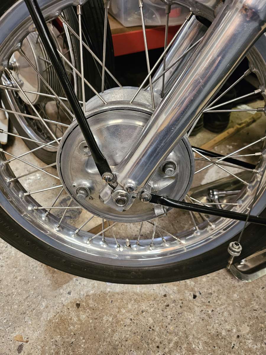

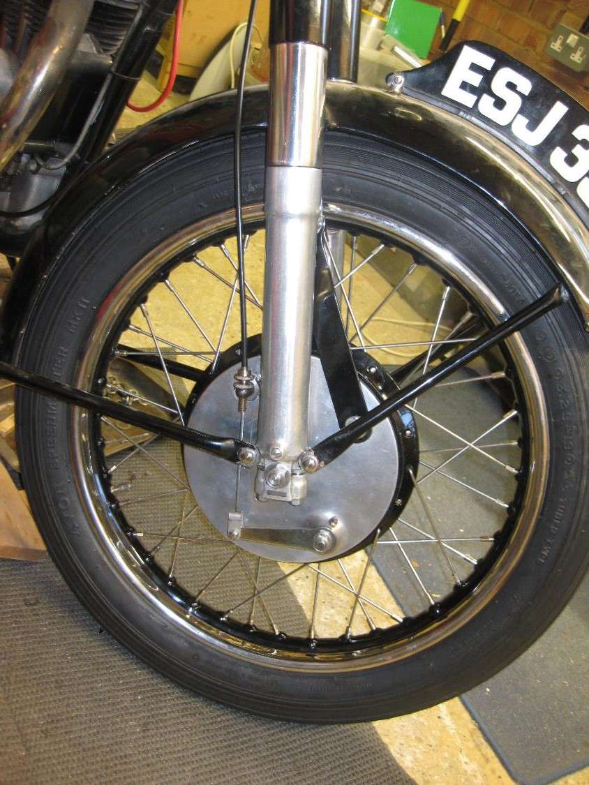

              Hi All, thanks for your comments.  Michael, your picture shows a Honda brake very similar to that which I am using, but I am only using the backplate, modified to fit the AJS drum (see pic). I have a genuine New Old Stock (NOS) bolt in its original packing and it has no markings.  The general body of the kirk say to stick to the original part, and Neil, you are right about the rolled threads.  Mr Honda in his wisdom nas reamed out the first 5mm of the thread in the hole and left the top part of the bot unthreaded, so bolt when tightened bears the shear strain on the whole diameter of the bolt, not on the threaded part as it emerges from the alloy – he must have thought long and hard about this so I will stick to his part, and put up with the mild inconvenience of its location.  The only thing about the bolt that is not as good as the AJS equivalent is that it is screwed direct in the alloy – AMC nearly always used studs for fixing in alloy, or a steel bush – they planned on the parts being taken apart and reassembled for many years so they made it much less likely that the threads would get damaged.  The Honda torque arm looks rather thin – AMC used 3/16 metal in this role; BSA went to even thicker.20240208_203323JJust for interest, I have fitted a BSA 8 inch brake in my Matchless using a new axle made from EN16 to a drawing originally made in Meriden, presumably by someone in his lunchtime for a mate as I don’t hink Triumph ever planned to do this commercially – the AMC brake is a rather puny 7 ins x 7/8 wide, wheas the BSA one is 8 ins x 1 3/8 ins, hence the swap.Picture2

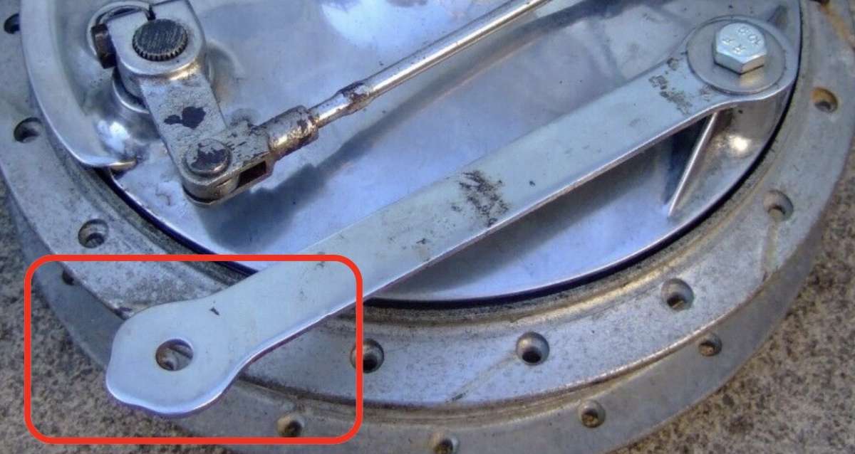

                      My personal interest now turns to this little detail:
                      Crop from my previously posted image:
                      source Right
                      I don’t have the wherewithal to demonstrate it at present … but I suspect that the stress-lines in that area were quite cleverly engineered.

                        1. Hi Duncan, I am replacing the AJS backplate, with its 3/8 BSC bolt, in its entirety with the Honda item with its 8mm bolt, so there is no overlap.
                        2. Hi Michael, I do not have the Honda torque arm, but the pictures I have seen for this brake show a simple parallel strap with a single hole at each end. The fastening to the AMC fork is by 2 x 5/16 studs, BSF at one end to screw into the alloy fork slider, BSC at the other to take the fastening nut. I will be making a new torque arm. Interestingly AMC had a simple hole at the brake end of their torque arm, which they swelled out to a teardrop shape in later years after a couple of incidents of the bolt tearing through under heavy braking – this same brake was used for high performance 650s as well as the ‘cooking’ singles that I have got.

                          P.S. __ thanks for the info about the ‘teardrop’ shape … it both supports my hypothesis, and suggests that Mr Honda was a good observer !

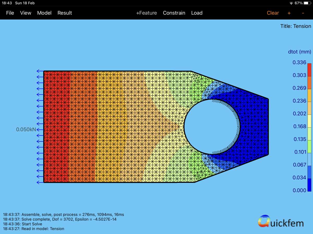

                            Resurrecting this for a brief hi-jack
                            I have made my first lumbering steps with the Finite Elephants today !
                            NASTRAN it is not … but QuickFEM runs on iOS [and I believe there is also an Android version]
                            The interface is a bit clunky, presumably because the developer put his effort into making the thing work. … and work it does.
                            It’s essentially 2D, but you can adjust the thickness of the whole model.
                            IMG_9363
                            #715164
                            duncan webster 1
                              @duncanwebster1
                              Im assuming that is a deflection plot, does it do stresses?
                              #715169
                                Yes … it does much more than I currently comprehend.
                                If you’re struggling to find it  …
                                https://quickfem.com/
