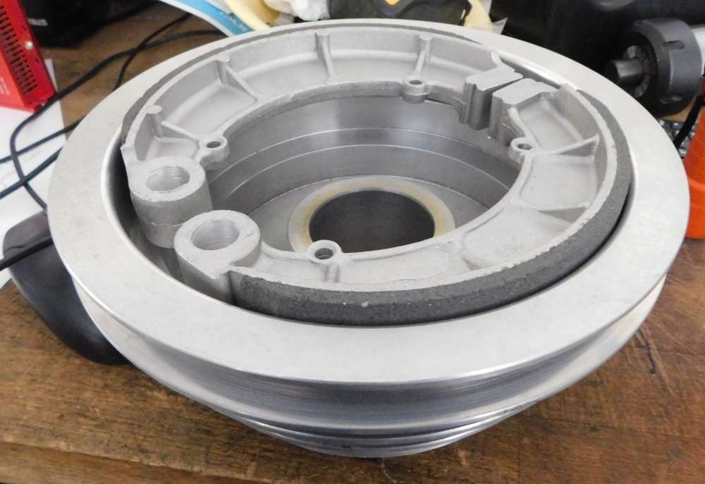

                                I was thinking about fitting inscrutable Honda 500 180mm brake shoes to my Warco round column mill as a spindle brake.
                                Truly universal 😀
                                best
                                Robin
                                mill2

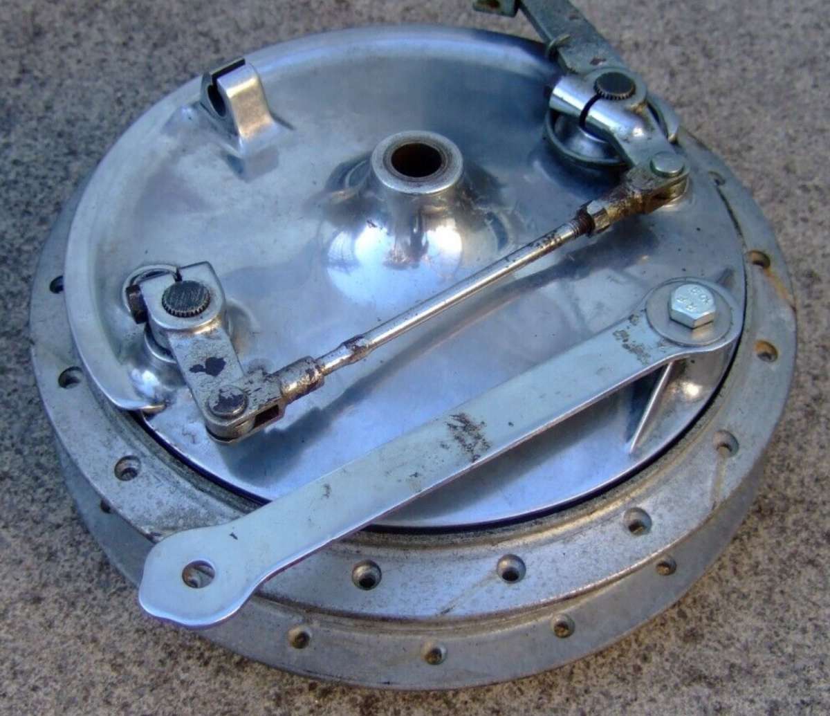

                                              This may only be generally  representative of Honda’s engineering style … but at least it’s a decent image of the right-sort-of thing:
                                              source Right
                                              Borrowed from ebay: https://www.ebay.co.uk/itm/166368629508
                                              I note that the head of the bolt is marked … but is it original ?
                                              More questions than answers !
