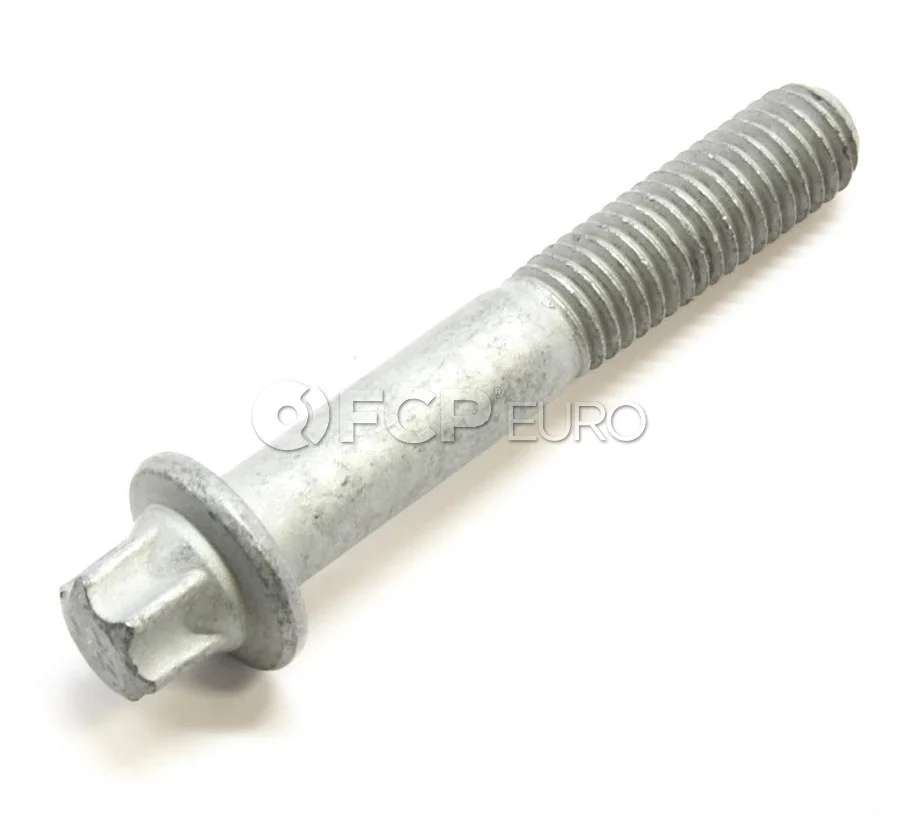

            No idea, Tim … but I do know that one of the fancy bolts failed by shearing the driving head from the integral flange !
            [ sorry, I probably don’t have the correct terminology there ]
            source Right
                      source Right
                      The problem is that sometimes mechanics use impact wrenches if an air ratchet isn’t man enough. I nearly bought a little 3/8” impact wrench when I was a mechanic.
                                  source Right
                                  Just re-read this posting and it has left me amazed.
                                  If that is the same type of bolt as the one that failed then (whilst I’m not a metallurgist) I would be interested to know what scenario could separate the male Torx protrusion from its flange, or was it that the Torx just got complete chewed or rounded off?
                                  There is an art or skill required to undo seized fasteners which one would like to think garage mechanics have learned by experience. I think power driven spannering has removed any ‘feel’ from the task with the result that Michael has experienced.

                                    I didn’t get the chance to discuss it in detail, Ian
                                    [ the poor bloke was about to start a potentially difficult day’s work ]
                                    I might get the opportunity to gather more facts [and maybe some evidence] when I eventually pick-up the car.

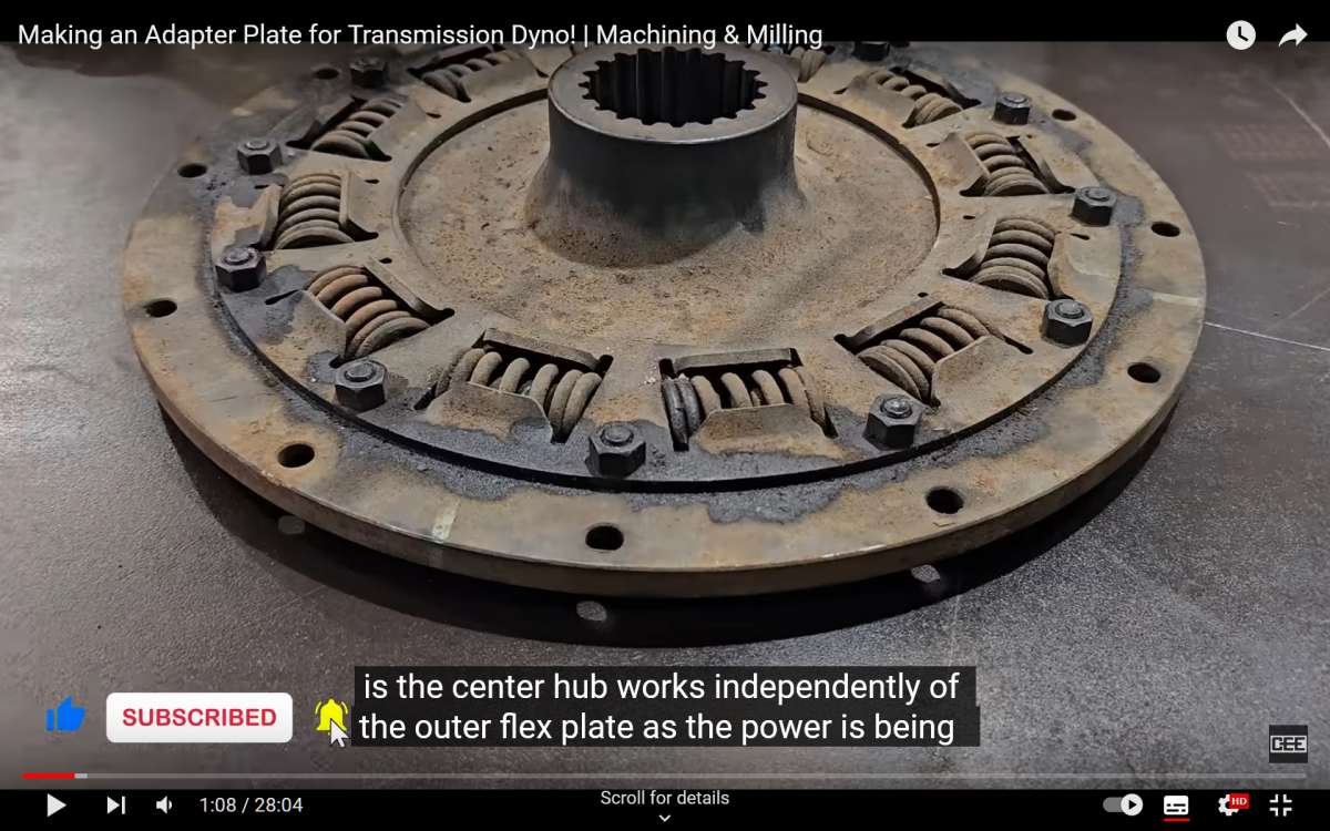

                                      On a slightly related subject Kurtis repurposes a well used ‘flex plate’ into something shiny and new….
                                      Making an Adapter Plate for Transmission Dyno – https://www.youtube.com/watch?v=SGoVgQ5Cx2o
                                      flex plate
                                      The springs are well past their use-by date.
                                      Ches

                                          Unfortunately: The mechanic couldn’t find the remains of the bolt that the driving head snapped-off, but I do have one that simply sheared in the stress-raising area where plain shank meets thread. … I may photograph that surface tomorrow.
                                          He has assured me that no power-driver of any description was used … just the trusty socket set with long extension. [there is not room for anything bulky]
                                                Nice video, Ches … and a very sensible ‘Make-From’
                                                ’though I was surprised to see him just pop it in the 3-Jaw rather than using a 4-jaw and clocking it on the splines.
                                                I salvaged my old ‘Dual Mass’ from the garage and will be contemplating whether it can become something else, in due course.

                                                    #713454
                                                    Ches Green UK
                                                      @chesgreenuk
                                                      Michael,
                                                      Kurtis seems to be a well trained and capable chap. I’m sure he could figure out a way to adequately ‘clock the splines’, but time is money to him 😉
                                                      Ches
