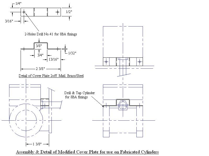

      cylinder cover modification.jpgTo builders of Emma Victoria, in M.E. 4451 page 388, I have shown a cover for use on fabricated cylinders when the cylinder bore to frame is 1 3/8" without a spacer. I have changed the design and made it simpler which will suit either option of fabricate cylinder i.e. with or without a spacer plate. Attached is a copy of the assembly & detail for the new cover.
      Henry
