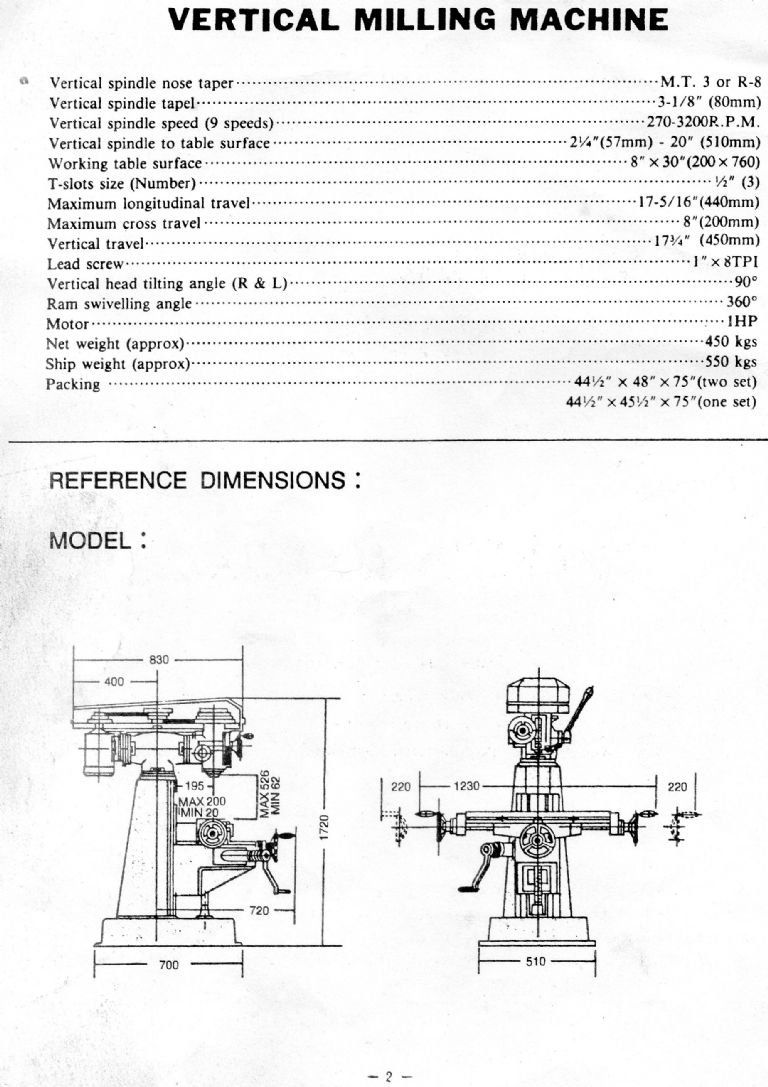

          Warco A2F milling machine from the handbook.
          Just noticed  that there are 2 versions of this machine in the hand book  this one is not the A2F,   the A2F
          wll be in the next posting.

            Wow thankyou very much all the info I require, do you have any experience with these mills ?

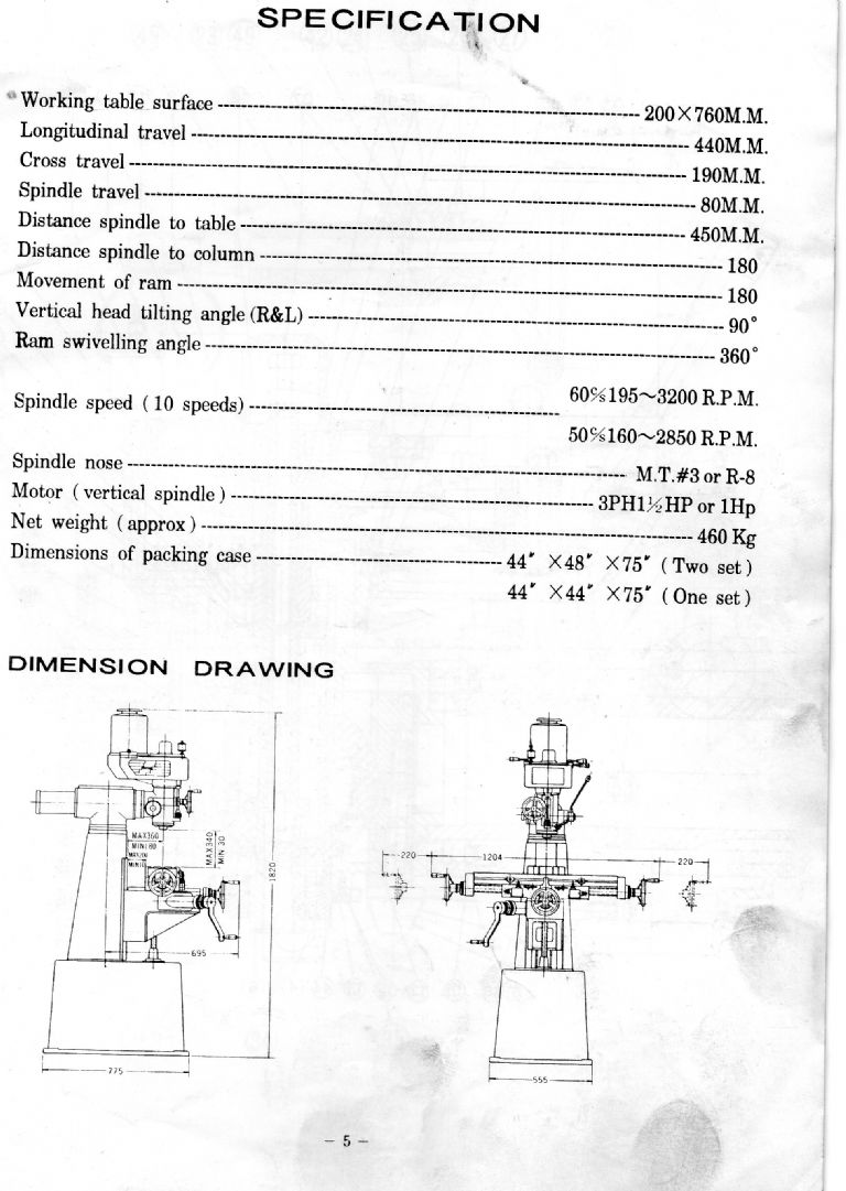

              Had this machine  since 1998  been modified quite a bit has a raising block fitted to the head  now has 24  inches spindle to table height   and a 2 part  vertical knee  screw  so can have   zero inch from   spindle to table ,machine is  part cnc  ,table   long travel  to about     550 mm . Fitted with inverter   as supplied  from new  spindle speed up to 4500 rpm.
              There are some more photo's of this machine in the album.

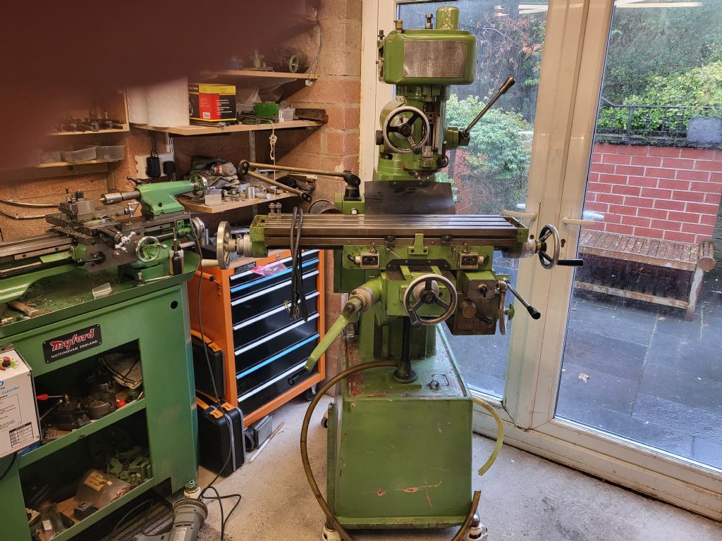

                              Well my new to me mill arrived on Thursday all packaged up exactly how it left the vendor so that was a huge relief. It did however change identitys during the journey as it set off as an EME Mentor mill but when it arrived it had transformed into a Warco A2F mill LOL!!!! First job was to strip it down in to manageable chunks to move it in to my workshop. I had bought an engine hoist for this job so it was relatively straight forward. It is now re assembled in the workshop. Next job is a chat to Newton Tesla to fit a inverter package, unfortunately I'm going to have to change the motor as well as it is not dual voltage. I am also going to repaint the base as it is scuffed in places so the paint has been ordered and is on the way from Paragon Paints. Anyway here it is in its current glory 20221004_150630.jpg

                                Hi, does anyone have the user manual to the A2F Milling Machine similar to the picture in John's post with the automatic feed gearbox to the right of the table?
