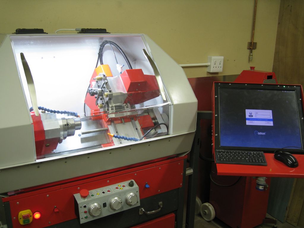

                                      Michael:
                                      C axis is the lathe's main spindle, with the ability to be positioned to accurate specific angles, ie, not just a rotary spindle, but a servo position controlled spindle as well.
                                      Live tooling is for example a milling head radial or tangential to the workpiece in the lathe spindle. You could mill flats on a shaft, keyways in the shaft, a hex on the shaft end, or hexagonal holes in the end, etc. The lathe I made has a servo spindle and an auto-tool changer with 8 tools, and a central milling spindle, able to mill only in line with the lathe spindle – Hex on the end of the shaft type work
                                      Don't wish to hijack this thread more than it has been, so if interested, take a look at these posts…
                                      Joe's CNC lathe
