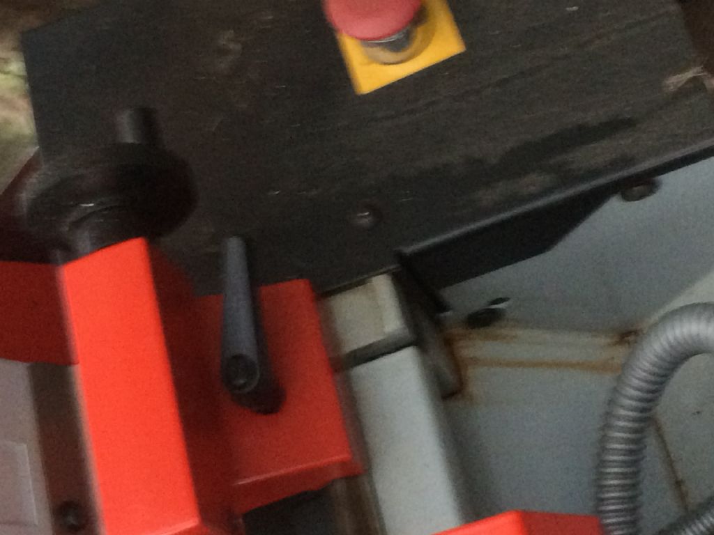

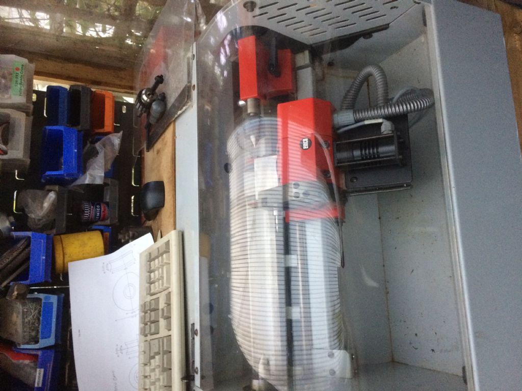

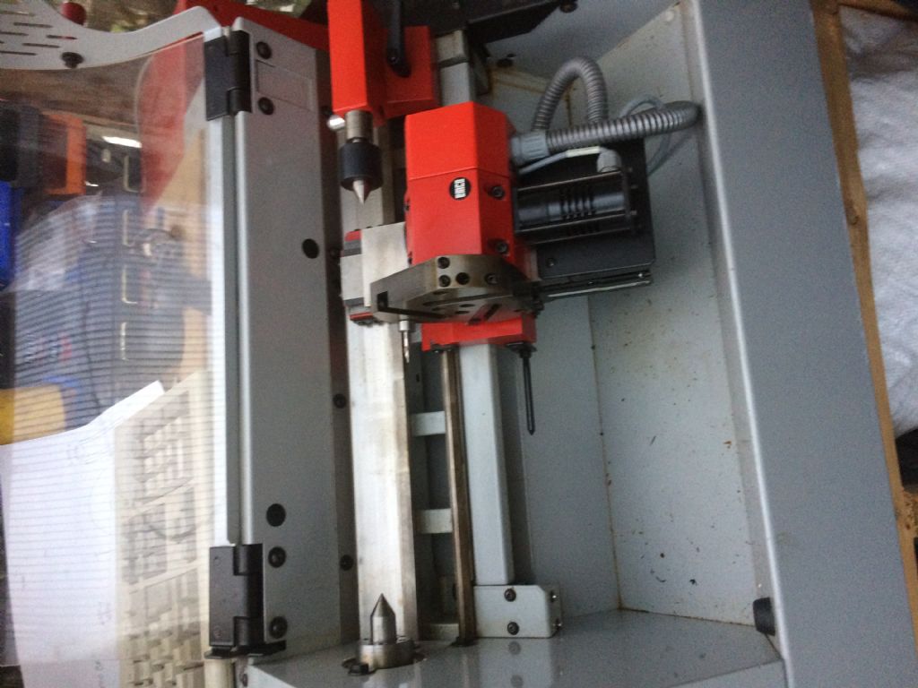

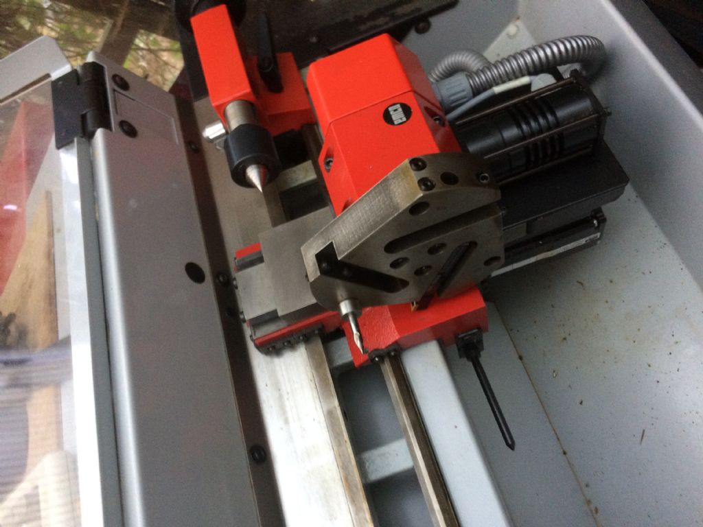

              #394526
              geoff adams
                @geoffadams14047

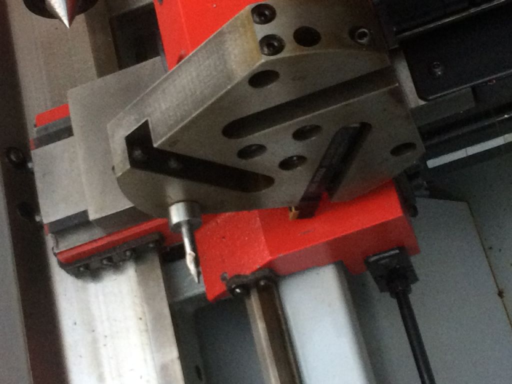

                John some photos of the machine had it for about ayear never used it the cad cam is a nightmare get fed up and use my other machine the fellow i got form got it as an ex demo dont thick it has ever cut anything want to kep as much of the machine as possible as it all looks as new
                Geoff

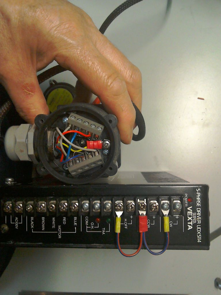

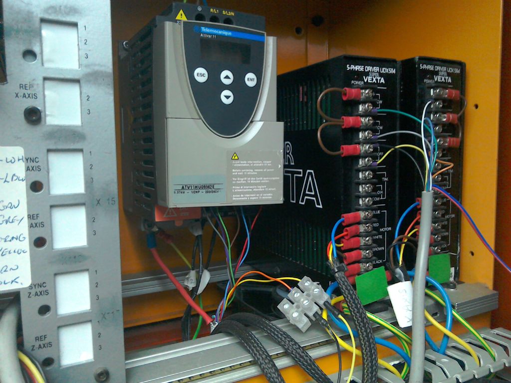

                  #398289
                  The Novice Engineer
                    @thenoviceengineer

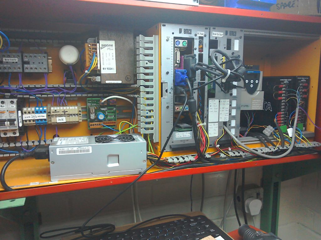

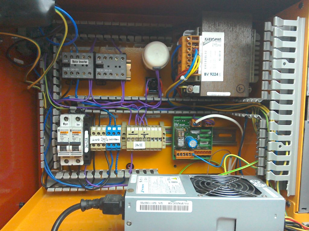

                    Here are some photos of my Emco PC Turn 50 cabinet with the rewired power side , the Rack mounted PC and 5 axis controller, the Drive motor VFD and the Vertex 5 Phase stepper drivers.
                    I had been using this as test bed for trying out ideas before modifying a Emco PC 50 Mill, The lathe retains the original  Emco 5 phase stepper drive motors and the 3 phase main drive.
                    img_20190225_124846.jpgThe transformer was retained to provide 24v for the tool changer. The Vertex drives are 110v and are run form tapping on the primary side of the transformer.
                    The Power supply at the front is for powering the PC [a Mini ITX dual core running XP off an SSD ..very quick] it also powers the Mach 3 control card, and recently the Tachometer RPM meter
                    The terminal block is a power take off for testing the RPM Tachometer of the Main drive.
                    Steve
                    Edited By The Novice Engineer on 28/02/2019 22:13:56
                    Edited By The Novice Engineer on 28/02/2019 22:18:50
                    #398376
                    The Novice Engineer
                      @thenoviceengineer
                      Update:
                      A bit of a senior moment dyslexia with the spelling of the drives I used!
                      The 5 phase drivers are by VEXTA , to use these the Emco Berger-Lahr stepper motors have to be re-wired internally about a 5 minute job changing links around. The Vexta pentagon drivers have five output terminals; each one connects to two motor cable conductors
                      I've added the information about how I did my modification to this thread as the title may draw folk in who are looking to do a modification.
                      Steve
                      Edited By The Novice Engineer on 01/03/2019 21:00:18

                                          The Tool change motor is 24v DC,
                                          The small control board for it will apply 12v to reverse the motor to locate the toolholder in position against a pawl/ratchet,
                                          The 12v is maintained continuously to hold the tool in position. The motor housing has a large heat sink it does get warm but not hot.
