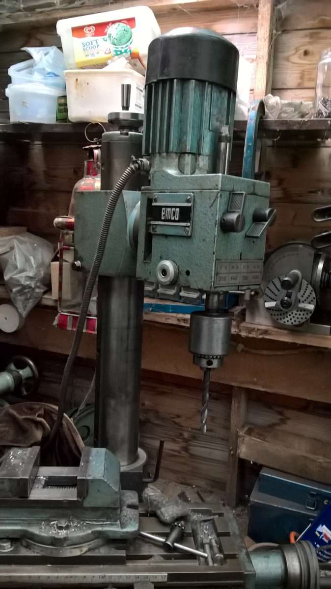

      I have an Emco mentor mill to which I fitted a VFD about 10 years ago and its proved totally trouble free. I run the motor at frequencies between 4 and 120Hz and it has never even got above very slightly warm to the hand.
      The mill came without the motor rating plate and was wired as single phase. It seems to have three identical windings (Ohms test). I have since learned that Emco used 3 phase motors as standard and for single phase customers operated them in steinmetz configuration.
      I am now beginning to wonder what voltage (in 3 phase) the motor is supposed to be operated on. It has never produced a lot of power (but always enough for my use) but the fact that it does not get warm make me wonder whether if it should be on 440V.
      If anyone here has an Emco Mentor Mill I would be grateful if they could post the motor plate info.

          This motor on the Mentor mill which with 4 speed geared head which I think preceded the FB2. I don’t have a wiring diagram but when I got the mill the seller advised me that it would never usually start in the high gear. I am sure I have seen mentioned (on the 100% accurate internet!) that Emco on this model used a 3 phase motor. My confirmation of it being 3 phase is based on the three windings being identical resistance to each other which I think unlikely on a single phase induction motor.
          The motor does not have a terminal box and the windings are just brought out in a 4 core cable, one wire being green/yellow, I cannot easily check their colours now, but from memory  brown, black and grey. If on the offchance the motor was made in star mode the centre pint was not brought out.
          I have googled until I am goggle eyed but have not yet found an image of the motor plate or any confirmation of the motor rating
          The mill is due for some maintenance as it has a stripped gear in the head so I will have a chance to look at the motor wiring.

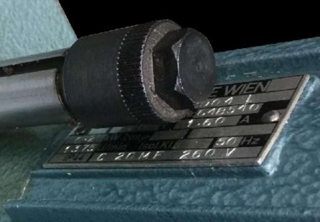

            I have a Mentor mill,I don’t know how many versions there are but mine is an early one. I’ve had a look and there is no plate on the motor as such although there are a few numbers in the actual casting
            Mentorplate
            #741455
            vic newey
              @vicnewey60017
              They obviously were issued with a proper plate which must be missing on mine.plate

                Hard to see all the details on that plate (a good find BTW) but a 200V rating for the capacitor hints at it being a machine for North America running on 110V.

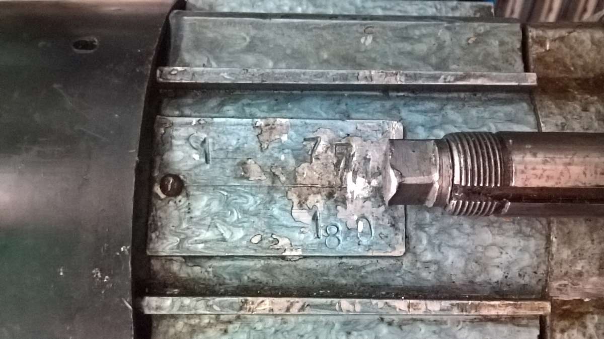

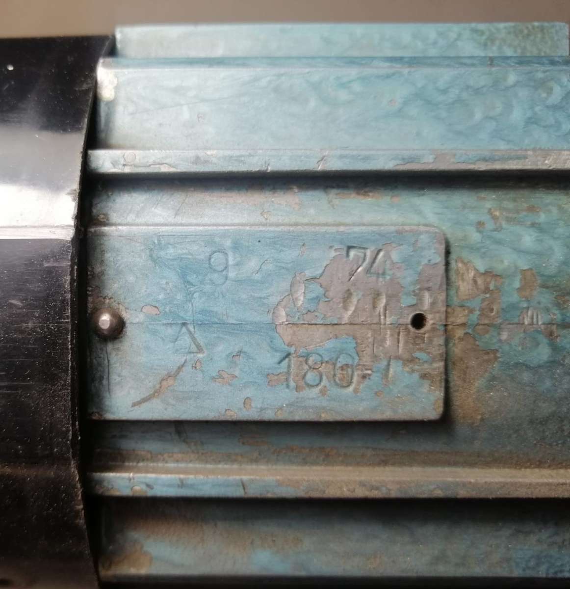

                  Definite similarities between the casting stamps on Vic and my motors.
                  Both have a definite triangle (Delta?), both 180 (Wattage, 1/4HP?), the 1—-74 and the 1—75 could be date codes.Emco Motor
                  Ian P
                  Edit. 9—74 on my motor

                    That motor plate says 20uF 260V not 200V.
                    Likely a capacitor run motor.

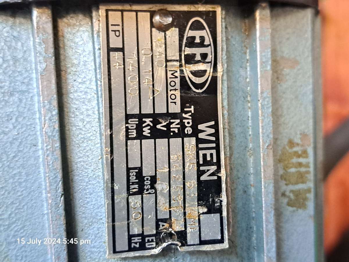

                      John Holmes 11
                        @johnholmes11

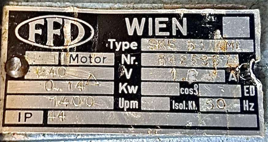

                        Please see the attached photo of the WIEN motor plate on my Emco Mentor which I run directly from UK 220V mains. Hopefully this will answer some of your queries.
                        20240715_174544
                        #741508
                          Two things that might help a little:
                          1. https://www.frank-dvorak.at/en/product-range/technical-information/
                          2. I have taken the liberty of tweaking John’s photo of the plate
                          IMG_9835

                                This is getting interesting. Clearly visible in Michaels picture of John’s motor plate is a triangular symbol.
                                It would appear that not all Mentor mills motor ID plates were the same, as John’s does not show a capacitor value.

                                    John pic seems to show 1/4 Hp 3phase Delta wired and 240v, no mention of a cap. Noel.

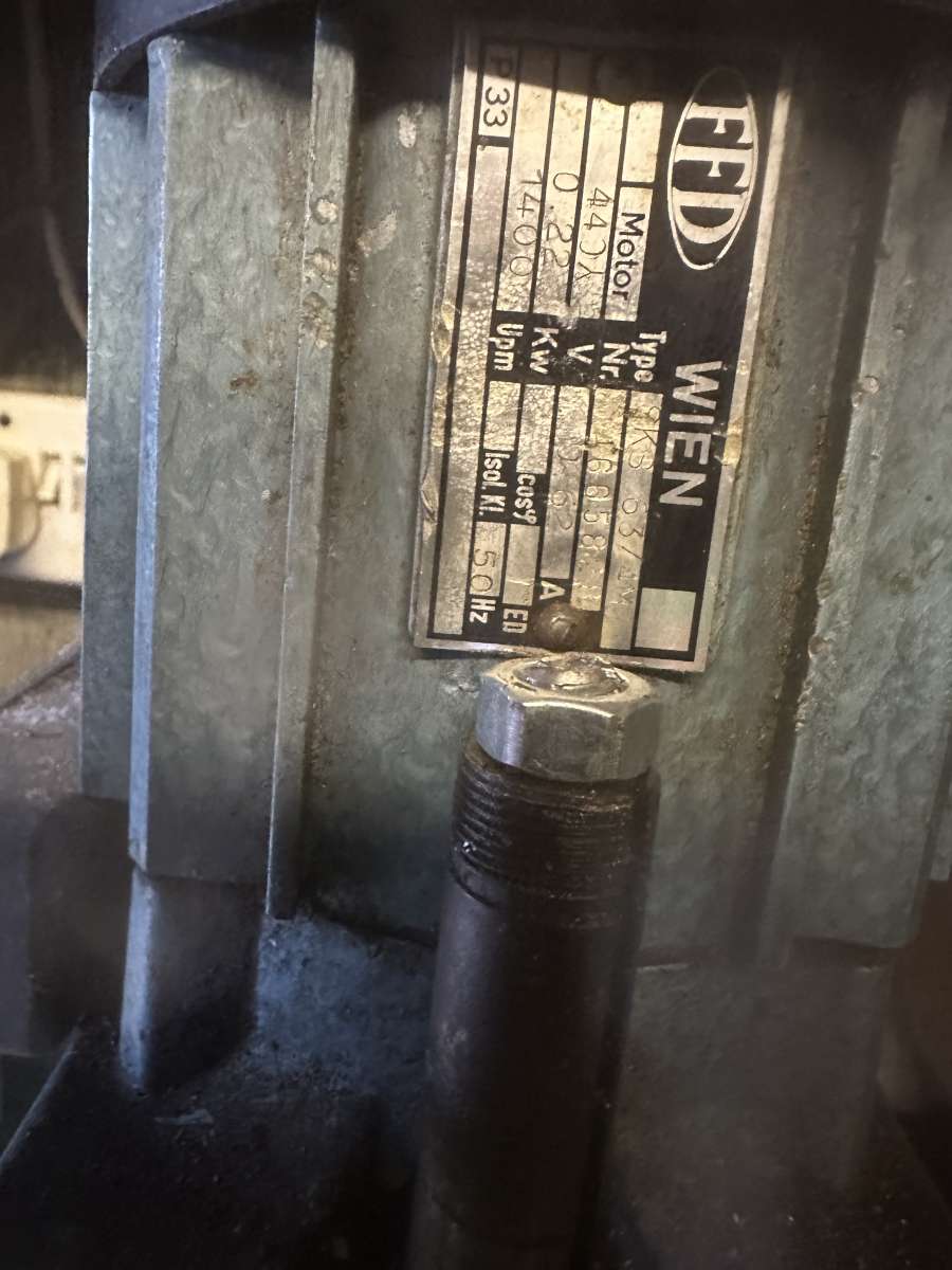

                                          Hi Ian i don’t know if you can read the plate for this one it came of my lathe  milling head.i bought a wrecked 350 mill with the gears missing so took the head of t5he one from the lathe milling attachment and someone on here told me which inverter to get to run it.Some where i have a geuine manual for the lathe/mill if there is an7 information in that that you need i will get it copied.GrahamIMG_3442
                                          #783120
                                          Ian P
                                            @ianp
                                            Graham
                                            Well, that is a 440 Volt star wired, three phase motor and I presume the machine it came off (A ‘350’ mill whatever that is?) was manufactured with control gear for a three phase supply. Interesting also is that it is nearer to 1/3Hp than the usual Emco 1/4Hp
