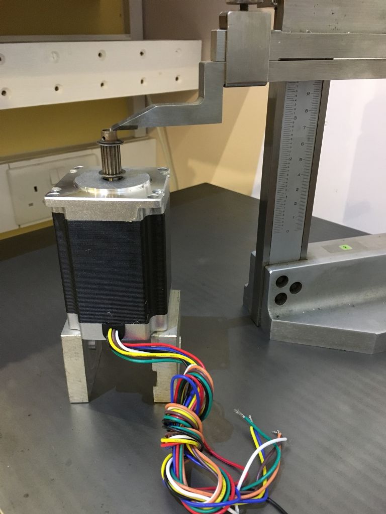

                        I’ve stripped out the old steppers and the new ones are a very similar size.
                        The drive shaft is shorter (21.2 vs. 25.4 mm) so I cannot re-use the roll pins to retain the drive pulleys. A drop of Loctite 641 and fingers crossed: I don’t think that they will come off again if they are not right. To get the location right, I set up the motors on the surface plate and touched the height gauge on their mounting face. The height gauge was lifted 25.4 mm and used as a reference for locating the pulley. The pulley fit is slightly loose, so I used a screwdriver to hold the pulley against the gauge until the Loctite had cured. The first motor was tried on the mill & appears to fit, so the rest have been done, too.

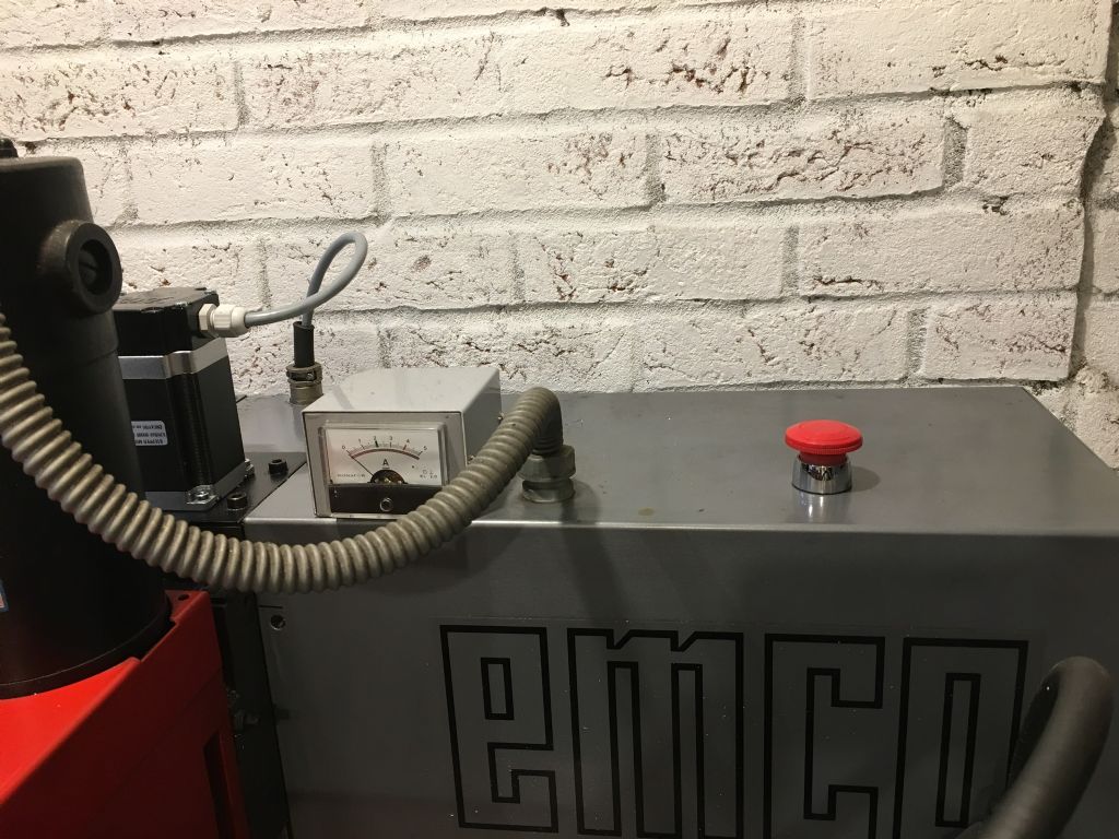

                            First stepper installed. Originally, I wanted motors with a single-ended shaft but I have ended up with double-ended shafts. With hindsight, this has an advantage that I had not expected. After fitting, I turned the motor with a spanner (there is a flat machined on the shaft) the ensure that the bed moves, which it did. However, it felt a bit stiffer than I expected, so I took the motor out again. Turning the motor was a lot easier. Motor re-installed and it is now a lot easier to turn. I suspect that the drive belt was not correctly fitted to the pulley for the first installation. Without the ability to manually check the installation, I would have continued and probably damaged the belt.

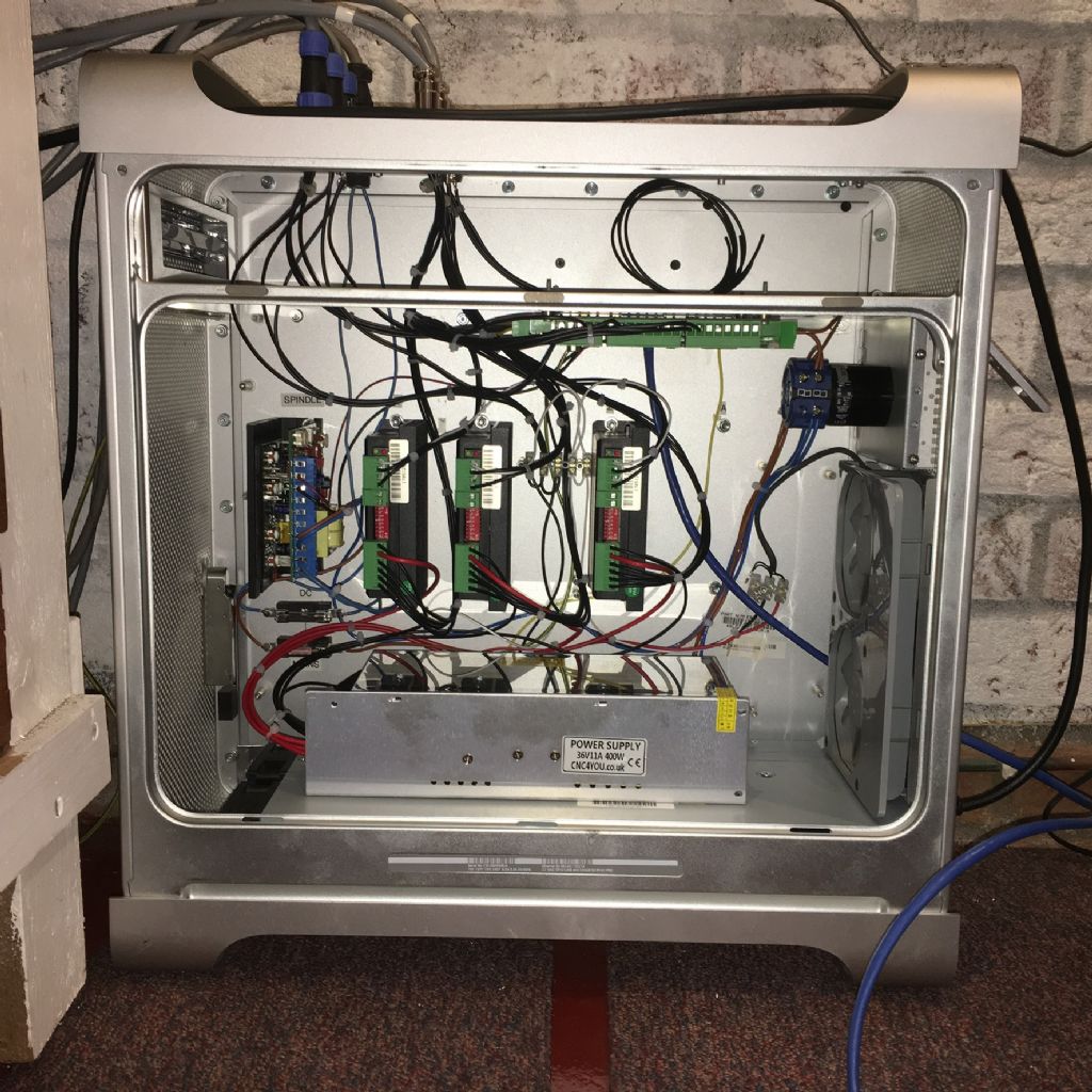

                            I am now trying to squeeze all of the electrical gubbins into an old PC case, so fitting the other two motors will have to wait.

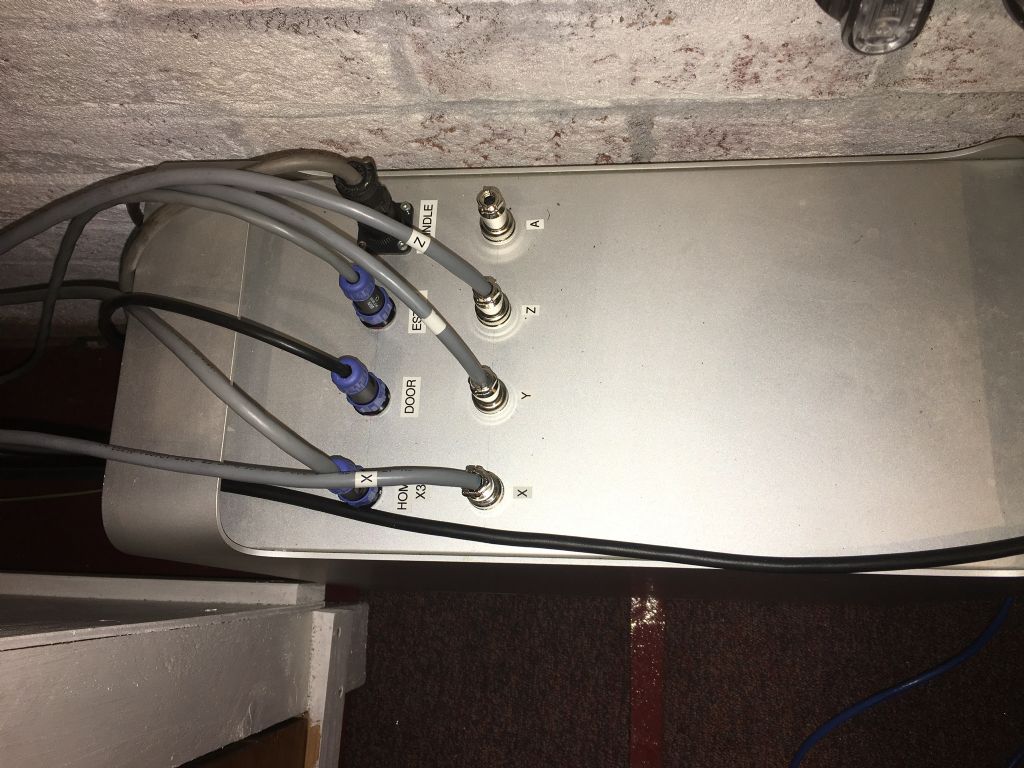

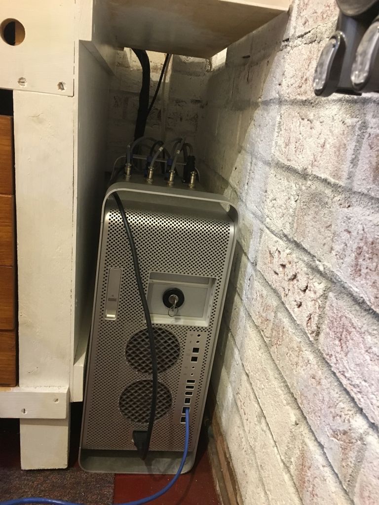

                                This is the new controller, a modified Apple mac G5 with the guts stripped out. The 5, 12 & 24 v PSUs are in the base, the old Apple PSU used to be, with a 36 v PSU on top. From left to right a re the spindle driver (KBIC), drivers for axes X, Y and Z (with room to add A if required). The Acorn controller card is under the top plate. A much neater job than the old PC case would ever have been.
                                The cables to the mill come out the top of the case:
                                And it fits in the same space that the old Dell PC sat:
                                The blue wire is the Ethernet cable to the Windows 10 PC that controls it via Centroid’s software. I have moved the ammeter for the spindle and the e-stop from the old controller to new homes on top of the mill:
