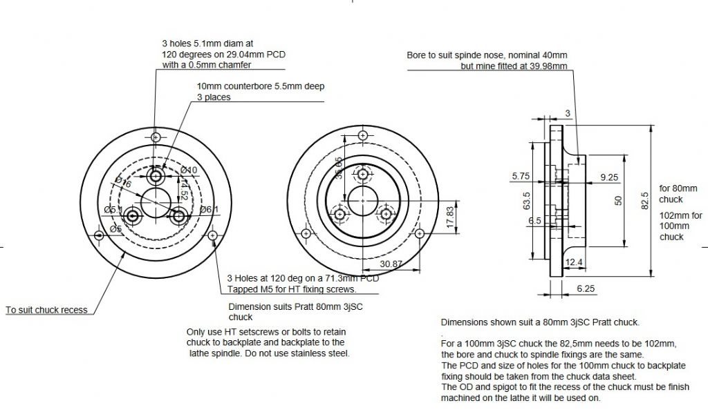

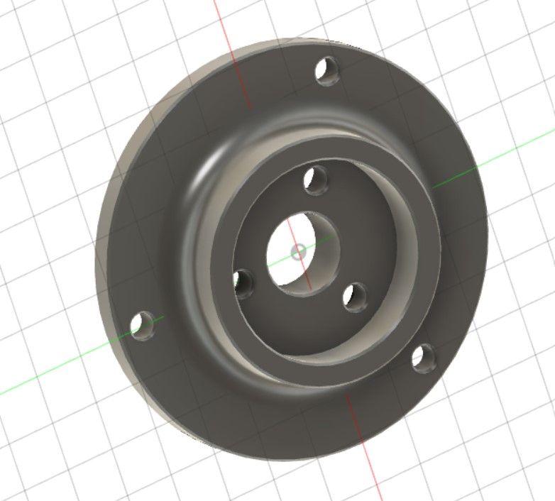

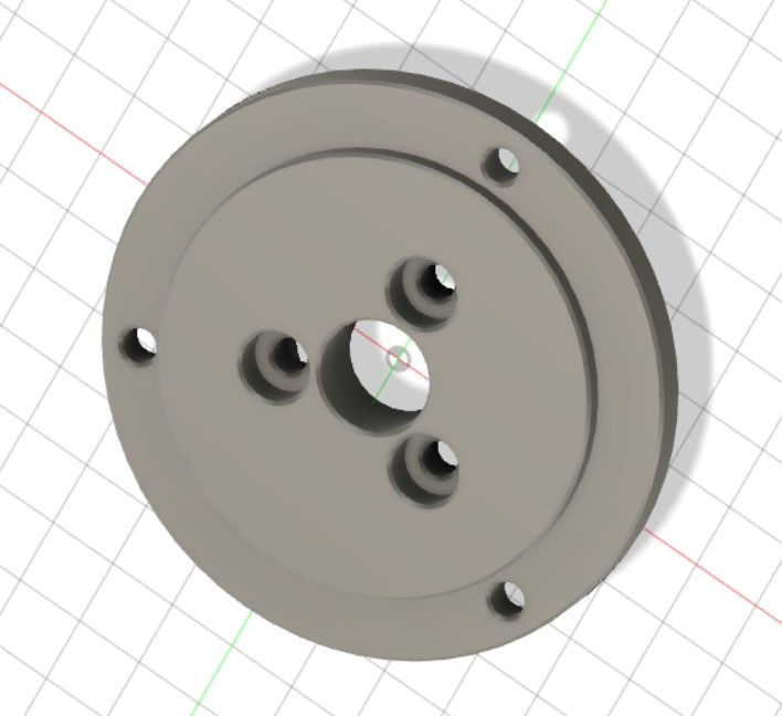

                                      Hi Brett
                                      If you want to go along the route of making your own backplate to mount non Emco chucks you may find useful copy of the drawing I did for that purpose. Material used was cast iron and the chuck was a Pratt front mounting.
                                      You can check the XY co-ordinates for drilling the fixing holes as shown in this video **LINK**
                                      Emgee
                                      #601595
                                      Howard Lewis
                                        @howardlewis46836
                                        Not an EMCO owner, but if you wish to make a backplate for any chuck, within reason, once the embryo backplate is a good fit on the Spindle ( Not much point in proceeding if it isn't ) The face and register can be turned to suit the "new" chuck that you have.
                                        With a well fitting Backplate, turning the OD and the face should ensure that they are respectively concentric with, and square to, the lathe axis, and a snug fit in the female register of the incoming chuck.
                                        Howard
